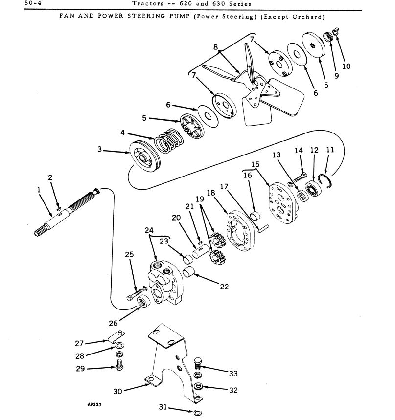

Apr 17, 2014 / 620 Power Steering #1 Y y112 New member Joined Apr 17, 2014 Messages 19 Location Danville PA Tractor 620 John Deere, (1) 318 JD, 425 AWS JD, 4500 JD Has anyone ever heard of the power steering fluid leaking back into crankcase on a 620 (1958) tractor?
Apr 18, 2014 / 620 Power Steering #2 Tx Jim New Member Joined Jan 26, 2007 Messages 10,390 Location Coyote Flats,Tx Tractor JD 4255/Kubota M7040 HDC PS fluid can leak to crankcase by way of faulty seal(parts key #26) on fan shaft. Parts key #26 consists of this. Part Details Part Number: Qty. Description AF2167R 2 Seal R21720 1 Washer Replaces Part: AF1925R Description: Seal Attachments Capture.JPG 84 KB · Views: 170
