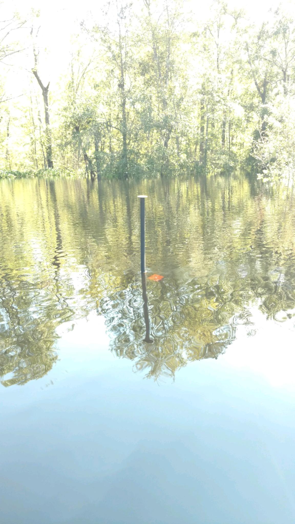

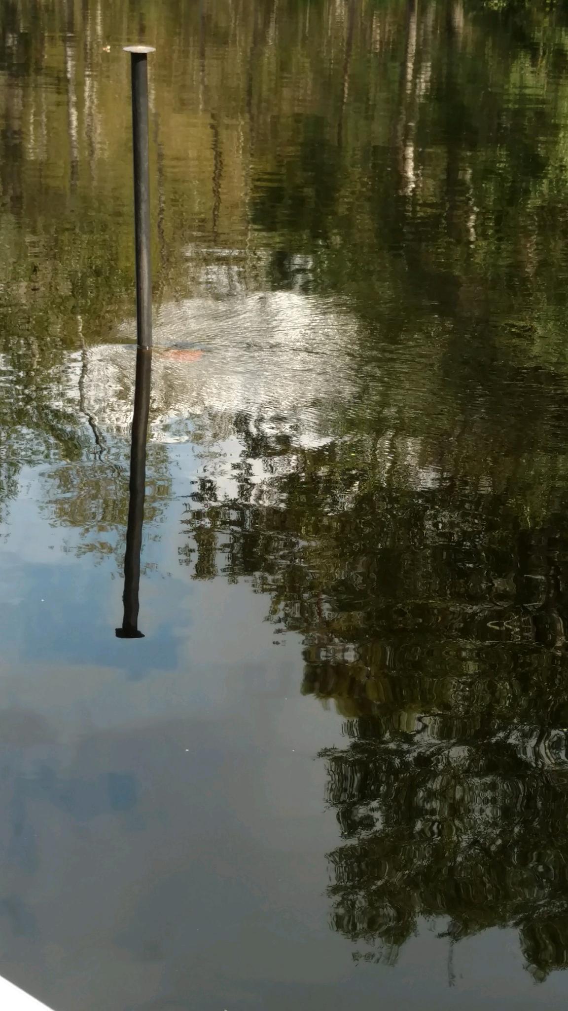

I am loving all this exact great advice. Unfortunately, it will be 3 -4 weeks before the water has dropped enough to actually do it. Today was the first drop of 3 inches. Here are the last 2 pictures before and around the cresting. 8a.jpg Sept 25 3:58 pm,
9a.jpg Sept 26 8:41 PM
