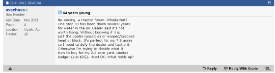

I would definitely go through the trouble of rebuilding it. Those motors are pretty easy to do if you have the right tools and some good shop space. I'd also bet that the cause of the water contamination is the cylinder liner O-rings, with age they get old and can leak. We just rebuilt a '72 International 454 Diesel with similar symptoms a couple years ago. The tractor ran great and motor was in good shape but it started getting water in the oil. Tore it down and the liner O-rings were bad, since we had it torn down we did new liners, pistons, bearings and gaskets along with a new clutch.

As to the previous comment, I figure even if I'm
lucky and it is just something simple like O-rings,
the engine may have sustained bearing damage
from the emulsified coolant. And the overheating
incident couldn't have been good for the rings...
