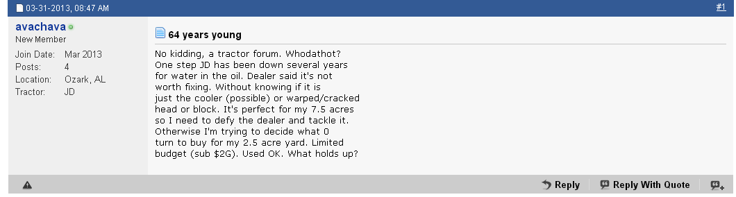

No kidding, a tractor forum. Whodathot?
One step JD has been down several years
for water in the oil. Dealer said it's not
worth fixing. Without knowing if it is
just the cooler (possible) or warped/cracked
head or block. It's perfect for my 7.5 acres
so I need to defy the dealer and tackle it.
Otherwise I'm trying to decide what 0
turn to buy for my 2.5 acre yard. Limited
budget (sub $2G). Used OK. What holds up?
