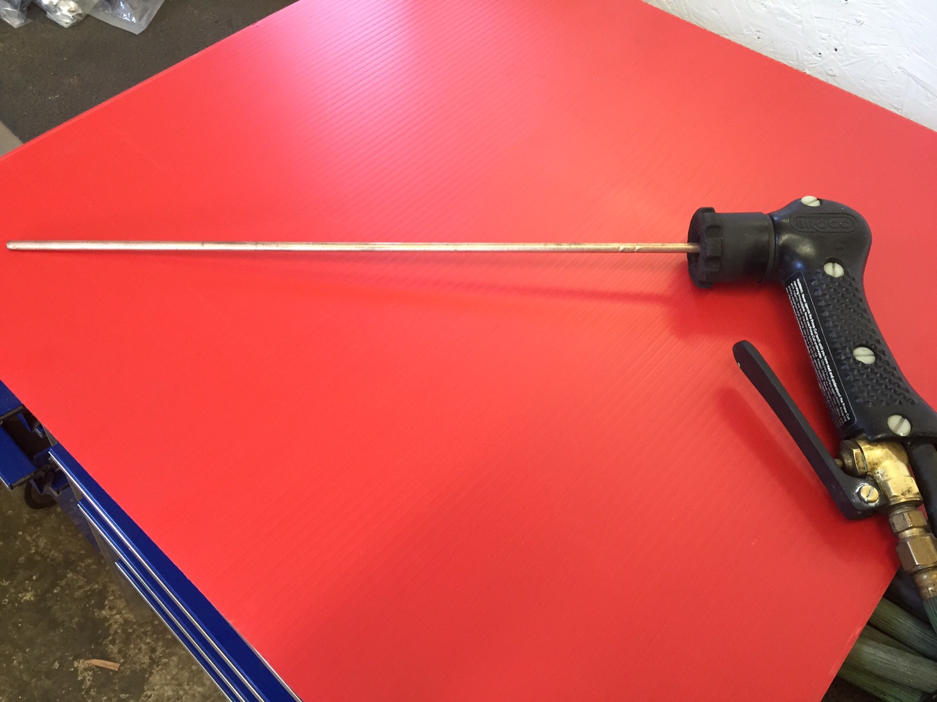

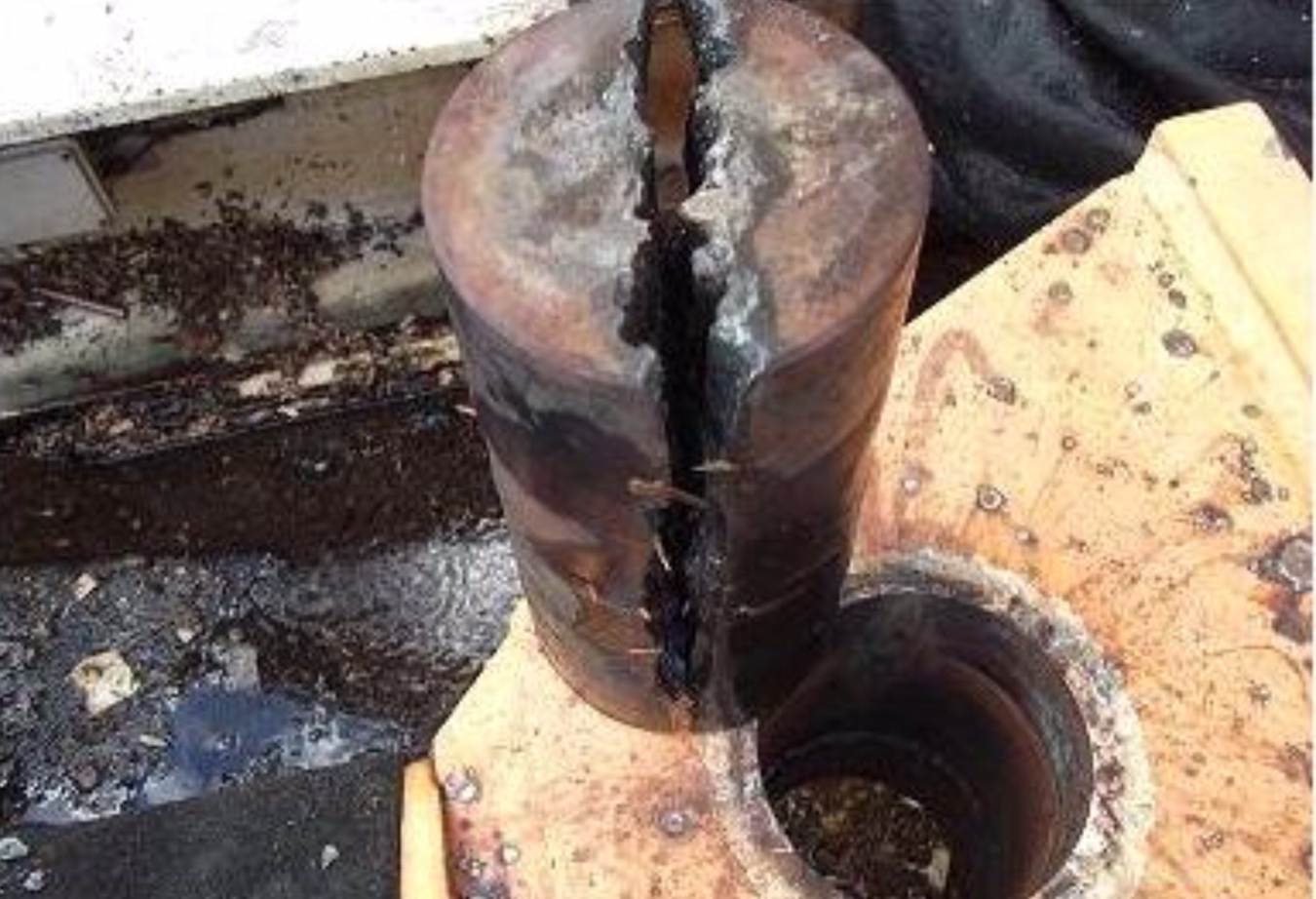

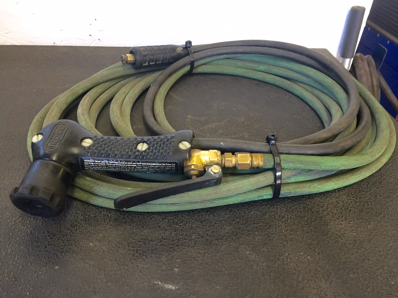

Dale may be right. You may have to cut the pin out. An exothermic lance like mine would do that easily.
   / 6mm grease zerk adapter #16
My backhoe was the same way when I got it, a John Deere 48. Same 1-1/4" pin gaulded in place where the bucket pivots. I cut the plate at the end of the Dipper stick out (the one with the hole for the grease fitting) so I could get heat directly onto the outside of the bushing. I welded a large nut to the end of the pin and threaded longer and longer grade 8 bolts into the nut so I would have something solid to beat on with a big sledge. Took several hours over several days heating and beating but eventually I got it out.
If I knew someone with a thermal lance I'd have gone that route.

exothermic lance
very cool.....I have used tap burners in the past so this is interesting....thanks
