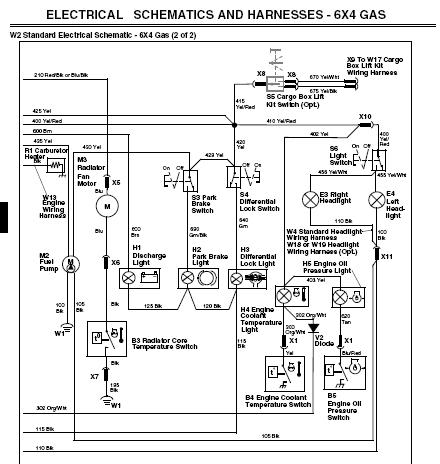

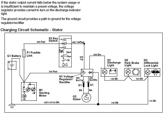

Here are some schematics and how to check the regulator, I found them online. The test they are talking about is a ohm meter.
   / 6x4 Gas Gator Won't Stay Charged??? #20
The schematics show that the machine has a battery discharge light. It should come on when the key is turned to the On position and go out when the engine is running. What does it do?
