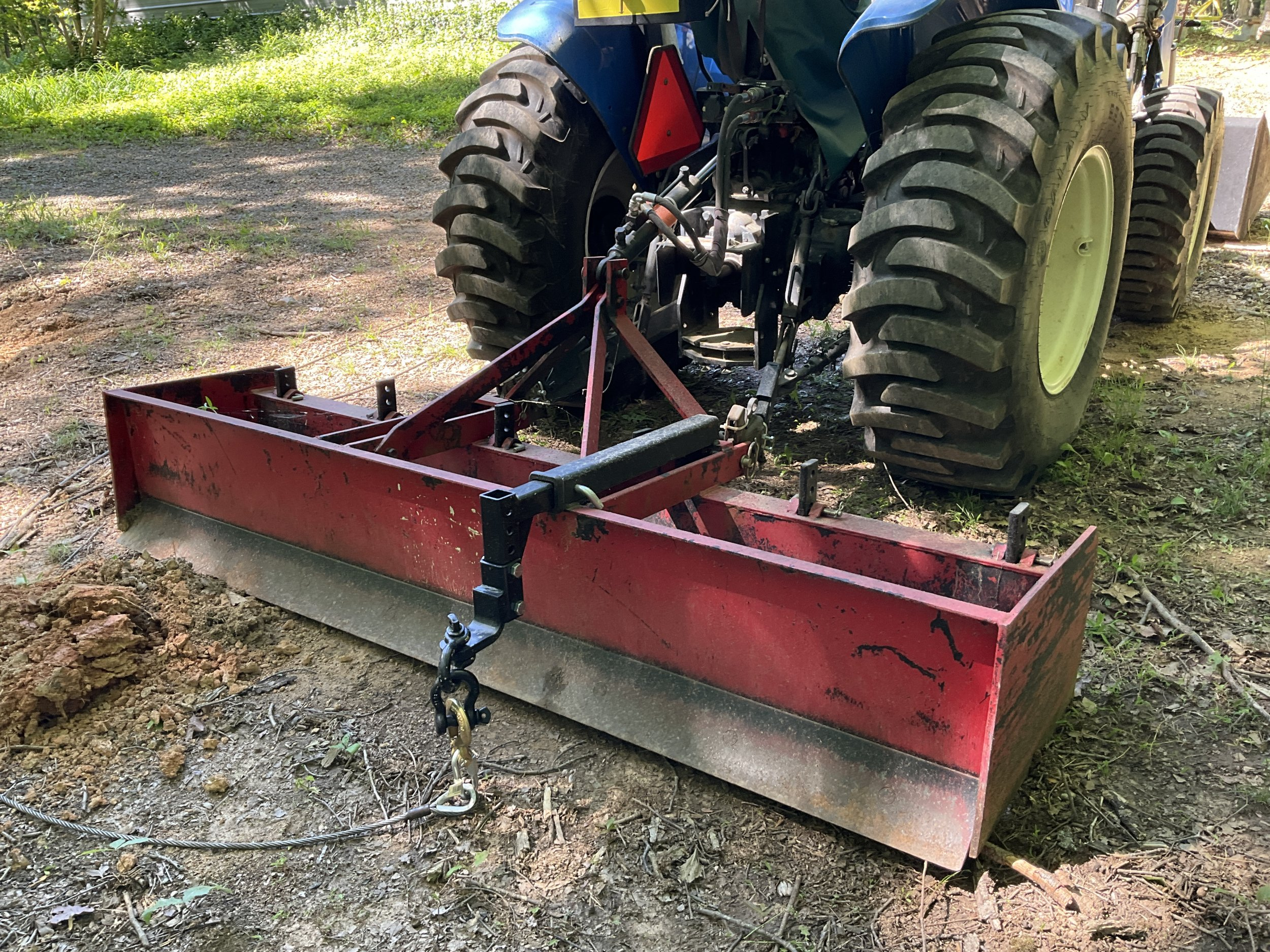

Loader is 6’ for comparison. Thoughts on a 7’ blade on the back of this size of tractor. 🚜
Use a 8 ft. box blade on a 53 hp New Holland Workmaster 50. Handles it well and is a perfect counter weight for loader. 8 ft blade is lighter than box blade and wider than rear tractor wheels so it works great when scraping set at an angle (Still scrapes out tire tracks).
