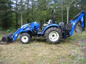

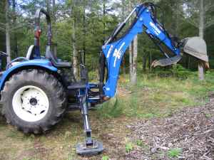

I would go atleast 40 pto hp with SS QA so you can run a 5-6' bucket and maybe even a root grapple. something similar to the one in the pictures. That is a TC40 NewHolland. The backhoe and thumb would be excellent for picking up logs as would the root grapple. Also, check out the John Deere 4x20 series tractors and maybe even the 5000 series. And dont forget the L and M series kubotas. All great machines and they will get the job done. :thumbsup:
Notice the picture of the many toothed grapple monster. Don't leave the dealership without one! If you have a bunch of teenagers at home giving you the rolling eyeball routine... one hour on a tractor with a grapple and you'll be all smiles again.:D I think it must have been designed for Iron Man.
