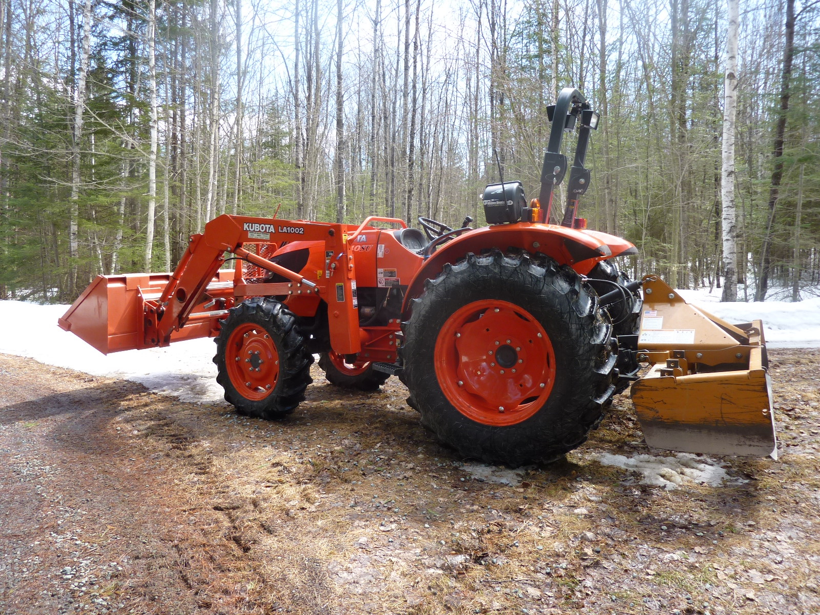

I have a Bush Hog 720 ROBB. Weighs around 730#. If I take too deep a cut - I'll all four wheels digging on my M6040. It's all in the skill of use.
I have a Bush Hog (brand) model RO-600 60" Rollover Box Blade weighing 630 pounds. My tractor weighs 3,700 pounds bare weight with 37 gross/35 net engine horsepower. My soil is Florida sandy loam.
The RO-600 is all the Box Blade my Grand L can manage in HST+ LOW/LOW, full throttle with a full box. I need to engage the differential lock sometimes to initiate a pull with a full box.
Traction is not the problem. Lack of motive power is the issue.
The Lower Links and rigid, pinned stabilizers factory standard on my Grand L are really beefy. I push dirt with the RO-600 quite often. This capability is very handy. (Photo #3)
I have had my RO-600 for seven years.
Box Blades have a fairly long learning curve for the operator.
I use the RO-600 as my primary counterbalance for all but max FEL lifts. I have air inflated rear tires.

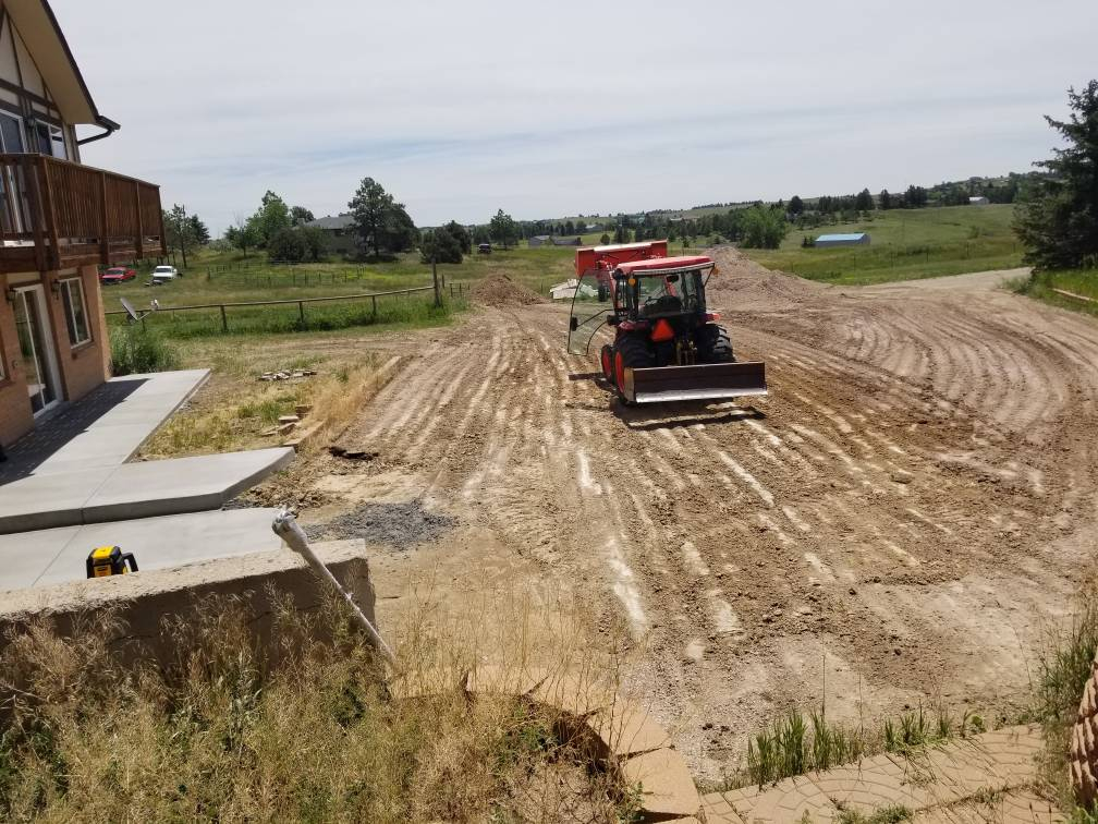

I have a 74" old Gannon for my L4060 & its heavy but works well. I wouldn't want to go any bigger. Even if you had the HP, you won't have the traction. The 5' LPGS will put as much of a burn on the machine as the box blade if it loads up. I'm in Colorado, so down 15-20% on power due to lack of oxygen. R4 tires which have better utility, but not as much raw traction as R1s.
