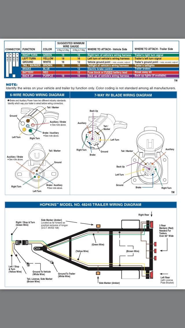

Here is a generic diagram. Unknown if it's what you need:
/ 7 Pin Trailer Plug #7
Boy, I got that wrong. I thought the center was ground! Maybe thinking the Flat RV plug.

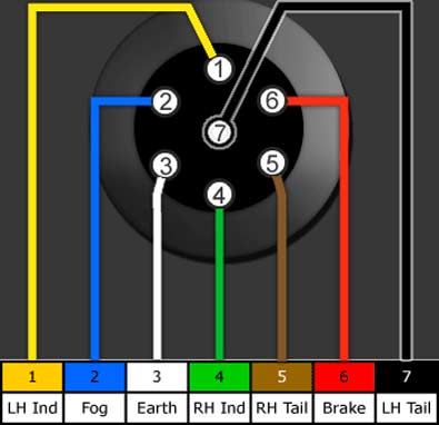

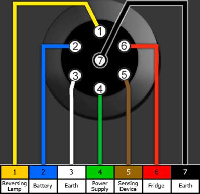

There is two types of 7 pin trailer plugs. they look the same but the pins are different. For running lights, brake, indicators a 7 pin `N` type is used. For auxiliary a 7 pin `S` type is used. The wiring for this is as you look at the `plug`, at pin 4, 6 o clock, is a 12v supply. Number 3 pin, at 7.30, is the common return.

Looking at the posts on here, it seems we do things a bit different to you guys on this side of the pond. For normal `autos` we use the two seven pin plugs or the latest one thirteen pin plug. Heavy `trucks` have a different size plugs.

I think I have found references to at least 4 different ways to wire up a 7 pin plug. None of the ones shown in this thread match what I have on my truck!!??
/ 7 Pin Trailer Plug #16
It can get confusing with diagrams showing the front or the back of the socket, and the front or the back of the plug.
And in some that appear different, the pin function is the same, but the color coding is different.

Here lies one if the big problems with answering your question. There is no universal standard for a 7 pin connector. There are at least 2 standards for these plugs.
Maybe this will help. The 7 way here is the RV standard. No guaranty yours is wired this way however.
