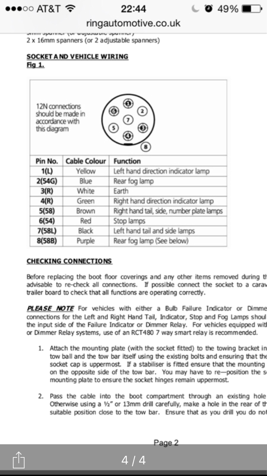

Jan 15, 2017 / 7 Pole Round Trailer Connector #11 I IH782 Silver Member Joined Oct 2, 2015 Messages 196 Location NEPA Tractor Kubota 2650 Kubota B7800, Kubota L3901, Mahindra 2538, Mahindra 2555 I'll go out and look at the wiring tonight, didn't write it down. Their was plenty of slack, you can see the harness below the plug.
Jan 15, 2017 / 7 Pole Round Trailer Connector #12 I IH782 Silver Member Joined Oct 2, 2015 Messages 196 Location NEPA Tractor Kubota 2650 Kubota B7800, Kubota L3901, Mahindra 2538, Mahindra 2555 It's not wired "European". I could not find any schematic on it. I just probed wire by wire.
