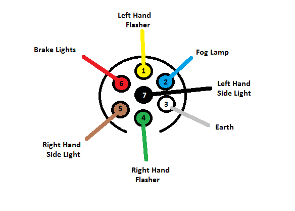

After reviewing the wiring diagram in the operations manual I noticed that there is nothing in the print about the 7 pin trailer connector. Does anyone have a copy of this portion of the diagram?

It is a European 7 pin if that helps?? If you are looking for what the pins are, just google 7 pin.
/ 7 Pole Round Trailer Connector
No, I can check the pins with a test light, I was more looking for a diagram to see where the power (Aux) feed came from, the wire size, and to see if and how it was protected from overload.

I don't have my tractor here to test, but my guess is that the fog pin has 12v all the time.

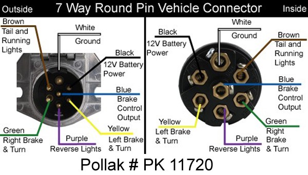

I converted mine to a standard 7-way.
/ 7 Pole Round Trailer Connector #10
Did you happen to write down how you did it? Wire color to pin #? Was there plenty of slack in the wires to take the plug off and mount up the new one?

It's not wired "European". I could not find any schematic on it. I just probed wire by wire.
