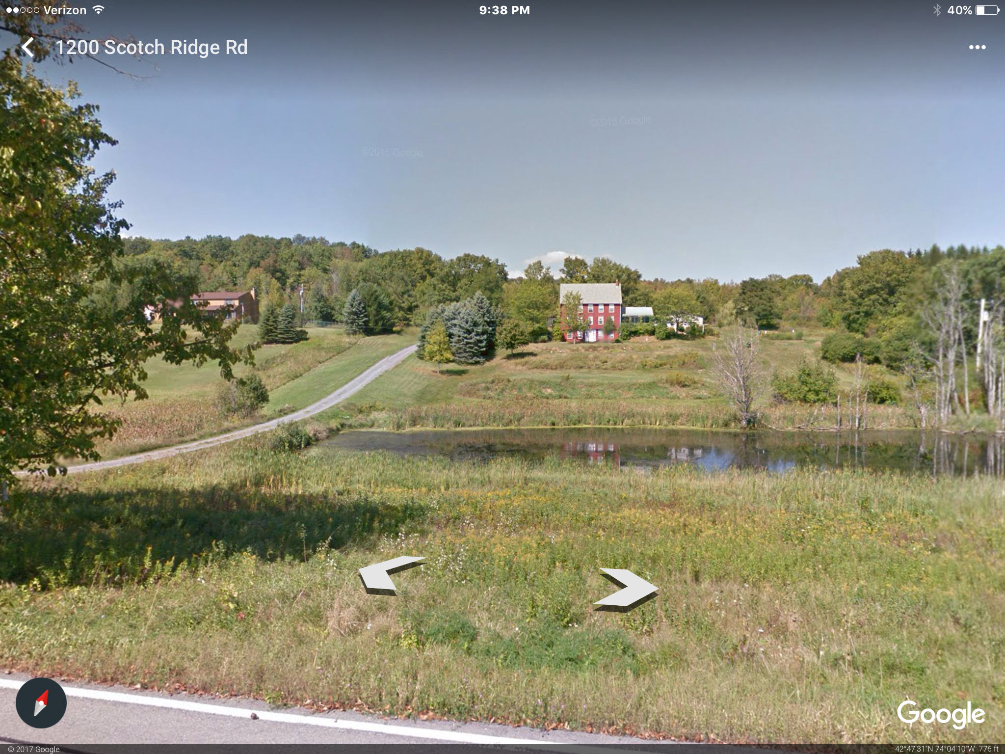

My wife and I just bought our dream house in upstate NY. It has a 600-700 foot gravel driveway and a lot of lawn area to mow. I'm on the fence about what I should do with a budget of 10-12k to spend on snow removal, mowing and general land maintenance. My first instinct is a used sub-compact tractor, maybe a Kubota bx 2200(there's one local for sale with a fel and a 60" belly mower for $8,000. that would leave me enough $$ in my budget for a front mount snowblower and tire chains).
Or should I get a zero turn mower and a plow truck or atv and plow?
I bought a new ariens 28" sho deluxe walk behind snowblower last year that would do the job, but it would take a long time on the new driveway.
I'm leaning towards the tractor idea, but I'd like to hear what some of you think would be best. Here's a picture of the driveway and lawns I need to take care of courtesy of google earth

I think you have it nailed. The BX (or another brand like that) is small and a loader clearing that driveway would be a real pain after 1/2 the winter. Get the BX, load the tires and get chains and a front mount snowblower if you can. I surely wouldn't walk the driveway or plow it because the banks make good snowfences and your drive will have 3' of snow just from drifting. Blow it.
As an example, I had 400 and 700' drives in central WI. that had roughly the snow you have it sounds like. I used a JD x7xx size garden tractor or smaller for 25 years and never had a problem. I think that is about the BX 22s size?
No cab, had one but it was a pain taking it on and off for the seasons. I had a 47" 2 stage blower and I would go out and be back in the house in an hour and a half or less. Most snows were 3-4 with occasional 12-13".
Fluid in your tires, wheel weights, chains and a 2 stage snowblower will be your friends.

Only way that BX will be of service for snow is with a blower and it will be slow but steady compared to a good plow vehicle. For your drive and if I were going to "plow", I'd want nothing less than a 6000-8000 lb something with a plow and not just a front end loader. If you go the blower route, you will best be served with a front mount. Your neck will thank you. Nice looking spread.

A BX will get the job done with a snow blower. I think it will do a good job fairly quickly. I think it will move just as fast as a larger tractor, just a smaller width. They also make decent mowers and the FEL will be handy. I've got a 600 foot driveway and have cleared 20" of snow with the FEL, that was slow but got the job done, a blower would be great but we don't get a lot of snow.
Yes a plow truck or cabbed tractor would be great, but you have a budget, maybe latter you can upgrade after you see how the BX works out.
One thing you get from this site is opinions pulling you in a lot of directions. One guy will say you can't get by with less than 60 hp tractor while another guy will tell you he has been taking care of 300 acres with a BX. It's always easier to spend other people's money. I think you have a handle on what you need.

Since you're located in a high snow area, a snowblower would be the weapon of choice. The problem with a blade is that snow could pile up along the sides of your lane so high it will be immovable. A blower prevents that problem.
