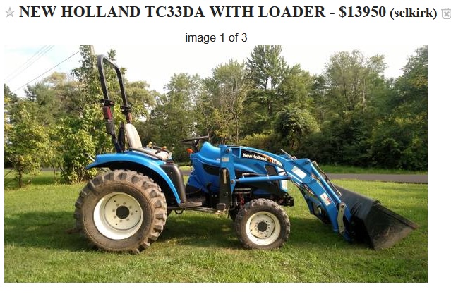

Here are a couple of low hour - right sized options for you on Albany Craigslist.
   / 700' gravel driveway with 2 acres of lawn in snow country #23
Both nice tractors but over budget by the time he adds implements.
   / 700' gravel driveway with 2 acres of lawn in snow country #24
I don't disagree, but thery were the only ones worth looking at on his local Craigslist. About the right size though.
