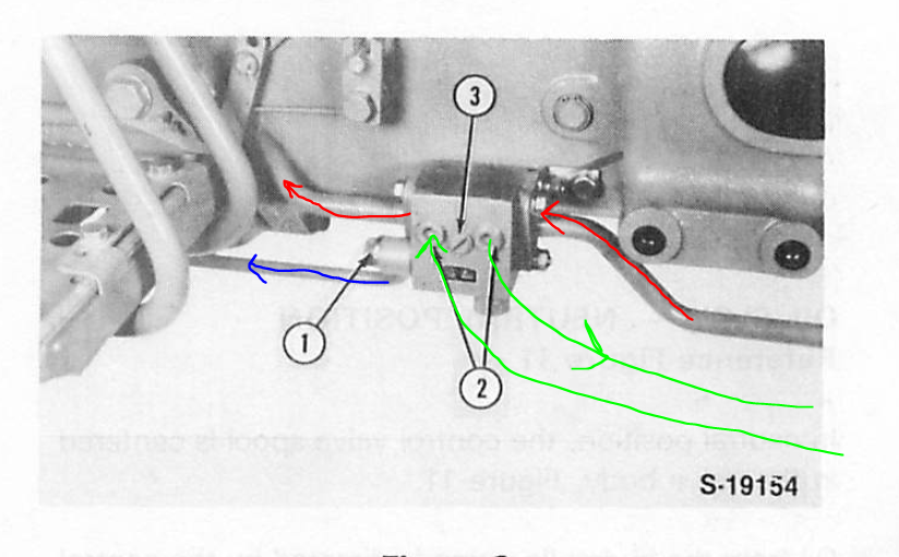

Hey Guys, happy new year. So it is guaranteed that the one port on my 7108 control valve is a Power and Beyond? Just cause it's named something else in the diagrams I have seen. They are named pressure in, pressure out, and to sump.
   / 7108 loader on Ford 1710
#16
ok thats what I figured... just wanted to be sure. So I guess I will have to find a place to run the return back to the sump. Do you figure I could tie that line into the relief return to sump hard line that is coming off that diverter block? Shown here in the blue arrow? I didn't really wanna drill and tap my case with a new fitting if I didn't have to. diverter valve flow.png

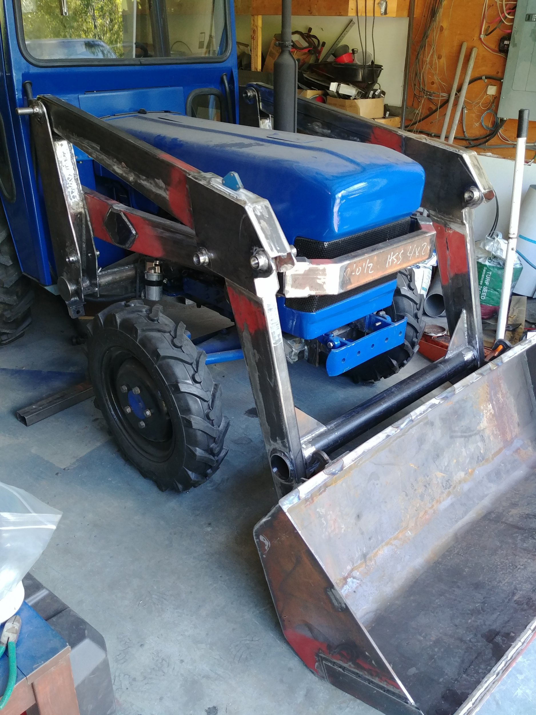

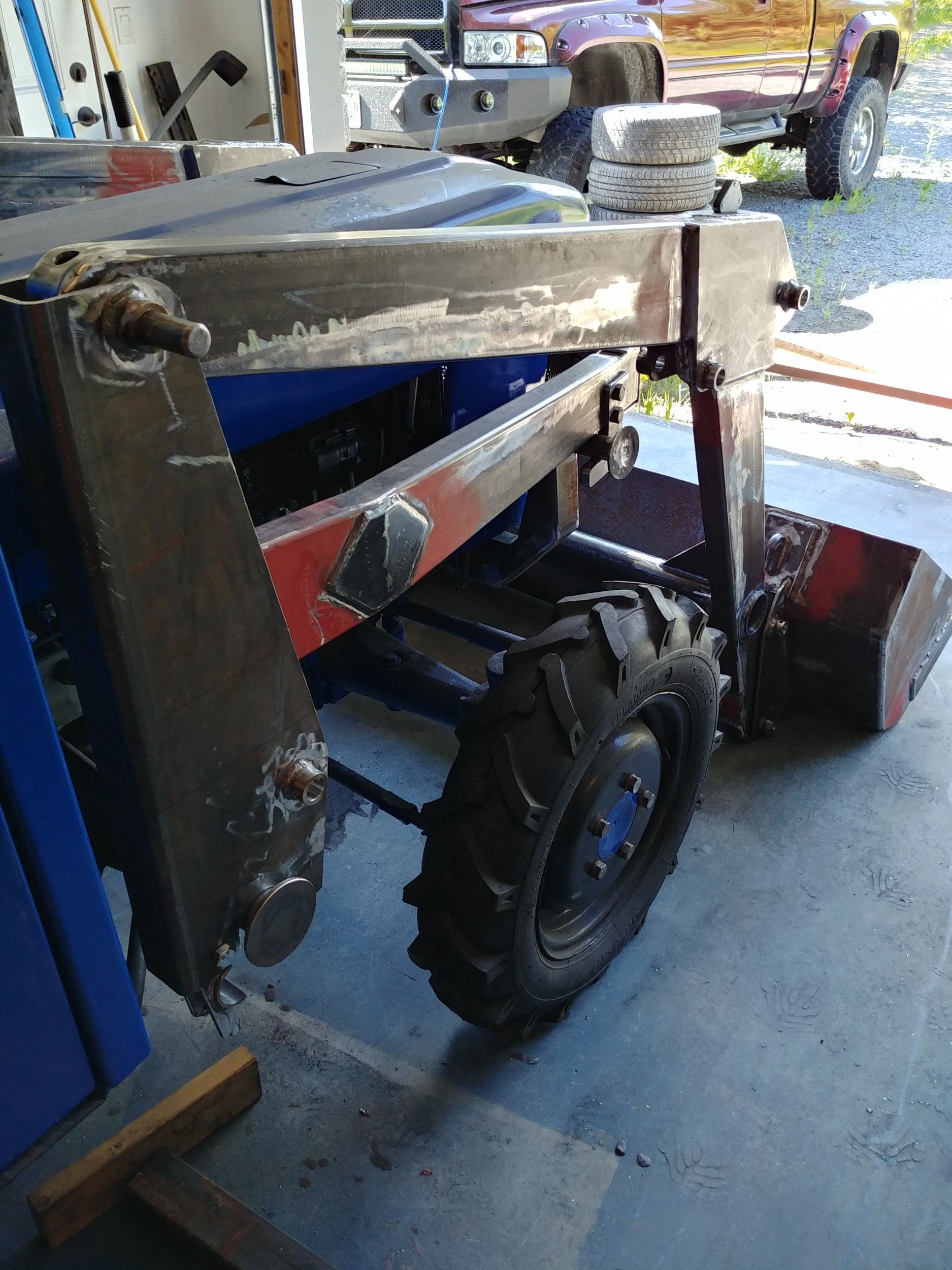

the Hydraulics aren't as bad. You just need to figure out where to make the return go. I decided to run to the same spot as the relief off the diverter block near the back axle. I had an extended JIC fitting machined to match the banjo bolt, then I just ran a hydraulic hose to the end of it. So that fitting will see the relief of the diverter block (so if I over pressurize the system) and the return of the hydraulic control. You could just drill and tap the side of the transmission case as well too. I know some 1710s have a port already there.
For the mounts, I actually made my front end loader, so I made everything fit. I did use the 7108 as a reference and used the control joystick from a 7108.
I still haven't used it yet though, I am just getting around to painting it this weekend if the weather holds up so I hope I can use it soon

Wow you built the entire loader! Beyond impressive. Thanks for the info. Would you show a pic of the rear bracket on the left side. I can modify the right bracket but wasn't sure what to do with the other side where the steering shaft is right in the way. I found this pic of one that looked like the way to go.
