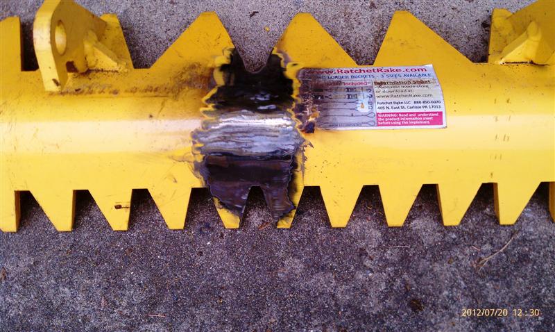

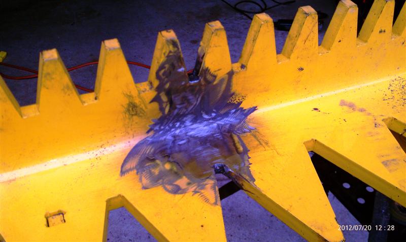

5/8" is a little thick for my Thomahawk 375
plasma cutter so I torch cut the tooth out.

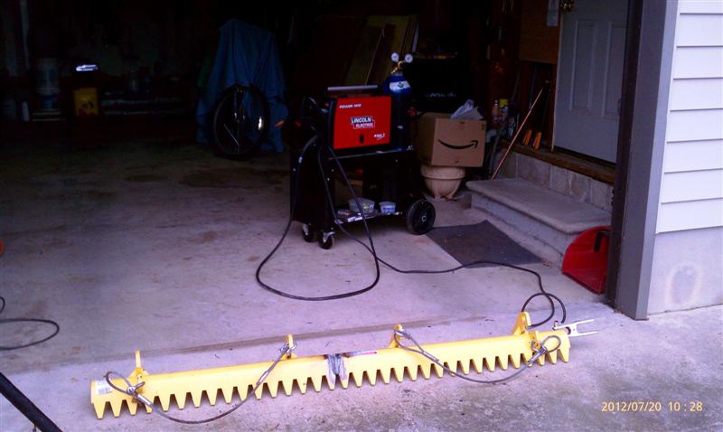

Trial fit up.

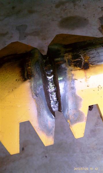

My MIG technique leaves something to be desired, but
I have maybe an hours worth of trigger time since I got
this MIG machine. I'm better at stick but don't own a stick
welder of my own yet but I'm working on it.
Ground flush and ready for paint

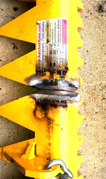

A shot showing the piece removed. I don't know about
everyone else but I took my tooth out of the center.
