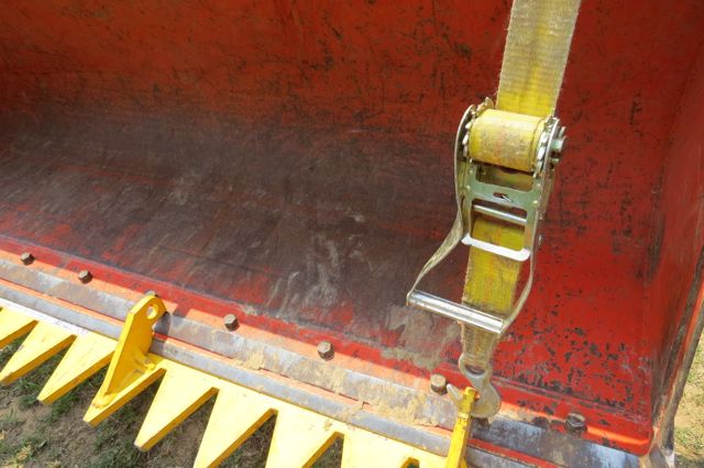

I used and abused my ratchet rake today breaking a cable, bending the metal handle on the tie down strap and cracking the top connector where it attached to the tooth.
Since I have to take it to the welder anyways, I was going to get them to weld a side piece of metal on it to be able to bolt it on to the inside of the bucket using the existing holes that I use for my tooth bar.
Has anyone added side metal bars to the ratchet rake for bolt on convenience?

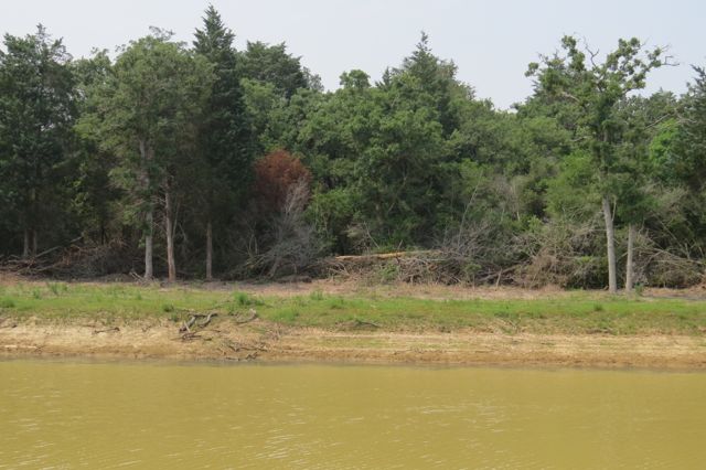

I think the bottom of the rake caught on a stump. After the drought in 2011 in Texas we lost a lot of oak trees that have fallen over but there are stumps at ground level or slightly below ground level.

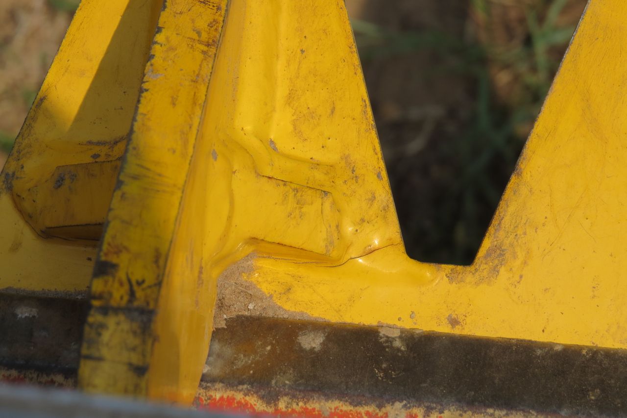

It's just a little cable and the handle on the strap is bendable, but what concerns me is the cracked rake.
I'll get some photos of the damage. Don't get me wrong, I love the rake and will repair it better than it was before. It may be tough but not quite tough enough for a Kubota and a Texan.:)
   / 72 inch Rachet Rake on sale at TSC $199 #553
I really can't tell if the weld is cracked or the paint on the weld is cracked?????
The strap handle on one end got bent up and the cable on the other busted - at different times.
The last picture is the area that I was clearing.
If it is just the paint I think I'll just get the forest service tie downs from their site.

The ratchet rake is not cracked. Only the paint is cracked. I scraped away the thick powder coating and the bare metal underneath looks good. Since no welding is needed, and I have a heavy duty bucket, I am going with the forestry service connection hardware (binders & shackles). - just a few $ more than the standard tie downs and cables.
