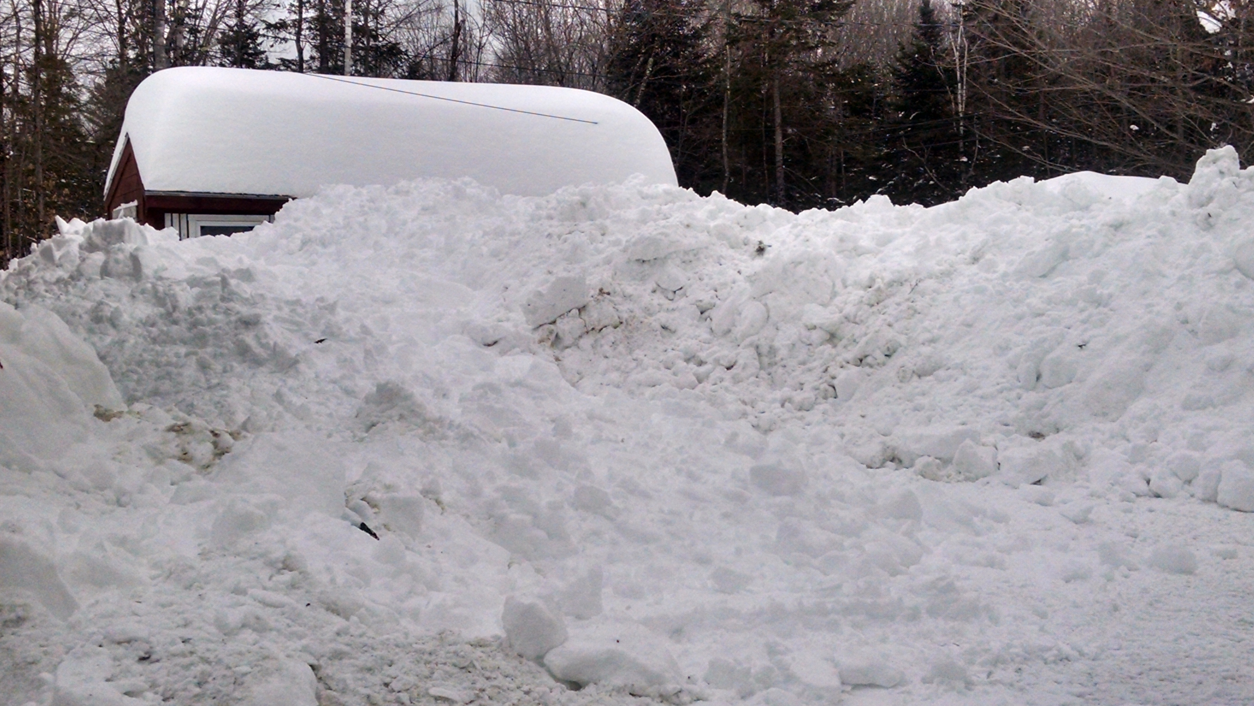

I have New Holland 2120 diesel. Tractordata says 35 hp claimed at PTO. I am in the snowbelt of Lake Superior. Around 4-5' on the ground into April. Want this for my camp, which I am at 2-3 weeks. We get 200-300' of snow. I got 10' banks, making my own ice bowl. Wondering if something quicker than picking up snow and moving.
What can I expect from 72" blower on this tractor? County drives in and opens up driveway. This creates 3' snowbank for about 50 yards. Other issue is when snow comes off pole barn. Last week 4'x30'x10'.
I don't have a ROPS. So can I mount the crank for rotating the chute manually?
Also what about brands? Thanks

Maybe I can learn new tactics. But it doesn't really seem to bust up. At this point, it seems easier to pick it up and move it away.
Snow is 4-5 deep now, not drifts Some places are already over 300"

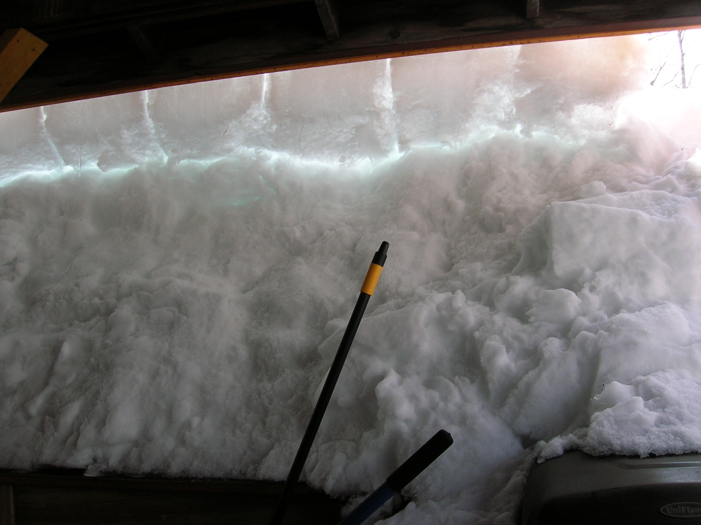

When it came off the roof last weekend was 4' deep hard snow. Is a blower any use in this? Unfortunately would come down off camp roof. Had to shovel 4' off. This was third shed this year. Some of the best snowmobiling was end of April last year, could see the top of picnic tables.

We have the same here. If I get huge chunks of really frozen stuff I don't try and blow it, I bucket it away. The blower will chew through hard stuff but I don't like to beat it up. I do take buckets of hard snow "not ice" and drop in in the middle of the yard and take half bites into the blower slowly, it sounds like a wood chipper but it works and I haven't broken a sheer bolt in three years of doing so..
