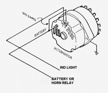

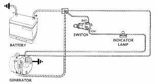

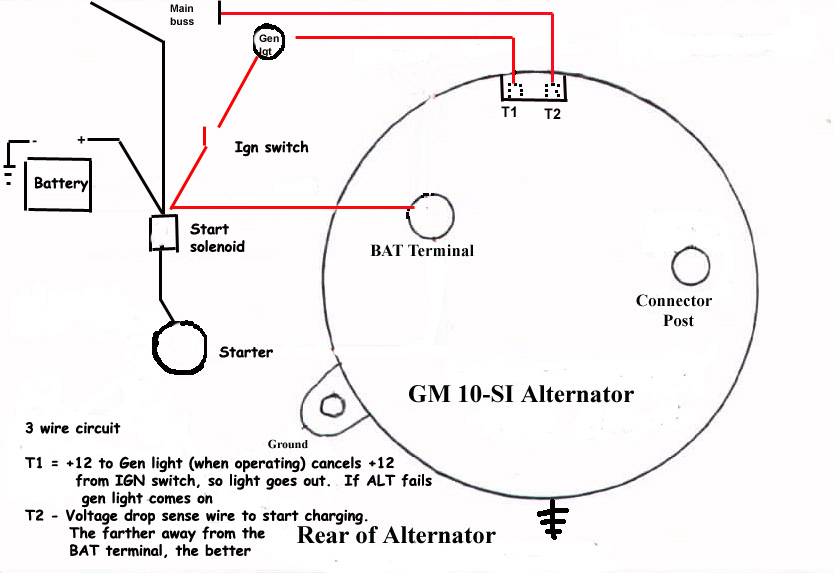

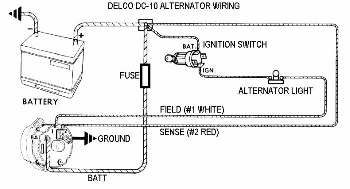

Just in case someone stumbles onto this thread because of it's title and wants to convert from Gen to Alt, here's some drawings that simplifies this dramatically. Excluding the tach drive issue. I replaced the Ford alternator on my 3910 with a Delco I had laying on the shelf. Again, remember, I didn't have the tach drive issue to deal with.
