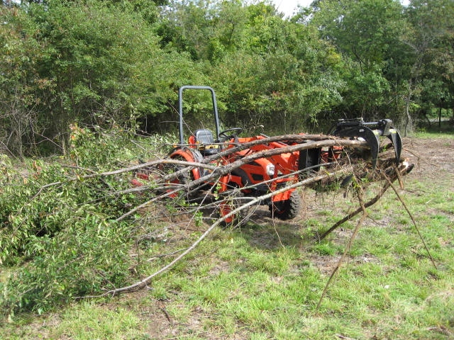

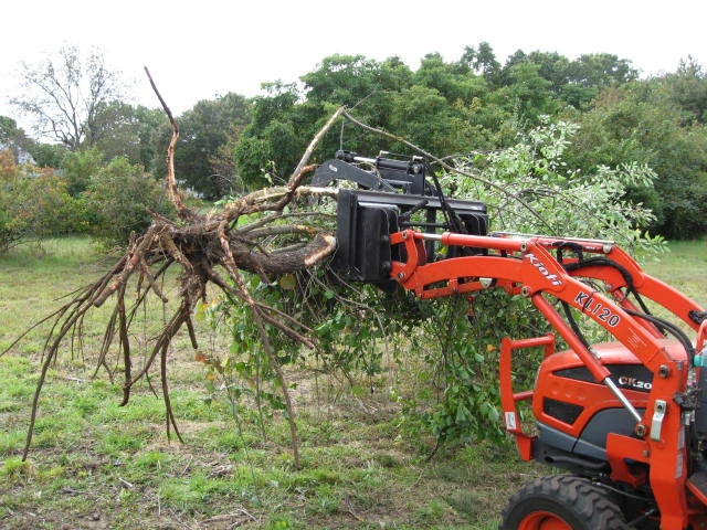

I'm doing similar land clearing work with my tractor which is a Kioti CK20 but in the same general size class as the 7510/7610. From my experience over the past year or so in clearing out about 2-3 acres of scrub trees, briar, vines and a few dozen bigger trees, I'd say that the backhoe is very valuable. I find a combination of bush hog, grapple and BH to be ideal.
The FEL on a B series machine is not as powerful as the FEL on my Kioti and while I can push over a fair number of trees less than 3-4 inches in diameter, anything much bigger requires cutting and then digging out the stumps.
My tractor is also heavier so I'd estimate that the 7510/7610 would have a more difficult time pushing trees over which is an important step in digging them out with either toothbar or grapple. My FEL has about the same lift capacity as the LA402 so I'd have a bit of an advantage there too. While I think my tractor has done amazingly well I would not opt for anything smaller. I would therefore agree that the B7800 would be worth the extra money. However, if it came down to B7510 and a BH vs B7800 without a BH, I'd say the BH is worth more than the extra weight and FEL capacity.
If you are doing a lot of land clearing do yourself a favor and get a grapple. Although a toothbar adds something to the ability of an FEL bucket to deal with brush, a grapple is the tool you want. A bucket grapple would suffice but a full grapple is much more versatile.

About $695 but you need to ship it from Ohio and also need a QA adapter and either a diverter valve or a set of rear hydraulic remotes. Total budget probably $1600-1800.
I got my CK20 with 28hrs on the clock, FEL, loaded tires, new BH all for $15K. I'd think you could do the 7610/LA352/BH for under 20K and perhaps have enough left over for the grapple. If the budget it tight, just go the bucket grapple route which will cost about $1000 including diverter valve.

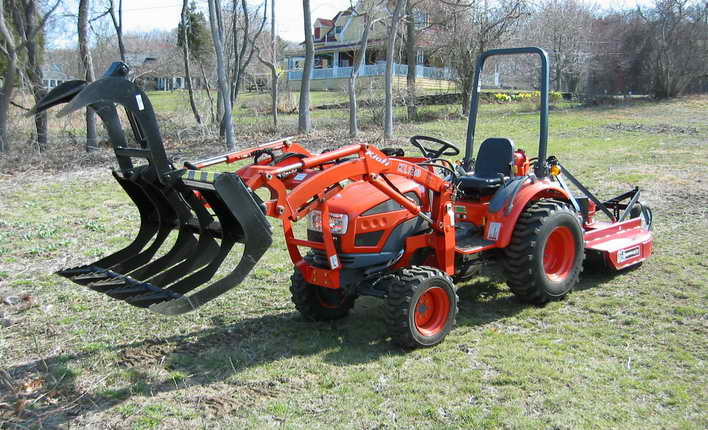

The grapple has a universal quick attach mount so it comes off in about 20 seconds. Takes longer to disconnect the quick connectors on the hydraulic lines than to remove the grapple.
   / 7510 7610 or what?
#26
From those pictures you sent... that's exactly what I will be doing and looks like it works pretty slick.

I don't have a box blade so when I am not using he hoe I keep the bush hog on the back. Awesome combo versus lighter brush or for clearing a path to the trees that need to be dropped. Grapple the brush then run over whatever remains. Quick work.
