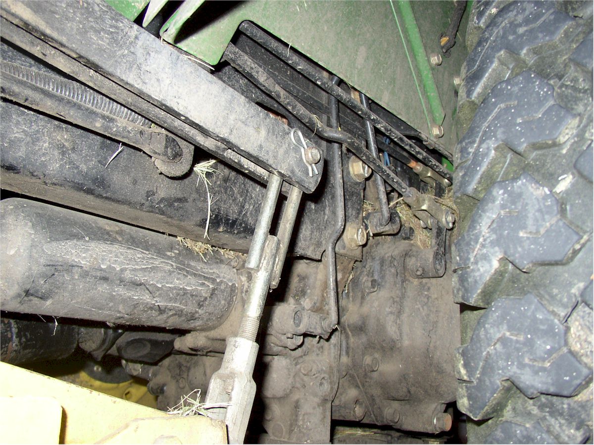

2. The attachment here shows how the rear lift links are attached. One link is adjustable for leveling side to side.
3. Without the optional hydraulic lift cylinder, the rear links will move with the three point. If you have the hydraulic lift option, they will move with left-right movement of the tractor's joystick.

1. you are correct it does not come with that bracket shown on page 4 of your attachement (A) however i believe that bracket is on my tractor
2. great, it appears the attach via a lynch pin to the rear arms which i see on my tractor and i saw them moving up and down with the -/+ do hikky on the deck.
3. So if i do NOT have the optional hydraulic lift cylinder the rear links will move with the rockshaft lever which will also move my 3pth arms so i will have to remove my tiller. IF i do have the optional lift cylinder it will lower with the loader joystick, do i have to disconnect anything on my loader or will the curling bucket just move at the same time as the mower?

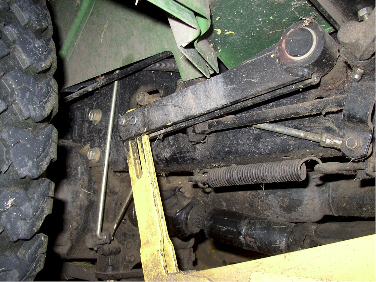

Your picture shows what looks to be two adjustable links. That may be fine, but I attached pictures of the standard 755 set up.

It's all there, as long as you have the black bracket on the front of the tractor for the front support of the deck to rotate into. It mounts under the bumper and has two hooks out the front and another hole for the locking pin to go in when you rotate it around. I think it pins on the tractor with a long pin if I remember right.
/ 755 MMM do i have everything? #16
See post numbers 11 and 12.
