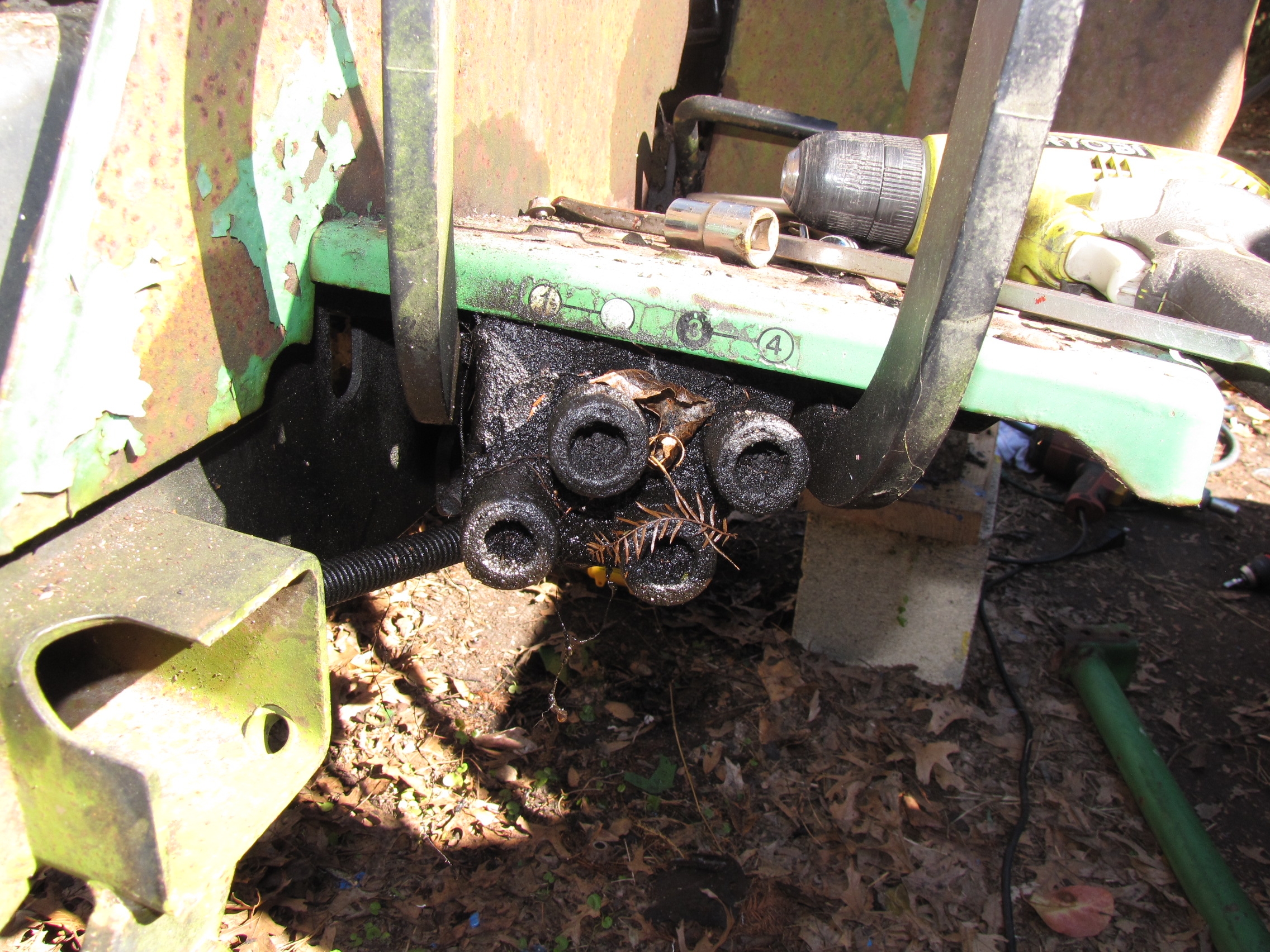

I have a 755 I got not running and don't know it's history.
It has the levers and quick couplers for a loader but no loader.
It runs and drives great and the power steering works great.
If you move the lever for the loader it will bog down like it should.
The 3 pt does nothing at all. No bog no lift, nothing.
I was told that on the 755 if you remove the loader you need a jumper to get fluid to the 3 pt.
This makes no sense to me as the loader only has 4 hoses 2 for lift and 2 for tilt I would think.
Anyway, if I do need to jump it I dont know where to put the jumper.
The couplers for the loader are numbered 1, 2, 3, and 4.
Do I need a jumper or is it something else?
I've attached a few pics. I'm not at all familiar with these little deeres so I really need it spelled out.
Any help is greatly appreciated.
Thanks :)

If the directional control valve stays with the tractor when the loader is removed it should not require a jumper for the 3 point to work.
How many lines connect to the control valve including the four for the loader? 6 or 7?

I'm pretty sure that everything stays with the tractor. It only has the 4 quick couplers. And the lever to work the loader is on the tractor. What I was seeing about a jumper didn't make any sense to me. I'm thinking there is no need for a jumper. I don't see any other lines from the block that controls the loader. I think the block in front of it has the in line and the relief valve. Other then that I'm not sure. I put it all back together, and then decided that I really need to see if I can get the 3pt going. I'm going to pull the covers off tomorrow when its warmer. Then I'll be able to see what lines go where, but I don't really remember any lines for the 3pt. Is there anything that would let the loader lever bog the motor but not send anything to the 3pt other then the directional valve? I dont see any lever on any of the valves either, other then the loader control. Is the directional valve automatic or should there be a lever somewhere?

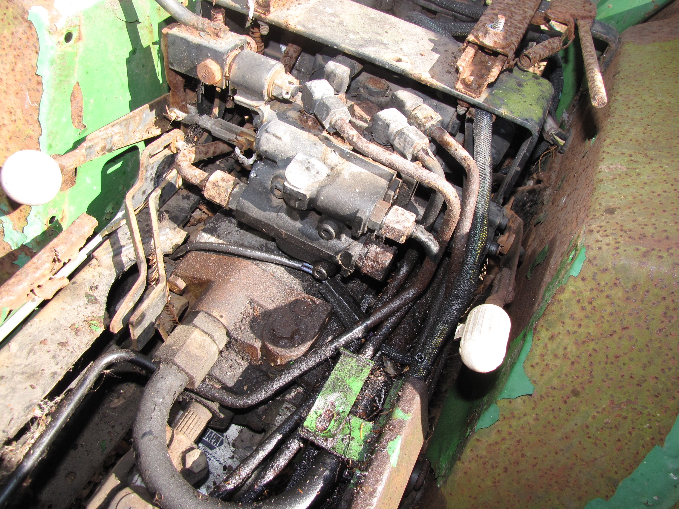

I went out and pulled off the covers again. The main pressure line comes it to the right side of the 1st block. On the left side of the 1st block is one line that goes up to the front of the tractor, power steering as best I can tell.
The second block has the lever for the loader with 4 lines coming off the top and going to the quick couplers. That block has 2 housings sticking out the left side but no lines.
There is one other line I can see coming from the front and hooking into the left side of the housing near the rear. I believe it's probably the return from the steering. Beyond that theres the lever for the 3pt and the link to tell it where the arms are.
Thats all I can find going into the system.

First for clarity are the 3 point arms lowered and won’t raise or are they fully raised and won’t lower?
From your description above it almost sounds like that tractor has a priority flow control that supplies oil to the power steering and excess flow is directed to the loader and 3 point. You stated engine works when activating loader function so that indicates flow going to loader valve.
The power steering flow may come back and act as charge flow for the hydrostatic transmission. ( presuming HST) you state steering is working fine.
With out a hydraulic schematic I am unsure of how oil is supplied to the 3 point. Typically it would be via power beyond from loader valve.
