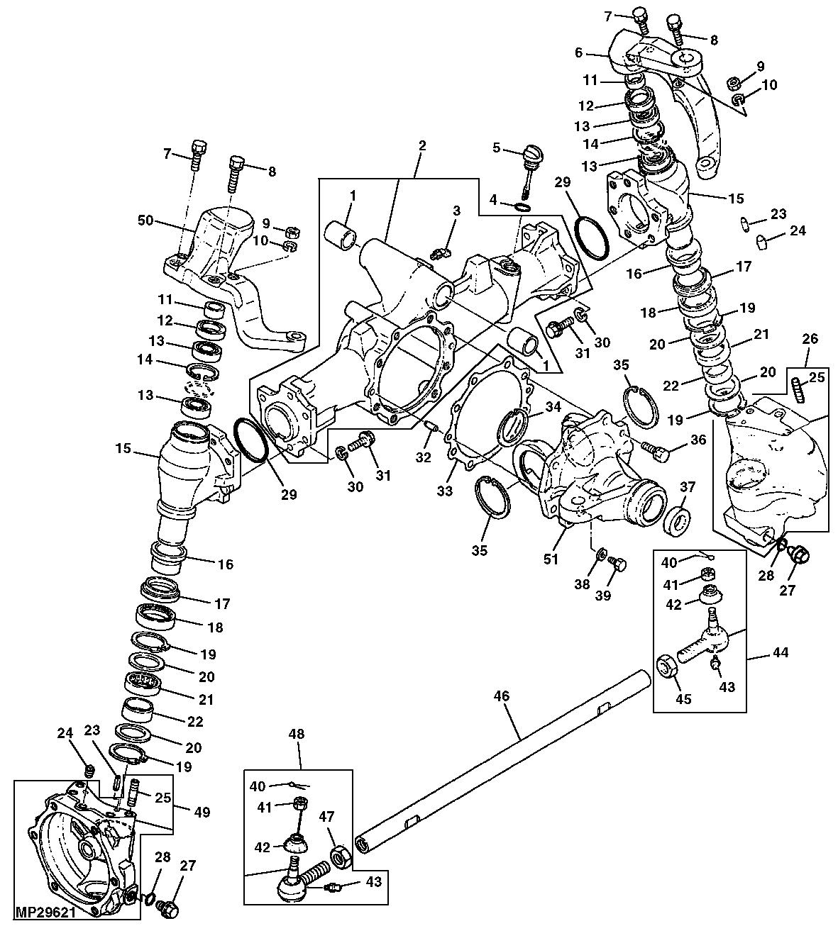

Here is a schematic of the front axle (4WD) for the JD790:

Did you try the link?
It's for ordering parts...when you register, you select where you want the parts shipped.
BTW, the illustration below may be just one of 2 or 3 and not showing all the detail.
What's with this register stuff ?
I use this part of JD and don't believe registration is required. Am I wrong ?, or is my browser auto signing in ?
Order Manuals and Parts Catalogs from JohnDeere
Seems to be missing a few pieces.
