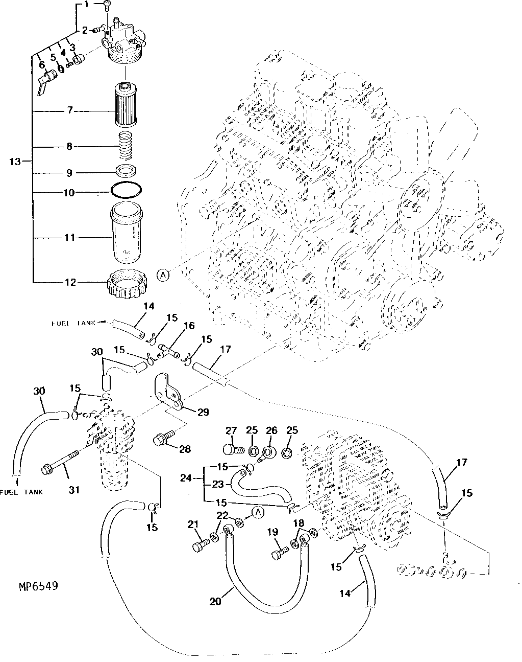

I have a JD 790 that doesn't seem to be getting fuel to engine. there is fuel and the battery is good. is there any manual override? fuse seems to be fine
   / 790 Fuel Solenoid Fuse Problem #15
Need to be sure the fuel shutoff solenoid is working. There is a tech manual available (which you didn't ask for ;) ) but no manual override that I know of.
   / 790 Fuel Solenoid Fuse Problem #16
ok where would i find a tech manual? ok another dumb question where is the fuel filter?
   / 790 Fuel Solenoid Fuse Problem #17
Fuel filter will look similar to this photo unless your tractor is above SN 790001 -
