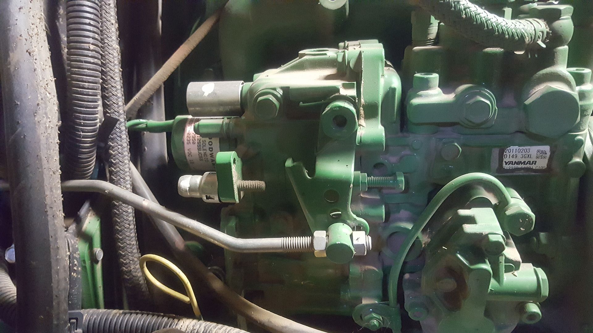

Only had a minute tonight, but I did look at how the wires to the solinoid are routed, and took a picture for you. You will see the harness connection, it's the white plastic 3 blade circled upper left, and the circle middle right where you can see the wires going into the solinoid. Black is most likely ground, white is run/hold in, red is start/pull in... if memory serves me correctly. I DID NOT verify that tonight on my machine, I didn't have the time.
Does you have a volt/ohm meter and/or test light? If so, I can walk you through the process of testing at the white connector.

I checked the voltage at the white connector, tractor side. Did not get the results I had hoped, but know better what to tell you...
Wire color on the solinoid side of the connection is different than the tractor side. You will have to transpose as needed. Solinoid side, black wire is ground, and red is switched hot/run 12v +. I expected to find a 12v+ reading on the white wire when the key was in the start position, but NO DICE. Now I'm confused, but also not sure that my test is accurate, having the solinoid disconnected. I'll try to check it better, while connected. I'll let you know what I find.

Decided to go ahead and pull the solenoid in preparation for the test. A 10mm Box Ratchet Wrench does the trick for the rear bolt however the front bolt is in a VERY TIGHT space. Didn't want to use an open box wrench, can't get a good straight-on angle/leverage + afraid of stripping the bolt (been there done that). Looks like another trip to HDepot for a small body 1/4" Ratcheting Socket Wrench. Seems the 10MM short socket does the trick (access/fit) however my 3/8 Ratcheting Wrench + reduction socket to 1/4" drive + short socket is still too long for that confined space. Report back later......I'll get this off today.........I HOPE.....:drink:

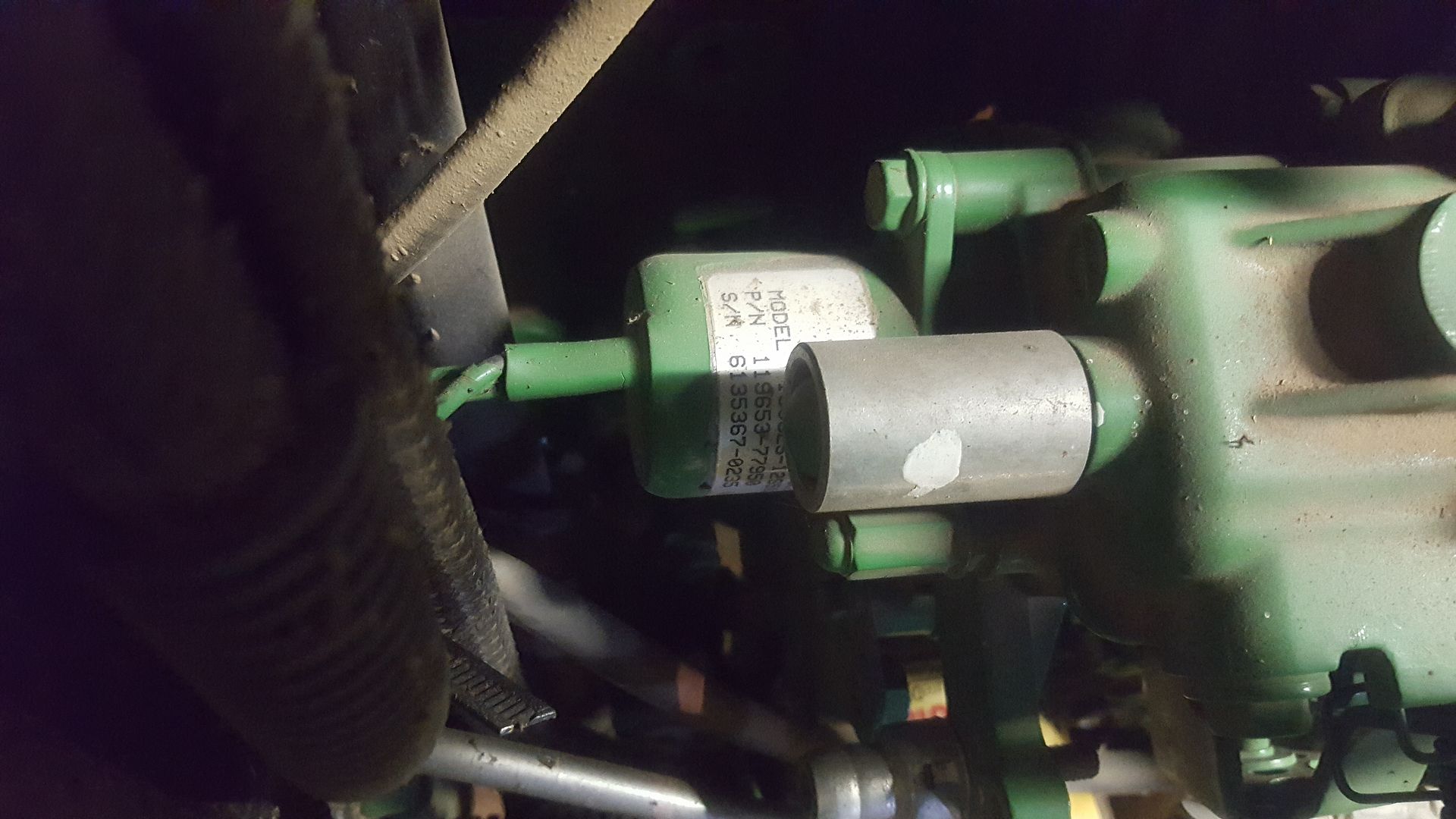

SUCCESS :thumbsup: - The smaller 1/4 drive Ratchet Socket Wrench made it easy however that's really tight in there, wondering how I'll get it or the new part back in. :muttering: Selenoid still attached to Harness, I could push the plunger/rod up into the housing freely with some slight fluid gurgling sound. Pulled the PN information off the housing, Model: 1503ES-12S5SUC5S (WOODWARD / SYNCHRO START NO.) Part No. 119653-77950. Wondering if that's the original part, not that it really matters at this point. The engine compartment is pretty dusty, we're in a moderate drought here.....READY !

Gurgling sound?? I believe there have been some problems with the solenoid leaking??
