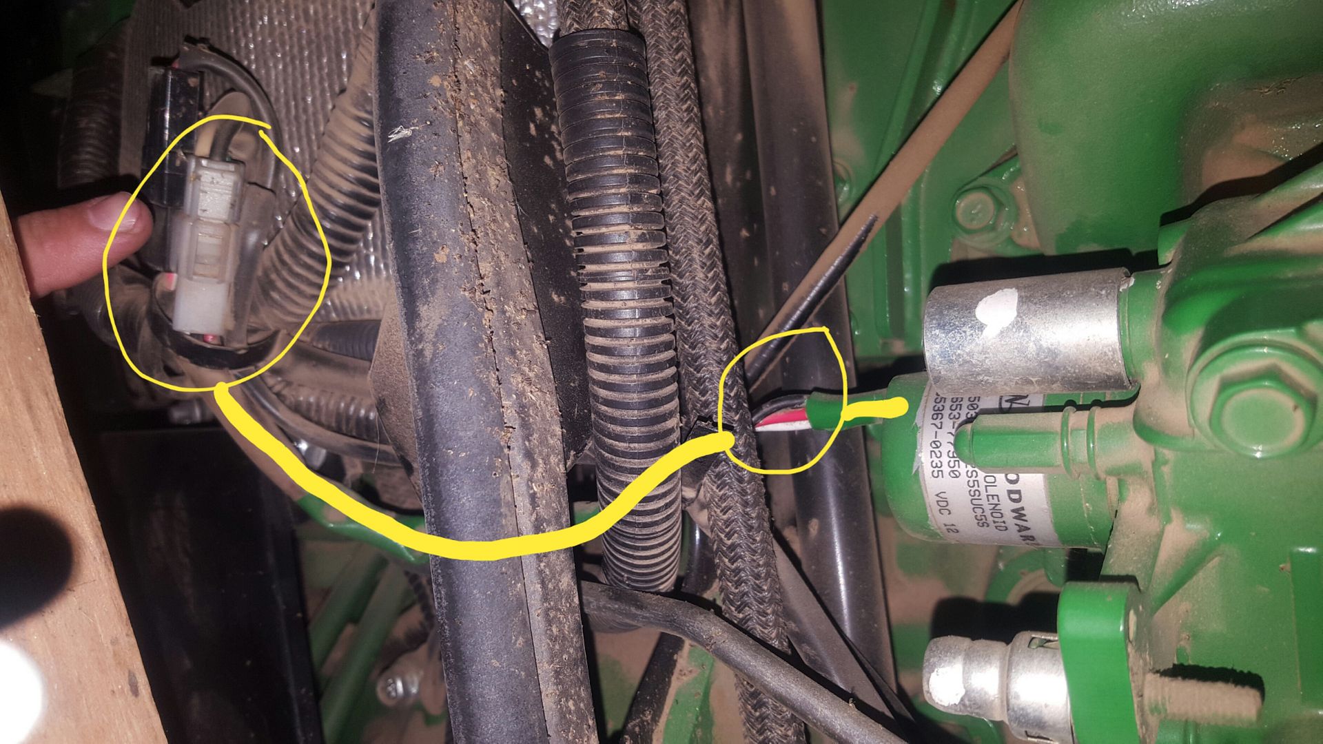

Only had a minute tonight, but I did look at how the wires to the solinoid are routed, and took a picture for you. You will see the harness connection, it's the white plastic 3 blade circled upper left, and the circle middle right where you can see the wires going into the solinoid. Black is most likely ground, white is run/hold in, red is start/pull in... if memory serves me correctly. I DID NOT verify that tonight on my machine, I didn't have the time.
Does you have a volt/ohm meter and/or test light? If so, I can walk you through the process of testing at the white connector.

   / 790 Sporadic Starting #29
I checked the voltage at the white connector, tractor side. Did not get the results I had hoped, but know better what to tell you...
Wire color on the solinoid side of the connection is different than the tractor side. You will have to transpose as needed. Solinoid side, black wire is ground, and red is switched hot/run 12v +. I expected to find a 12v+ reading on the white wire when the key was in the start position, but NO DICE. Now I'm confused, but also not sure that my test is accurate, having the solinoid disconnected. I'll try to check it better, while connected. I'll let you know what I find.
