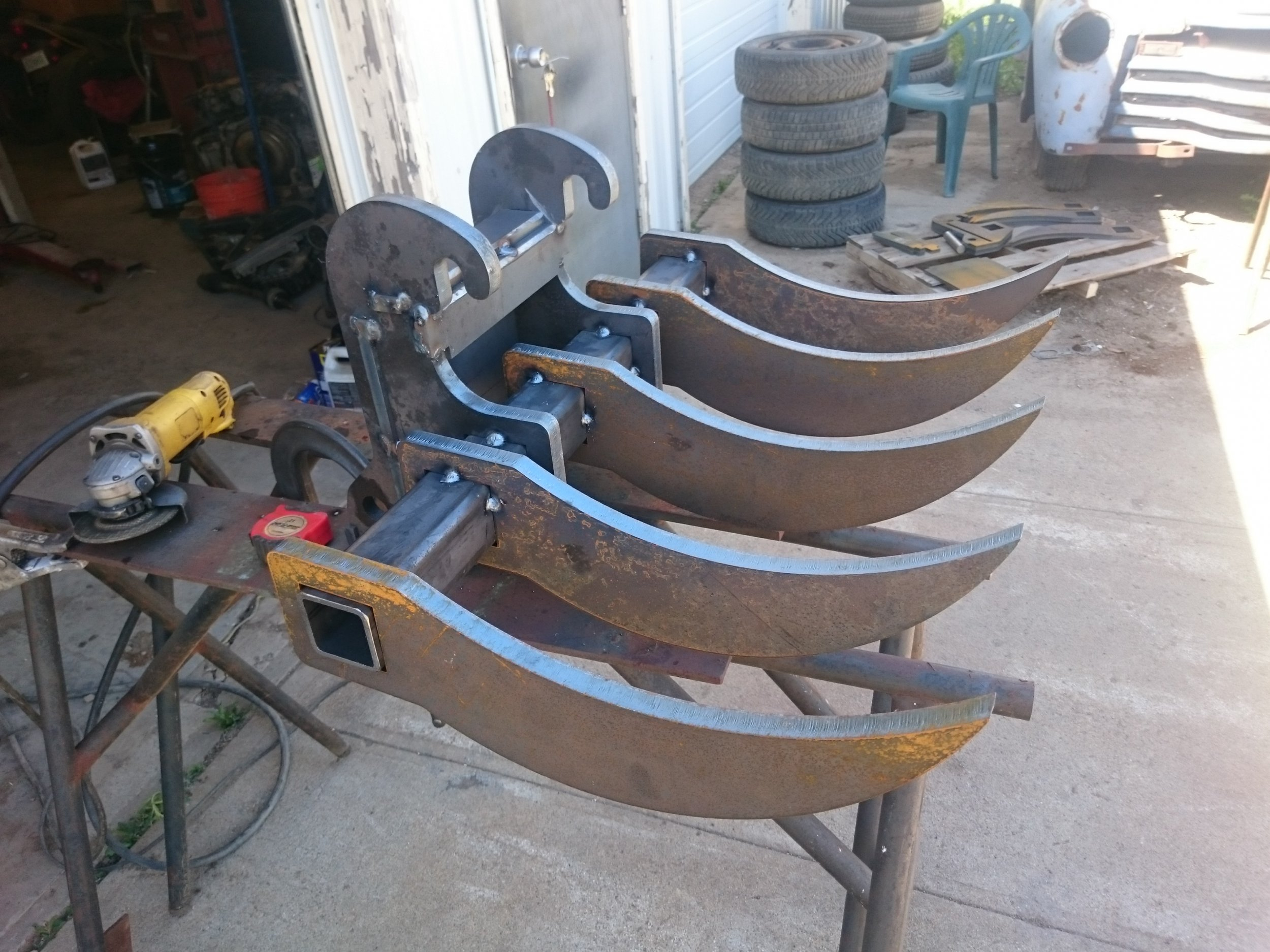

the one I welded up the bottom is 5 inch the top same as the machine width. the picture is on the older machine the grapple is defiantly wider, never put on on the e32 so no issues, with such a taper on width plus length it does not clog unless one totally fills the bucket and compresses it, dug all my irrigation lines for the yard, power and gas to my shop and a few larger 4 inch polly pipe I can push wires, coax and 1 inch water when needed to specific locations around the acreage

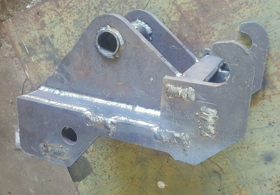

That bucket you made, did you make the x-change coupler too? Or make it from scratch?

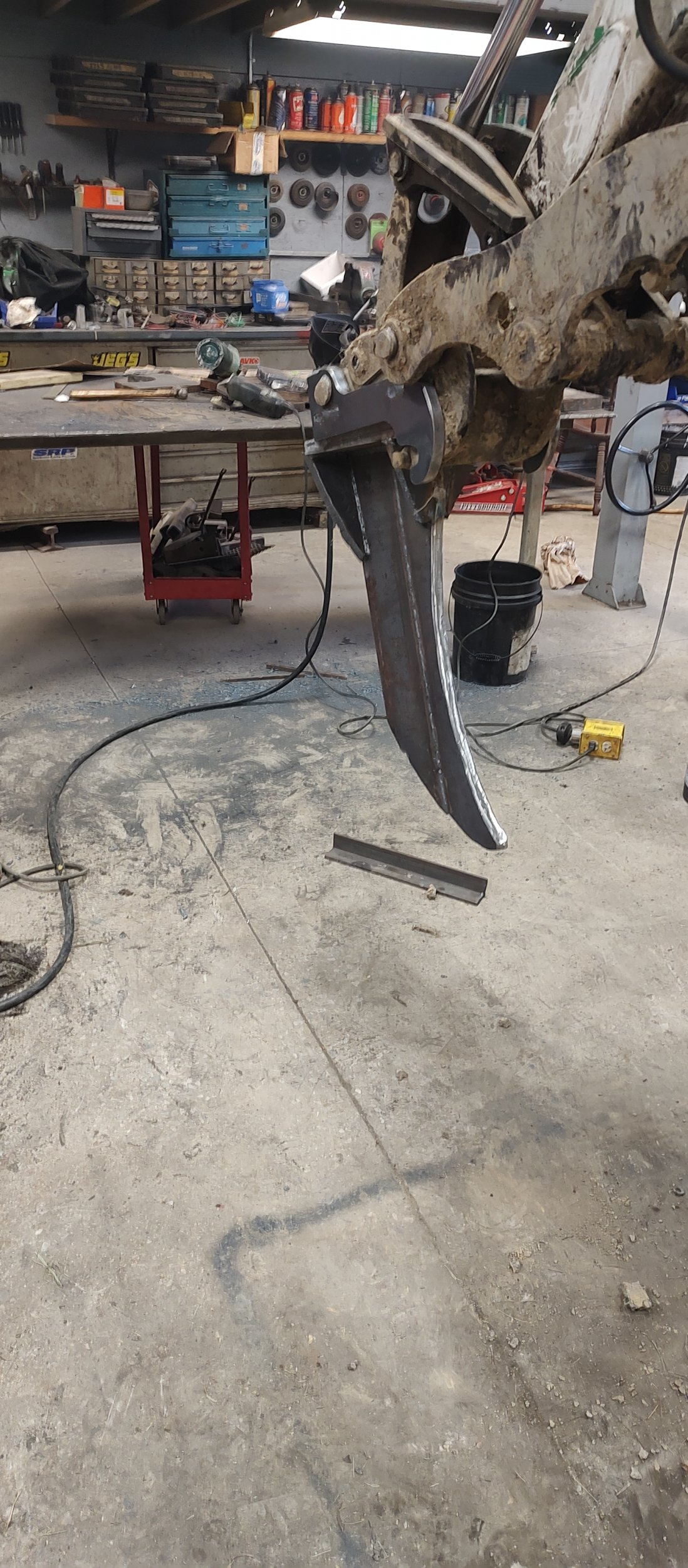

I just recently did a ripper tooth for stumping for my 334 (similar size to e32).
A ripper was $1600+. The adapter was only $400. So saving $1200, I had some 1" thick steel I made my own in half a day of shop time.
But had I needed to start from scratch, and make the adapter.....would have taken me a couple of days, i would have had to buy steel because my scraps I have up to 1/4"...then some 1"+ stuff. But nothing in between. And probably would have been a lot of cussing and grinding to get it to fit right

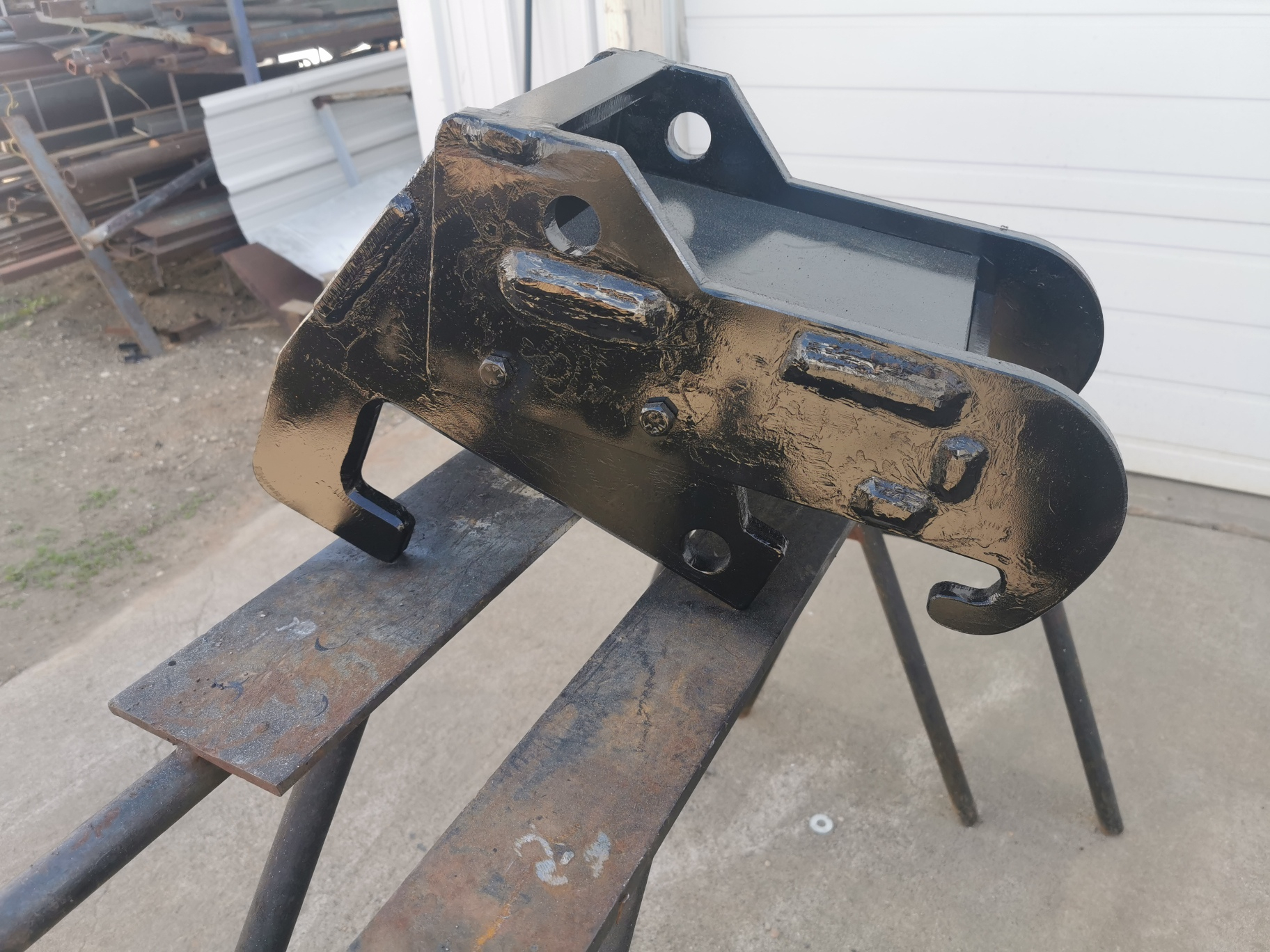

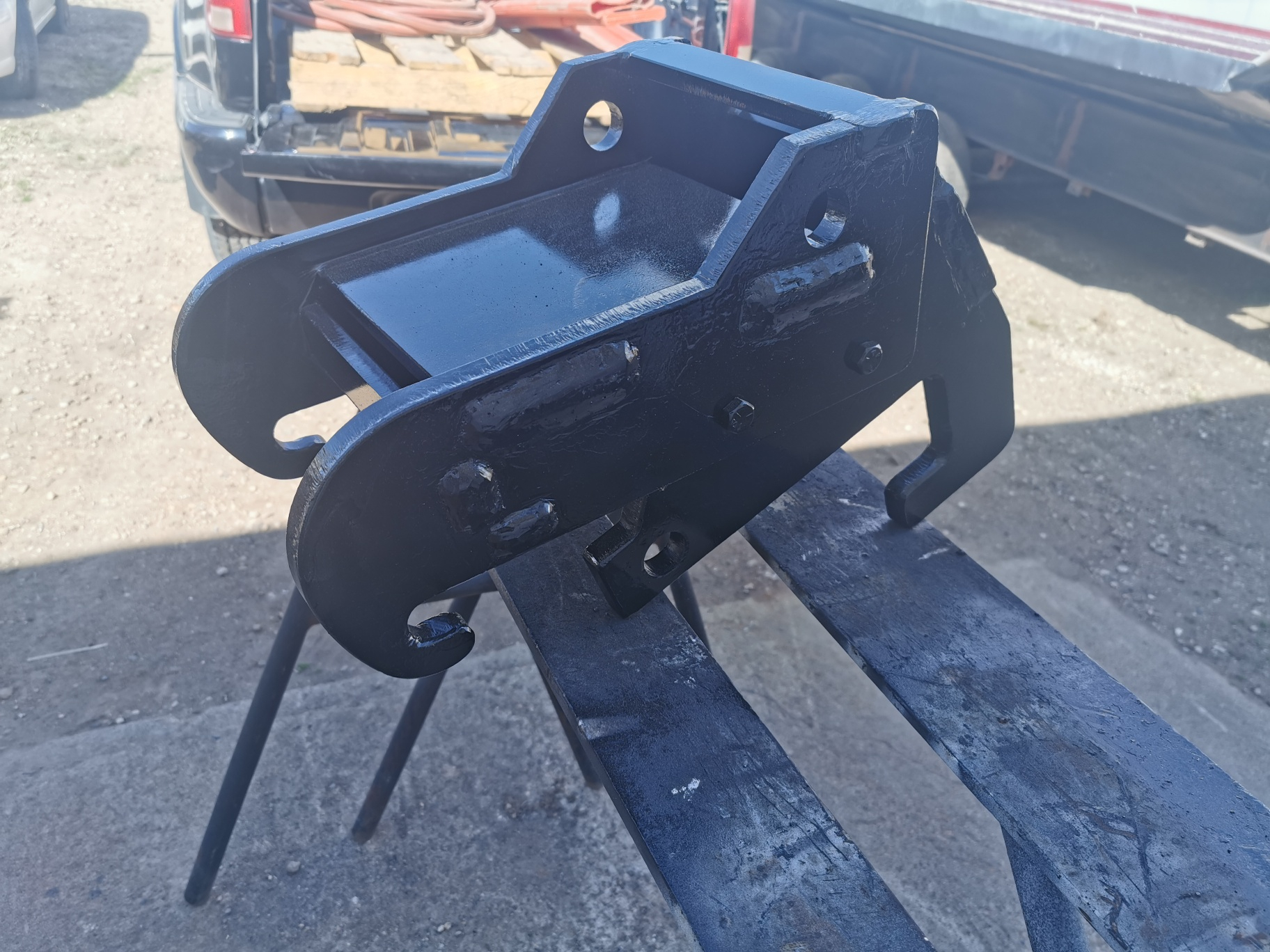

body is 1/2 thick, on the bottom I took a piece of grader blade for the tooth, its full width, it was laid out on cad, the mount is the x change for Bobcat, its 3/4 plate, all parts were plasma cut then welded together

nice ripper, yes I drew the x change myself, Bobcat sell a mount bit way too big, the mount is 3/4 plate and 1/2 for the ribs and back, besides the bucket I have made a attachment to reverse the bucket so dig away from the machine, a rake out of 1 inch plate that is used to sift rocks out of the gravel and dirt, good also for raking roots,
reverse adaptor and cad layout rake and rake attachment and one for the auger
