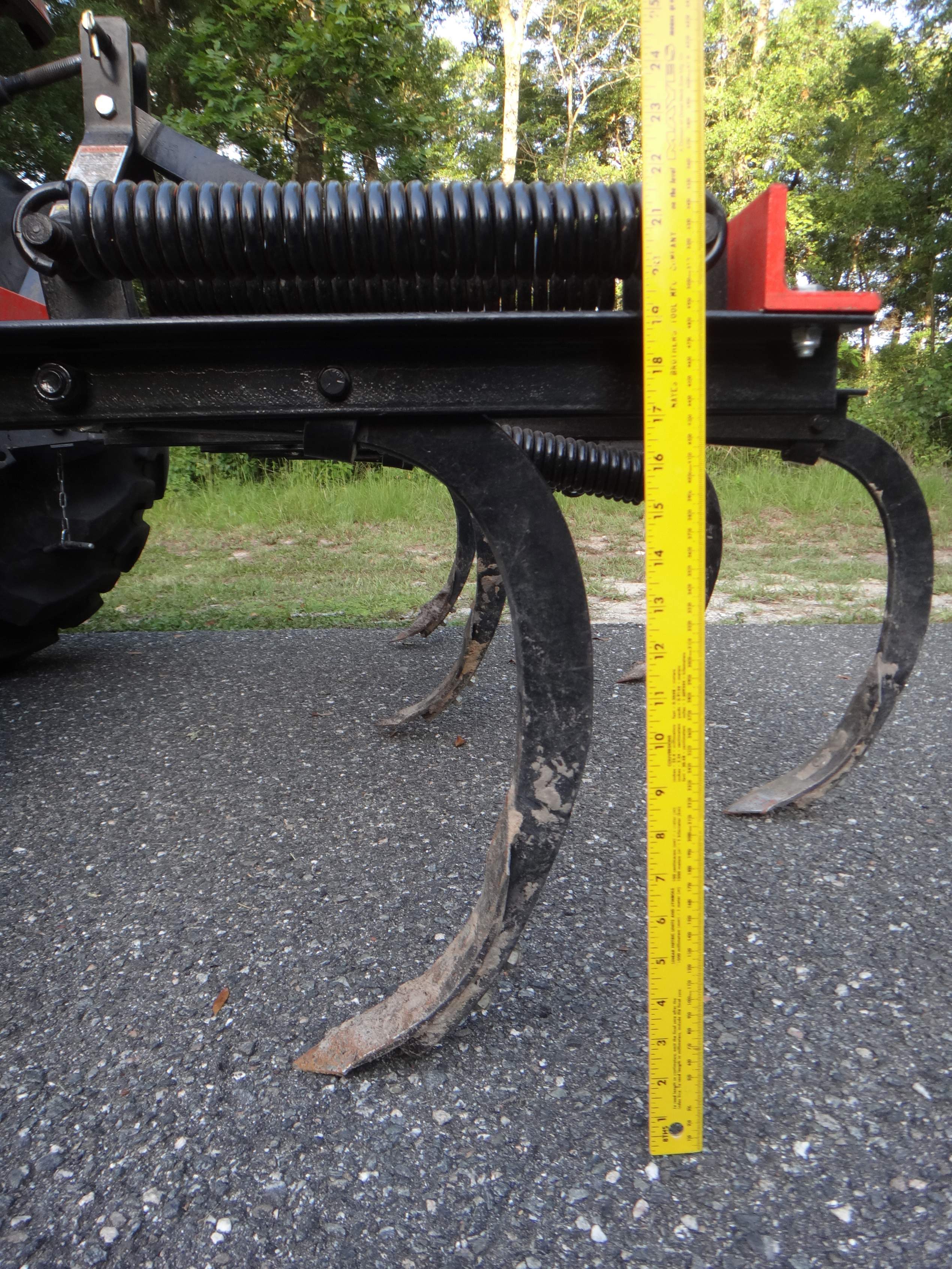

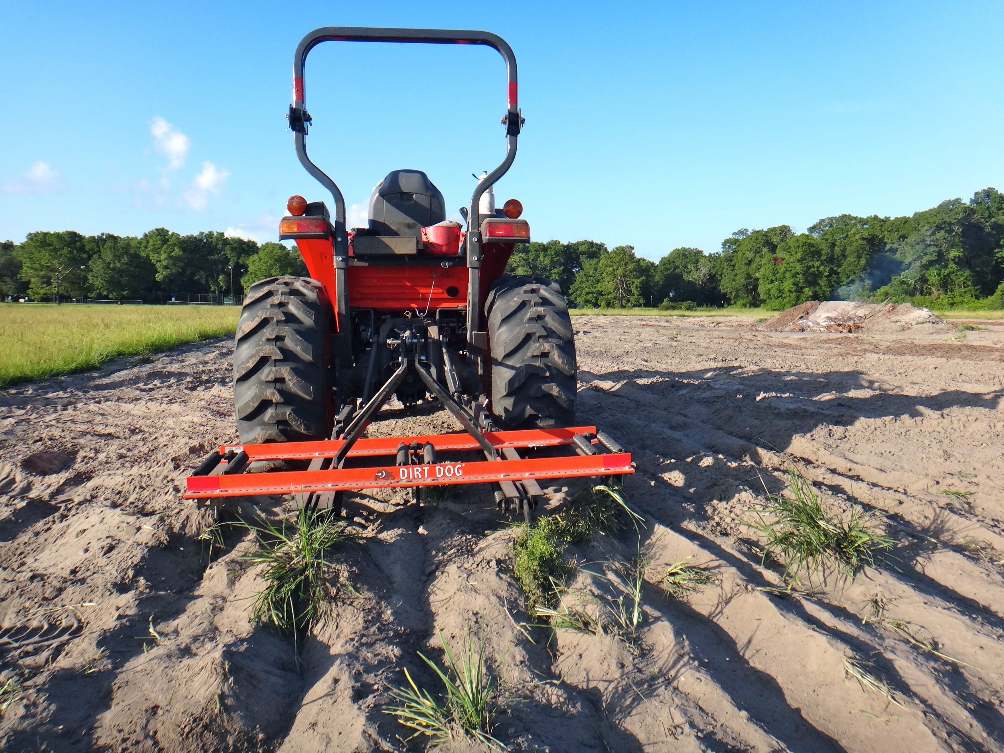

Consider an APP/Field Cultivator for 10"+ depth. You do not want to mix top soil with infertile subsoil.
MORE: https://www.tractorbynet.com/forums/attachments/339095-dirt-dog-all-purpose-plow.html?highlight=
VIDEO: Fred Cain 7 Shank 3 Point Field Cultivator 85in bar

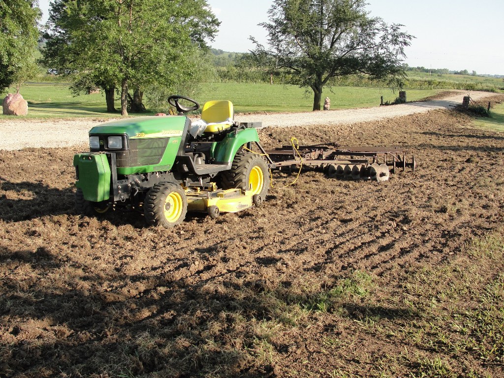

/ 8' pull-type disk behind L5460, possible? #16
I pull this 8 ft wheel disc with my Mahindra 5525. It's a 14-ft wide disc cut down to 8 ft.
Good luck
