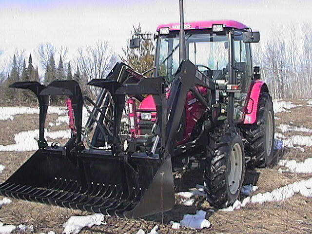

I had the same considerations 2 years ago.
Didn't get excited with the green blue & red offerings.
Almost resigned to buy a Deere 6300 MFWD, cab, 640 loader used or a 5420 new.
Then stumbled across this brand at a local dealer. I was going to put a grapple on the loader dirt bucket but dealer talked me into putting on rock bucket.. excellent advise.
A grapple is invaluable for speeding cleanup.
I agree with the notion of large tires mine has 16.9x30/11.2x24's. I drove into one of my swamps to mow - it looked dry - muddy surprise! But was able to drive straight up a berm & out the other side dragging the bush hog. Smaller wheels would not be able to step up a 24" berm.
I bought the tractor with 2nd seat, loader & attachments at one time about $30K & change.
www.zetor.com
Other stuff hay wagon, dump trailer, plow, etc. I bought used at auctions or junk yards cheap. Got to practice with the welder a bit.

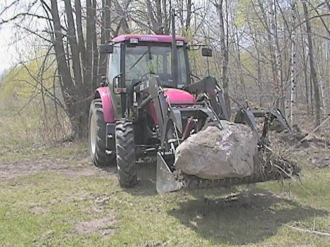

Rock bucket is from a local skidloader attachment & trailer manufacturer.
http://midsotamfg.com/
Pried up several lawn ornaments & taken direct hits with all 10,000 # of tractor behind it. Have not been able to bend it.
