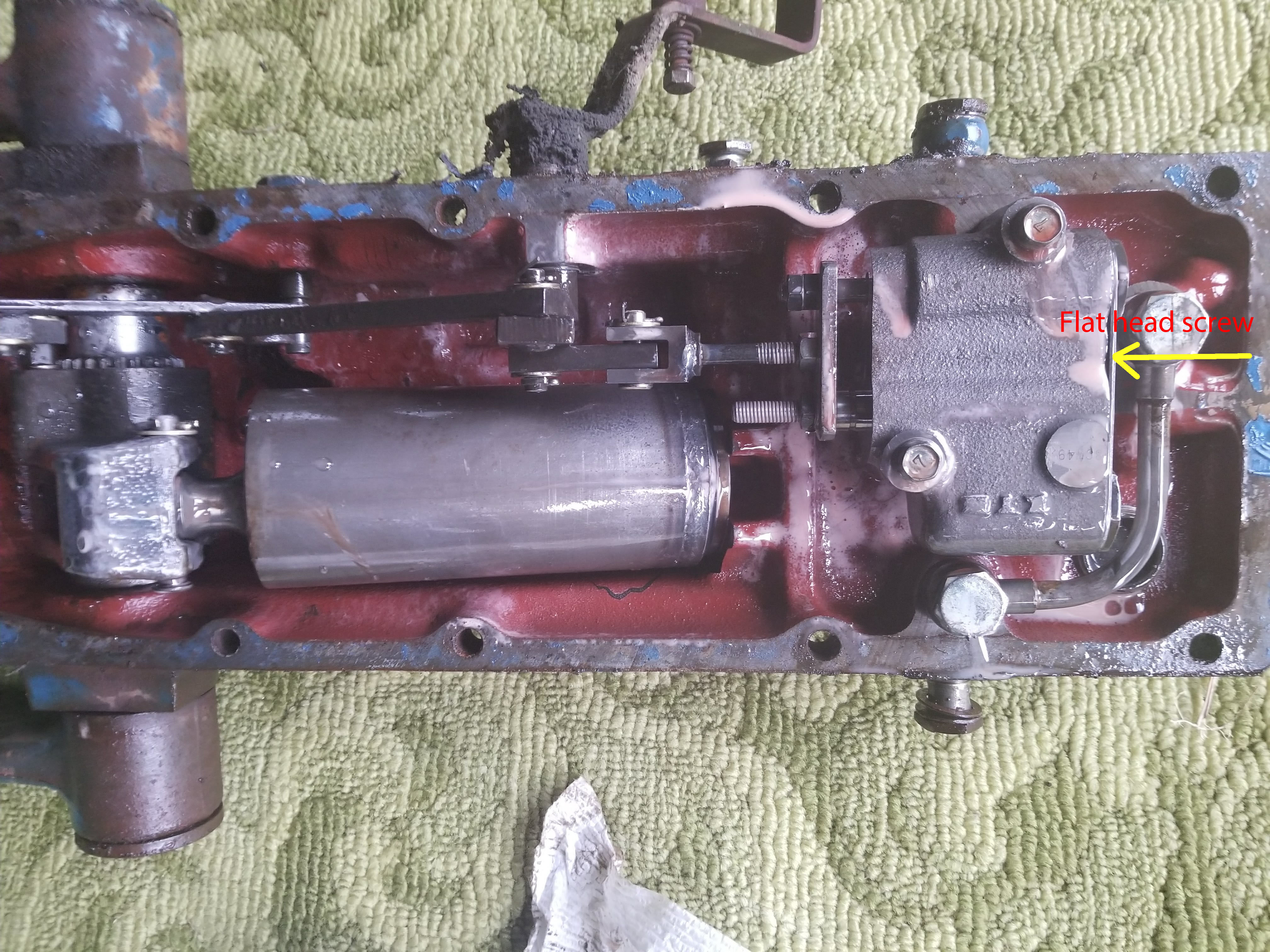

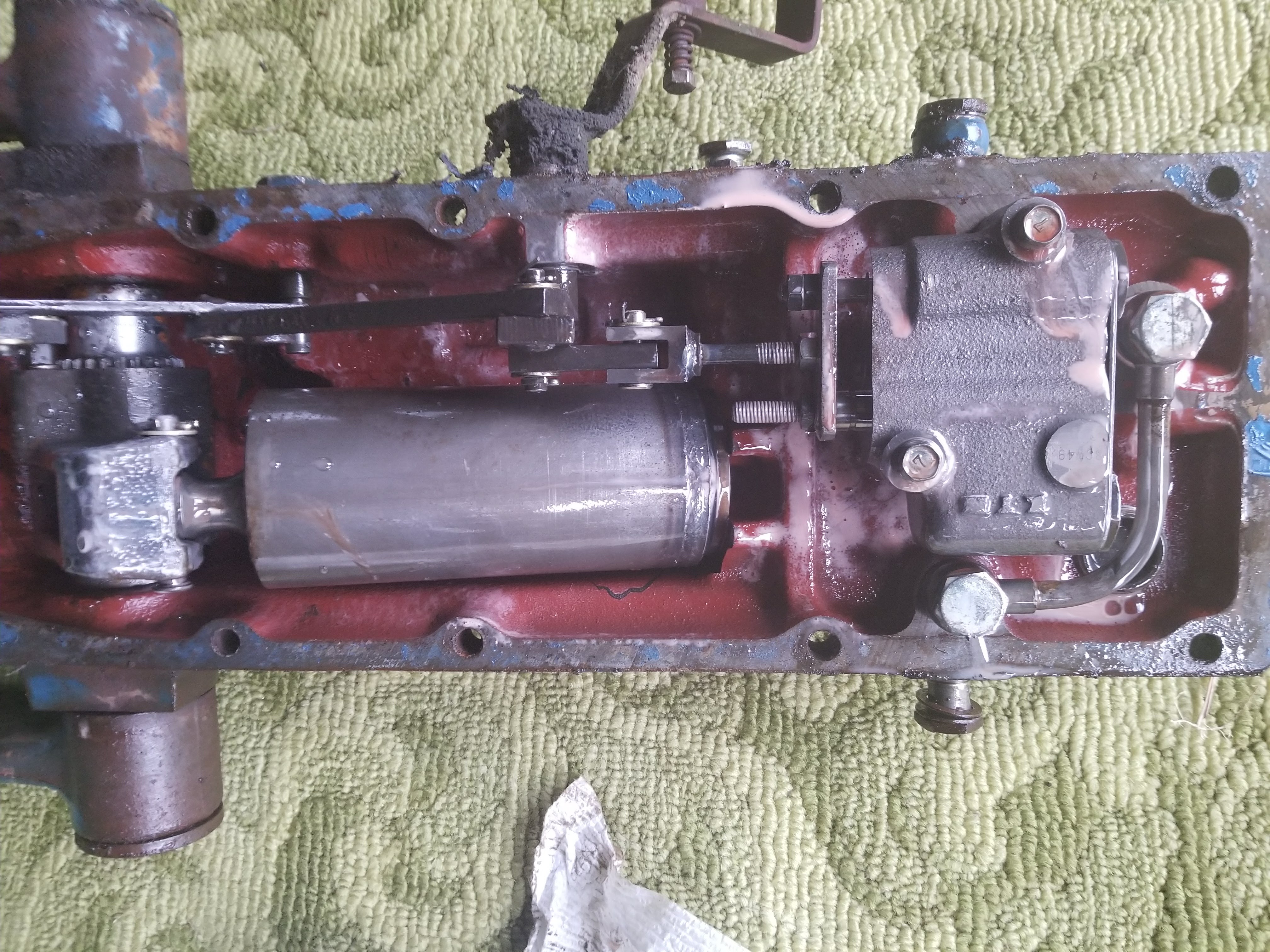

Keep in mind, I don't know much about tractors, especially hydraulics...but I know how to turn an wrench and apply techniques to put things back together.
Anyhow, I am going to make this short. Tractor was lifting 3 point fine after it sat up for 15 years. I added #80 gear oil to the fill plug and checked it with the check plug. 3 point started working again then stopped. Drained fluid, cleaned filter screen, and added new fluid. Still no go. So I parked it.
-Checked valve on top of hydraulic plate. Bolt, piston, spring, O ring, etc looked fine. Nothing clogged.
-Took off top hydraulic plate (see pics). Took Valve off and two bolts holding valve and springs in. Everything looked OK. Maybe I should have inspected it further.
-Reassembled and still nothing.

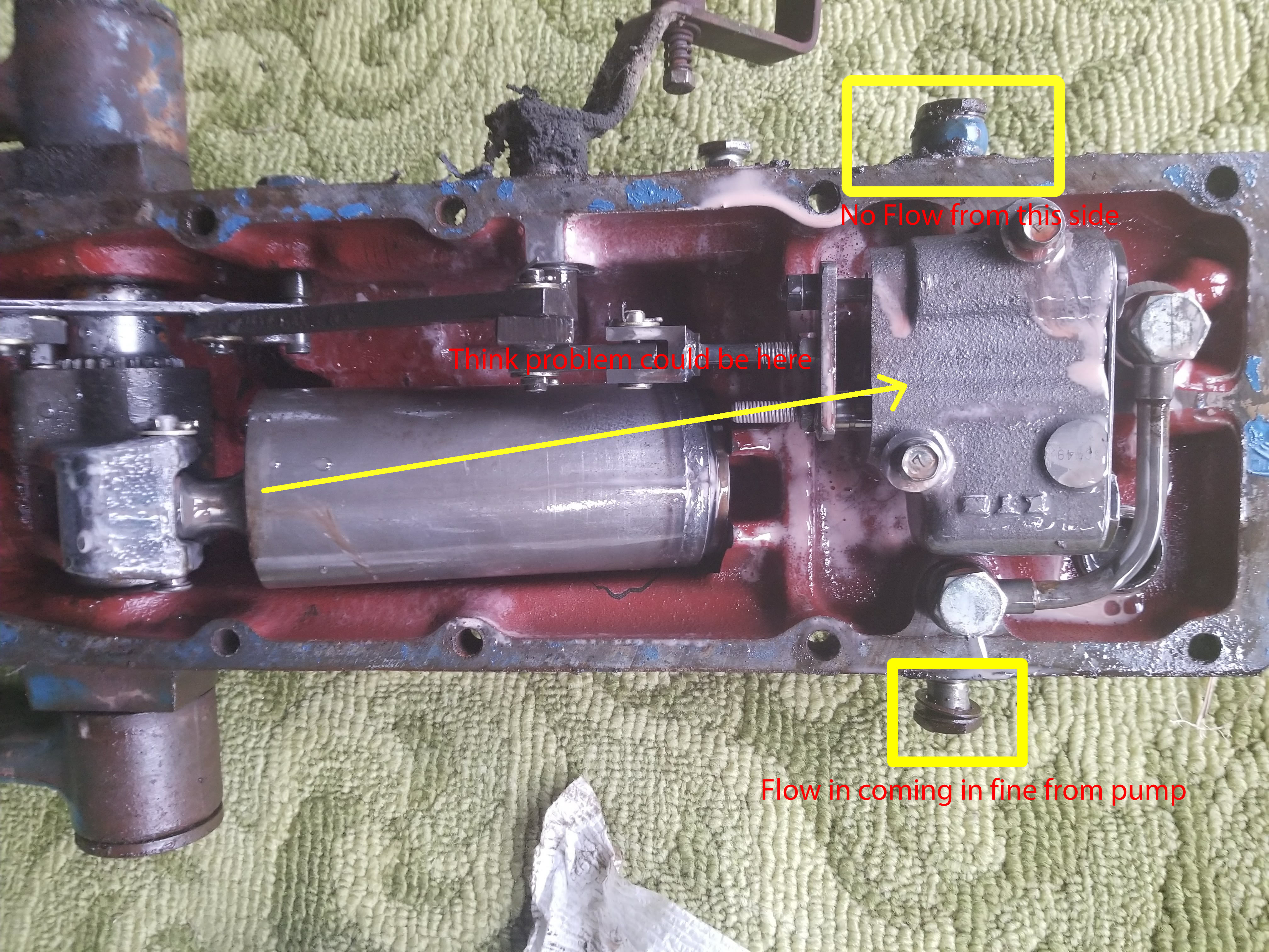

-Loosened hydraulic pressure (?) line, cranked engine...fluid came out fine. So I guess pump is primed and working.
-Loosened bolt on other side (feed to piston?), nothing came out.
-Tried adjusting control lever on top...nothing. I'm stumped. Maybe I need to remove top plate again check those valves because I am assuming hydrualic fluid should be going from left side (feed) to right side (goes to piston chamber?).
Thanks!

I also used an air compressor to make sure any hydraulic line was free. I am guessing maybe there is a stuck piston inside that valve chamber possibly? Any tips would be awsome as I am learning so much playing with Dads old tractor ;)
   / 80s Satoh Bull Tractor Hydraulic Problems
One last thing. Only thing I didn't check was a flat head screw that fit flush. I didn't unscrew it, but maybe this could be the culprit.2.jpg2.jpg

There is some O rings under the valve, if one is leaking it might not get pressure to the piston.
   / 80s Satoh Bull Tractor Hydraulic Problems #7
I too think you used the wrong oil. Likely clogged intake screen/filter for pump.

Well I changed out my hydrolic/transmission oil on my satoh s630d and used tractor supply universal 10-30 hydrolic.transmission oil, and it will try to lift but stops. just looking at manuel and it calls for 80 weight gear oil. I think i have found my problem.
   / 80s Satoh Bull Tractor Hydraulic Problems #9
Well oil not the problem, valve was stuck in the control , sludge and metal particles, guess i'll take control and piston apart and clean everything.
