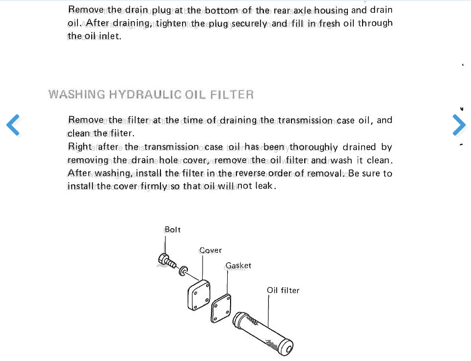

Good. Do some looking around for a cleanable filter in the sump. Often it is a tubular screen under a plate. Sometimes it is the plate where the fitting for the suction hose exits the hydraulic/transmission sump. Anytime water sits in the hydraulic oil it starts to form stringy clumps of goo which will clog the screen and prevent suction flow. Easy fix.

I found an operator manual online.
Page 52 shows the cleanable filter under a plate where the oil is drained. It will be 100 mesh Stainless Steel or brass screen. You can make one yourself or fix the old one if bent or broken. No need for new. Sometimes they get squashed putting them back in. Just do your best with it.
Then check the rest of the suction system. If it is sucking air, you it won't find an obvious leak when running because it is sucking air in but not oil is forced out. But then when the engine is off, what you see is an area or hose or fitting that is oddly wet on the outside with dirt and oil. That is your clue that it is it is sucking air there because when the engine is off and air no longer being sucked in it allows a few drops to backflow from the pump and they ooze out due to gravity & collect dirt.
If you see a hoseclamp on an old rubber hose, that's usually it. REPLACE THE HOSE.

Thanks Scotty. I'll drain the trans oil and fill with new Hygard and clean the screen as shown on p. 52 above. I will also try sealing up the ends of the suction tube. It does appear to be a little damp near the pump end.
