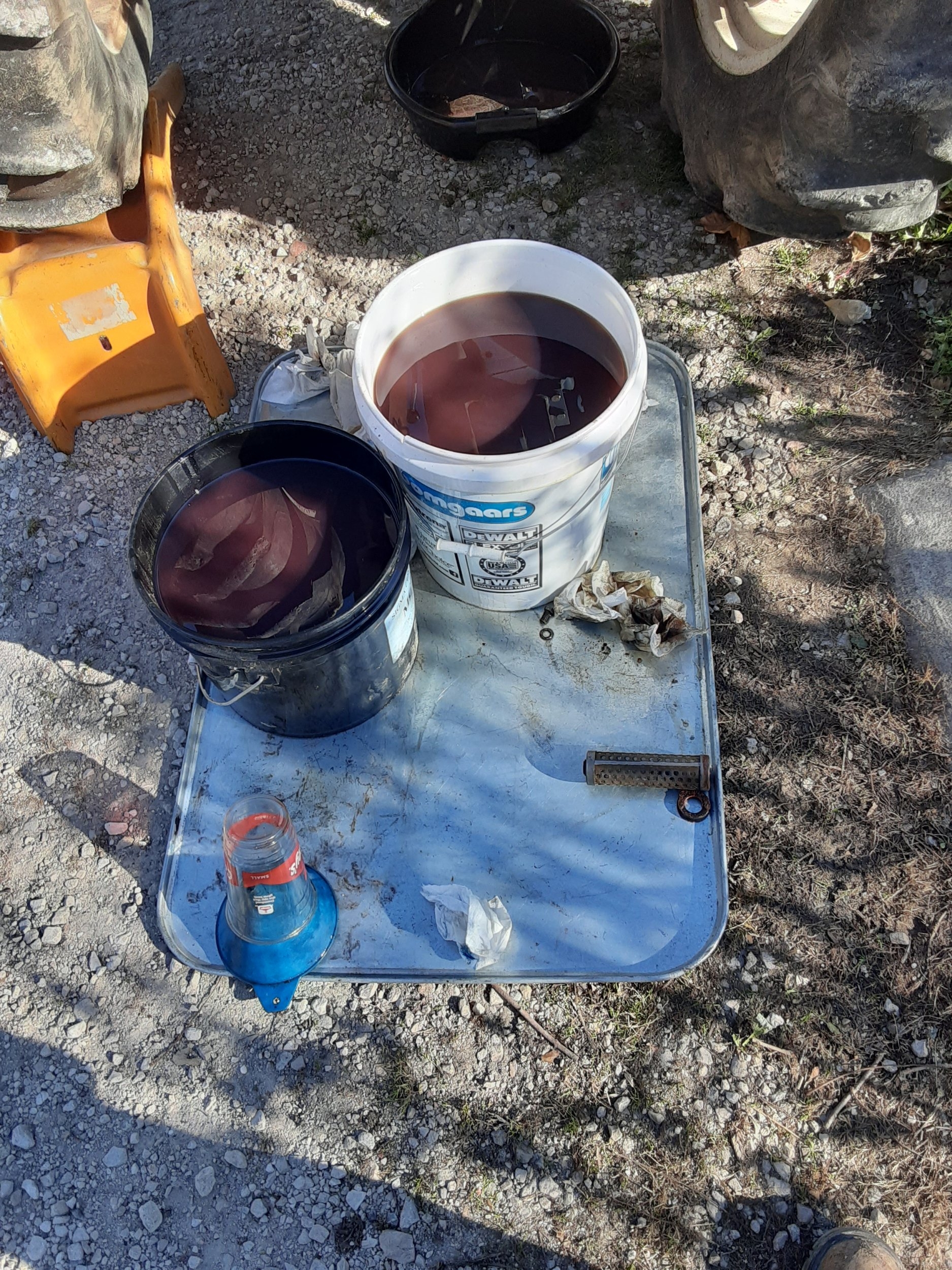

So I drained the fluid this weekend. Nearly 8.5 gallons and it was nasty brown like molasses with a rusty tinge. Definitely not what it looked like on the paint stick test. Had a little bit of green goo snot toward the very end, but mostly looks like a lot of dirt, rust, and maybe wear, although I don't recall seeing metallic particles coming out as it neared empty.

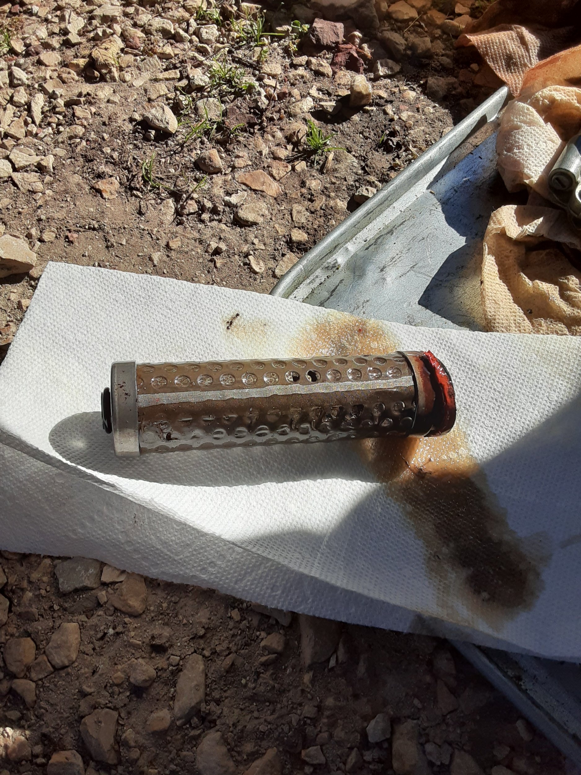

The screen has some bb and pee sized holes in it and the o-ring on the outboard end was held in place with red permatex, and there was no gasket on the cover plate, only red permatex, so I will make a red rubber gasket for it tomorrow. The outboard o-ring is a little deformed so hopefully I can reuse it.
I ran it for about an hour prior to putting one side up on jacks, so all the fluid would drain to the access hatch. You can see in the pix just how dirty it is against a clean white bucket.
I was unable to find any 200 mesh SS screen at the closest ace or in town. I was wondering if I could go up in size to 120 mesh, or possibly even 20, to improve hydraulic flow and have greater strand strength?
I would think that flow would not be an issue across the screen, with the several wear holes thru it, but then again it may disrupt flow if it's not a uniform, hole free, screen?

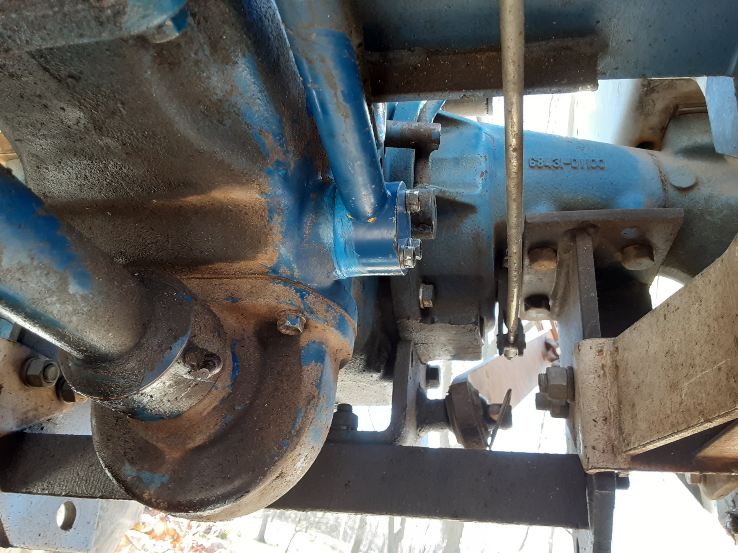

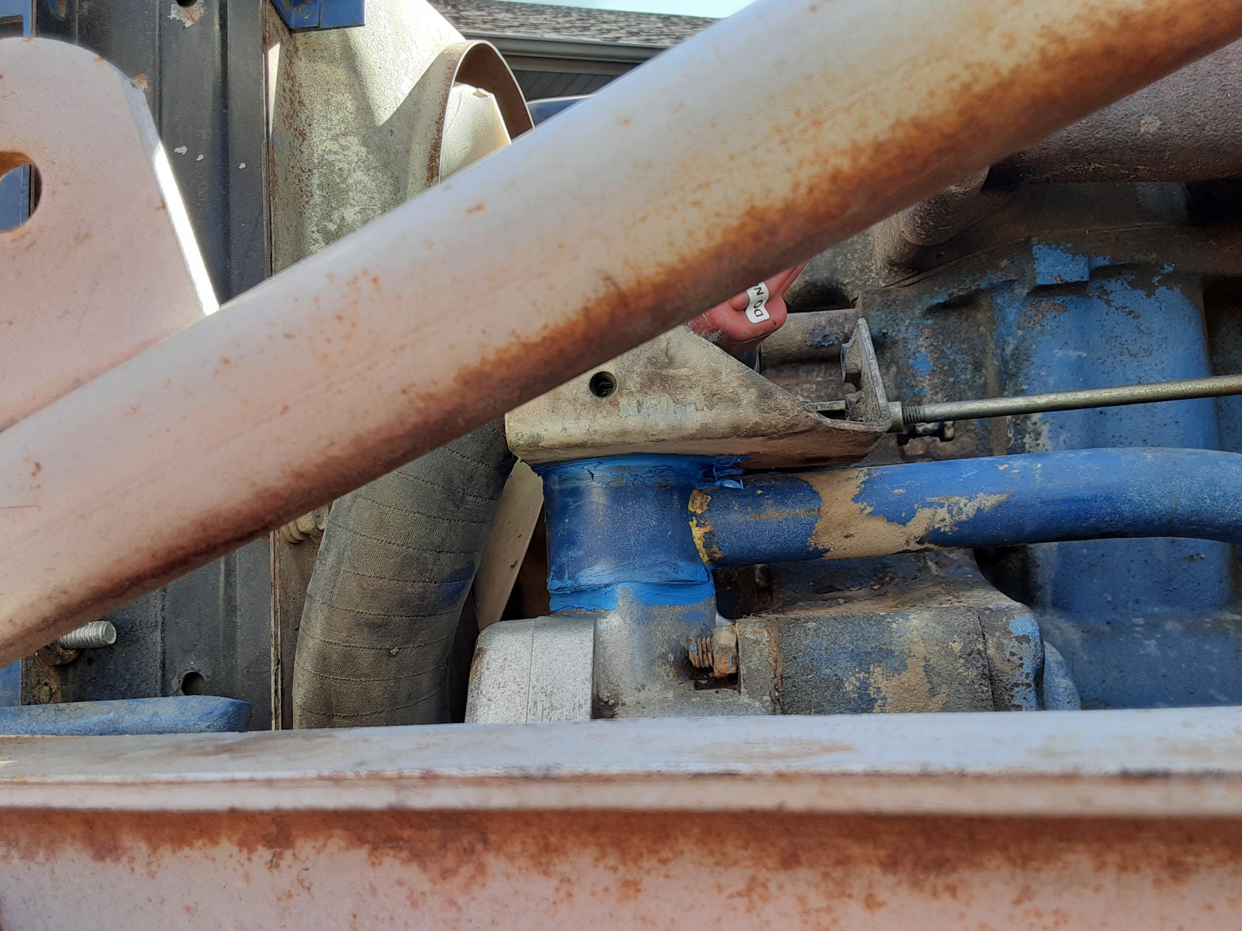

I also tightened up both ends of the suction lines and then cleaned and sealed them (see pix) with blue permatex. I got an additional full turn or more on each of the 3 rear suction line bolts at the hyd tank.
