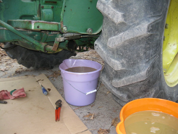

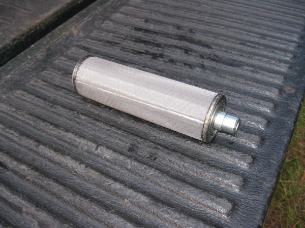

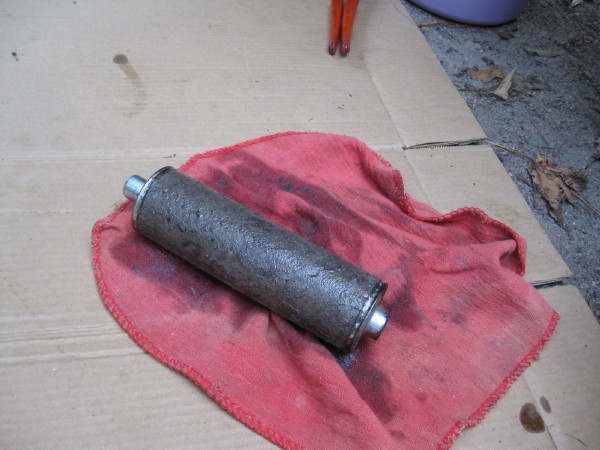

Yes, the two photos of filter screen says your fluid was dirty.
If that goop in orange bucket came out of your tractor, DO NOT put it back in for any reason, that is nasty.
The $45 shelf brand fluid will be fine as long as it says for John Deere.

OK, I changed out the hyd fluids and cleaned the screen. I contacted our local oil company, a company that deals with oils, blends, etc; they cross-referenced a hydraulic fluid equal to JD Hy-gard (in specs) with a MUCH better price. and the action is much more normal and responsive. I still am fighting it a little (I think my 6 ft is too much) but the 3pt seems more responsive.
A note about buying used equipment: as suggested here, purchase an owners manual and learn about the piece. Before, I have never considered a warm-up period for hyd fluids. or knew the function of the knob (under seat) or alotta other stuff on this simple little unit, but important stuff for the proper operation. Hopefully, I didnt mess around and overheat my hyd pump (by jacking around with knobs and valves) or something else stupid.
I think it was a clogged hyd system. and I'll keep you posted after a few days use.
Thanks yall.
