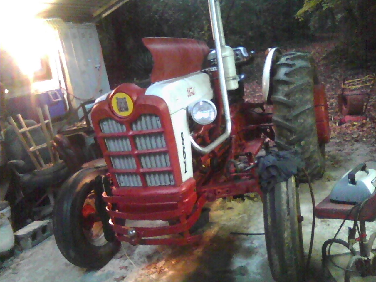

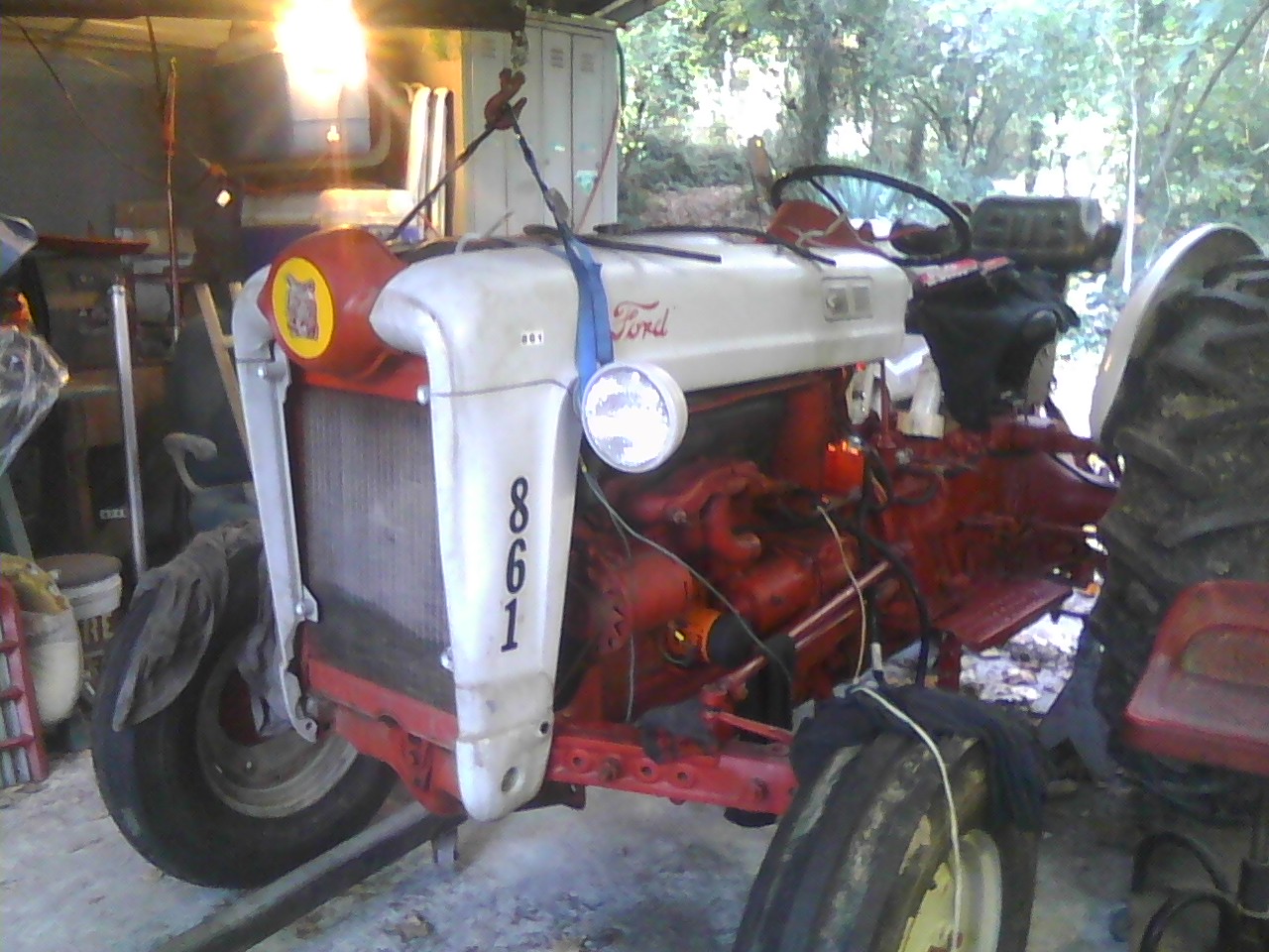

No test run yet, although I probably could have. I got the fuel tank bolted in. I had to push the bolt up against the front tank bracket with a long flat bar in one hand while I held a long wrench with 2 fingers turning the bolt to get that bolt started. I got my sheet metal on (that was tricky by myself) and hood (still got to line the hood up) today. Got my headlamps wired back up to the light switch. Decided I better put a couple pop rivets through my $4 Red Tiger emblem I found on eBay that is taking the place of the missing Ford cyclops medallion to keep the sticky tape from letting go before I hoisted that sheet metal in place. Repainted my front bumper (from my 8N) where I had rewelded cracks at the bracket that holds it to the axle. I ran the copper oil pressure line and some other electrical wires in plastic wire loom to protect them somewhat.
I plan to go out tomorrow and get some diesel fuel and new antifreeze. I hope to have the grill, shroud and bumper on tomorrow and install my battery. I also want to double check my clutch adjustment. I picked up an I&T manual a few days ago and while it is tiny compared to the other Ford manual I had, it gives several clear and easy to understand procedures that in my other book just seems harder for me to comprehend for some reason. I think the clutch is close, but I want to measure as in the description to be sure. Pictures and videos (like I have found online) make more sense to me than reading a thick manual.
It is starting to LOOK like the tractor it was.

Tomorrow should finish me up. I got my grill, grill trim, lower guard and 8N bumper installed. Also got the intake, oil bath air cleaner, and exhaust stack mounted. Made up 2 long bolts for my battery hold down and got the battery in.

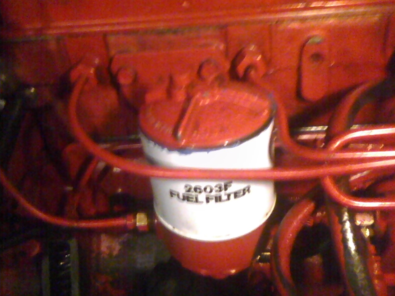

Bought fuel and antifreeze and filled up the fuel tank and as much antifreeze/mix as it would hold cold. readjusted my clutch freeplay but the peddle height was about right. Began bleeding my fuel system and whoa, I had a bad leak somewhere around my new fuel filter. Come to find out the top rubber gasket ring was not sealing to the filter, so I RTV the rubber to the filter. That cured that.
I could not find a bleed screw on the pump, but I cracked the input line and was good to there. The injector lines were still all loose, so I tried cranking the engine to see if I could bleed those. Well, although I had the battery hooked up to a China Freight trickle charger all this time, it was very weak and I had to get my big battery charger hooked up. After some time, the lines all show fuel dribbling out so I tightened them all down. I think my battery is really too small for a diesel. Moment of truth. After some more charging time, I tried cranking her up. Even the heaters did not let her fire up. I went to get my starter fluid, but I was out. Getting dark and cold, but I went to the parts store for some Starter fluid anyway. I was determined to get this to fire or blow something up trying tonight. First shot of starter fluid did not do anything. Tried another shot and I could hear an awful banging noise. I wasn't sure if it was starter fluid exploding or metal banging, but she eventually fired and sputtered to life belching blue smoke. Even with the open ends of my carport cover it was choking me sitting high up on the tractor. She wasn't exactly purring, but eventually she smoothed out to a steady rattle knocking as diesels are prone to do I suppose. My oil pressure was steady at 40 lbs. at idle. I never did race the engine much because I was waiting for it to warm up first, so I could top of the radiator fluid. I guess I'm too impatient because it barely began to move the temp gauge when I noticed a small puddle of oil forming on my right. I was not sure at first where this was from, so I shut it down to do a walk around. Turns out I was getting some splash from the rear hydraulic pump drive gear. It was cold and dark, so I stopped while I was ahead.
