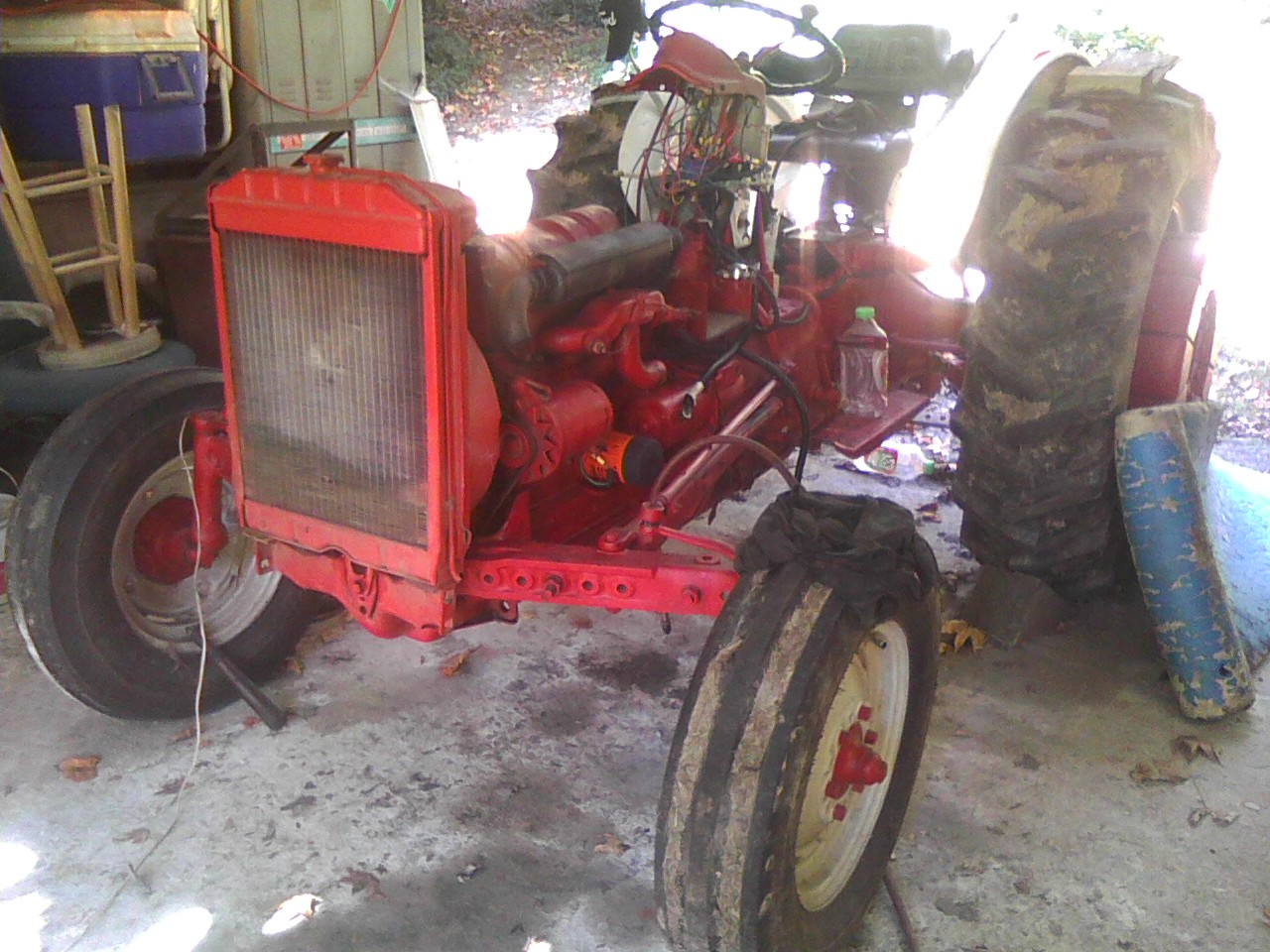

I got my radiator back on Sunday.

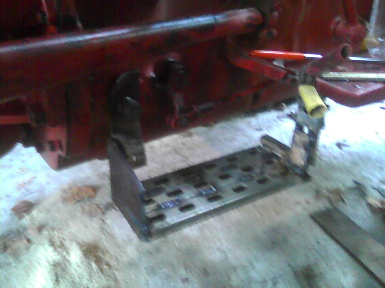

Monday I picked up an elbow at NAPA and some other stuff at Tractor Supply I needed. I finially put a new copper 1/8" oil pressure line on the tractor and filled the transmission with new 80w90.
Today I fabricated me an "old man" step for the left side of my tractor from some scrap I had laying around. My knees don't bend like they used to and this 861 is a couple inches higher than my 8N.
