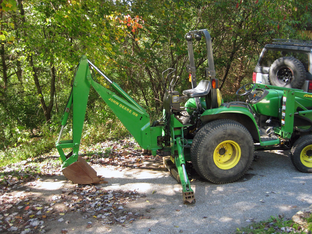

#112

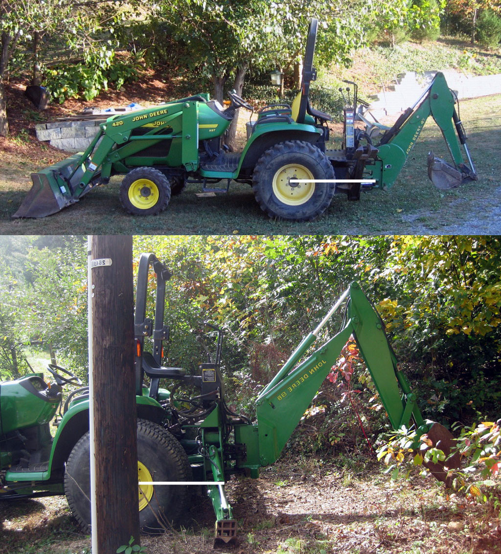

Thanks to avc8130 I finally have a mounting comparison between the stock 47 and my 8B. Looks like I might have done slightly better than Deere did. :D
   / 8B Backhoe On A 4200? #113
I think the turf tires larger diameter is creating an optical illusion. If you're adept with a decent paint program, you could cut and paste the turf tires onto the rig with the R4's to get a better comparison.
#114

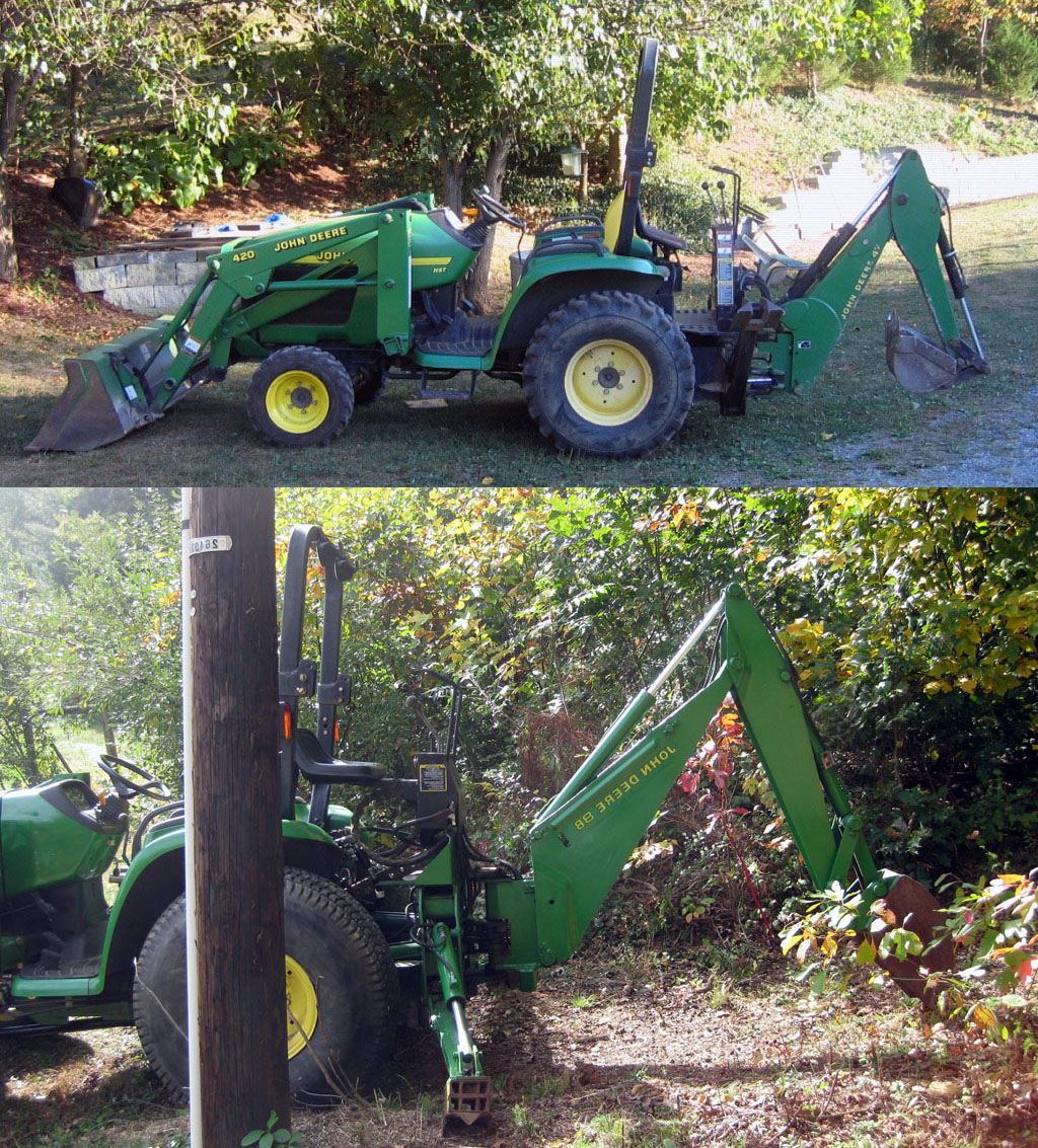

I was actually measuring from the center of the axle hub. See the new pic for what I mean.
How about this then.... my mounting isn't any worse than Deere's....
   / 8B Backhoe On A 4200? #115
I agree that the different diameter of the turfs vs. the R4s make it hard
to compare the mounts visually. Of course, the 47 is much different than
the 8B, too.
It DOES look like your departure angle is better for the 8.

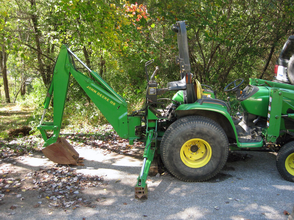

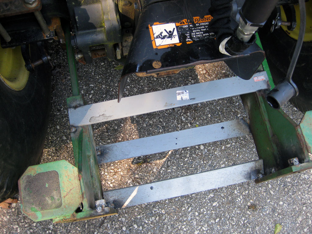

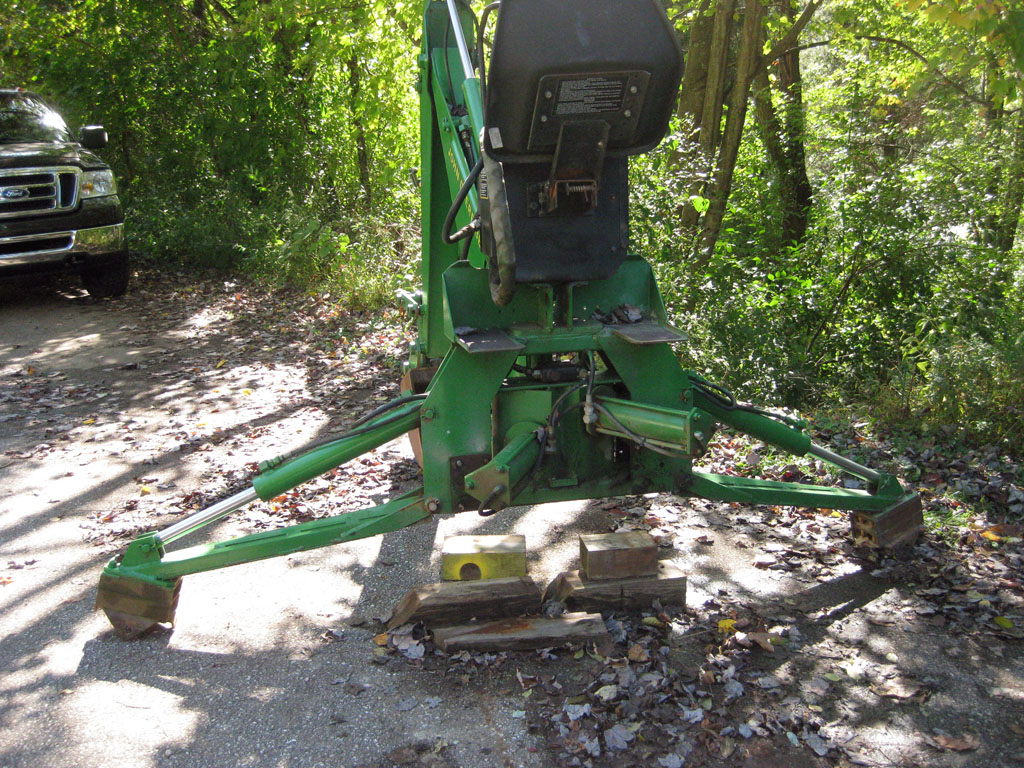

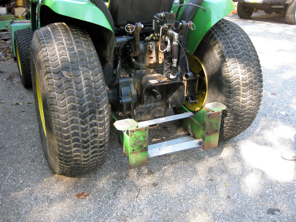

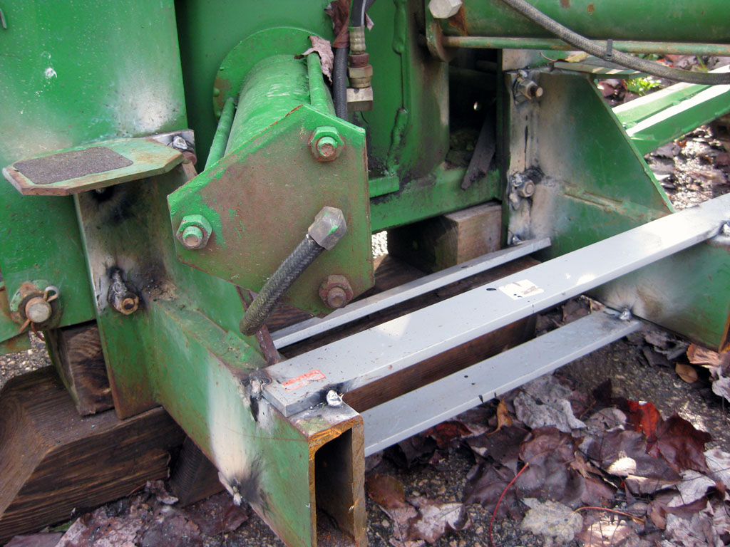

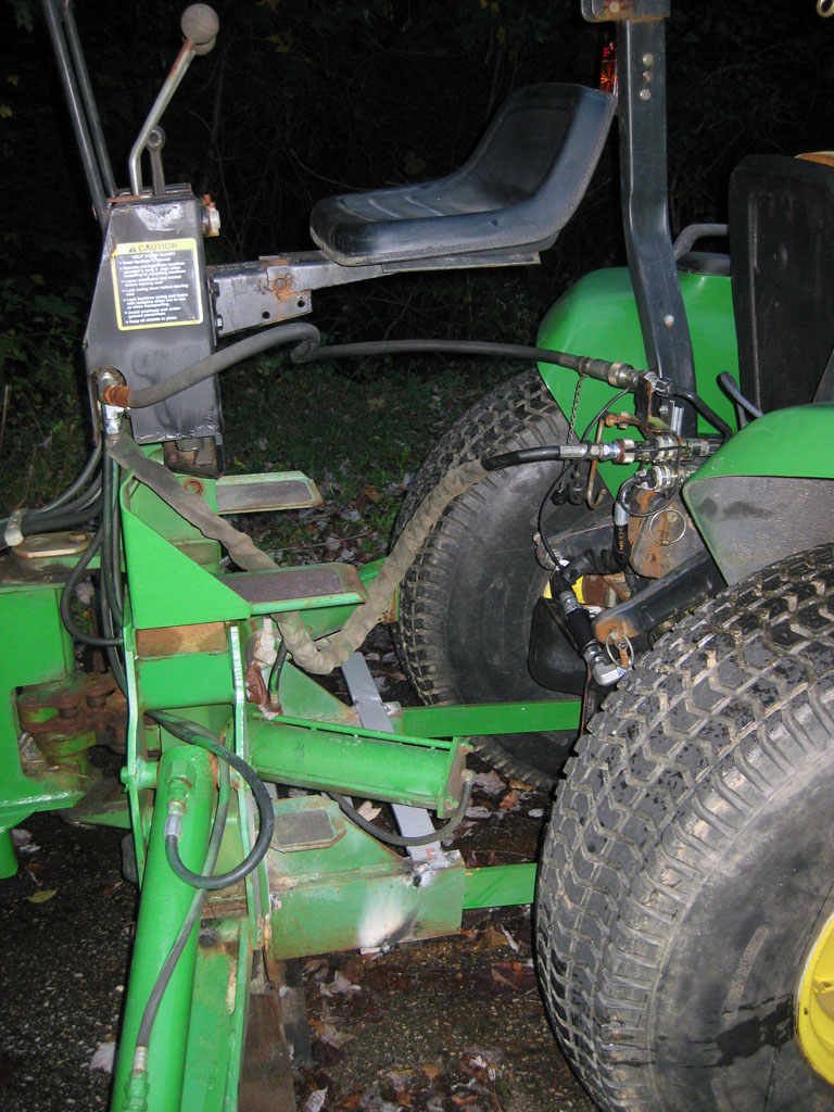

   / 8B Backhoe On A 4200? #117
More of a rhetorical question cause there is soon going to be an 8B on my 4200. Picked it up Wednesday. And I removed all the brackets from the 970 tractor it came from too. The "leak" is from the fluid coming out of the connecting hoses. Too late to reposition them not to do that.
The 8B specs out in between the 47 and 48 weight and strength wise while utilizing the same hydraulic specs. This is unlike the 7 hoe which take less hydraulic pressure to operate and is much weaker than the equivalent digging depth 47.
I figure since the 42/43/4400 frame can handle the weight of the 48 hoe I can install a few hundred pound lighter hoe that still digs deeper than the 47 and costs a good bit less on the used market. And since I need to build a subframe for it anyway, I might as well have a hoe that came with half the subframe already there.
I'm probably gonna keep the brackets in case I need/want to sell the thing, but the plan is to copy the mounting design so that the hoe uses the same JDQA method as originally intended, and blend the design with dfkrug's subframe mount for his 4300.
You can also see how we pulled the UHaul trailer out from under the backhoe by strapping it to my offroader's bumper.
