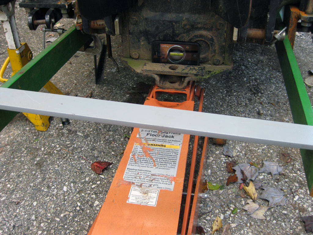

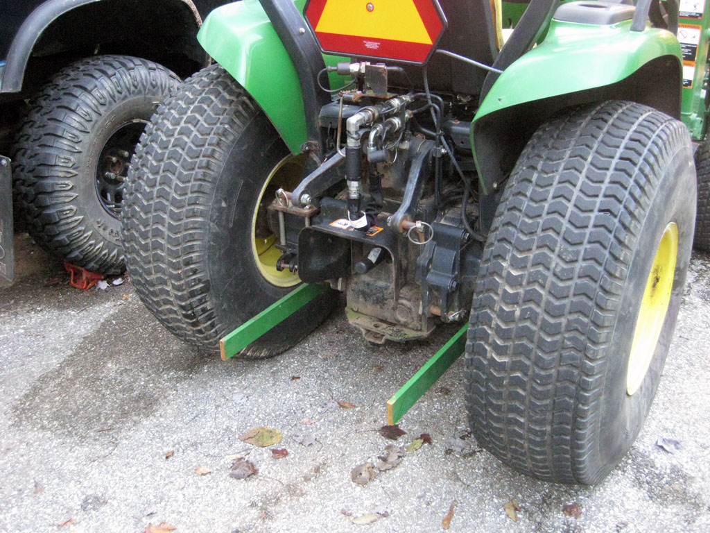

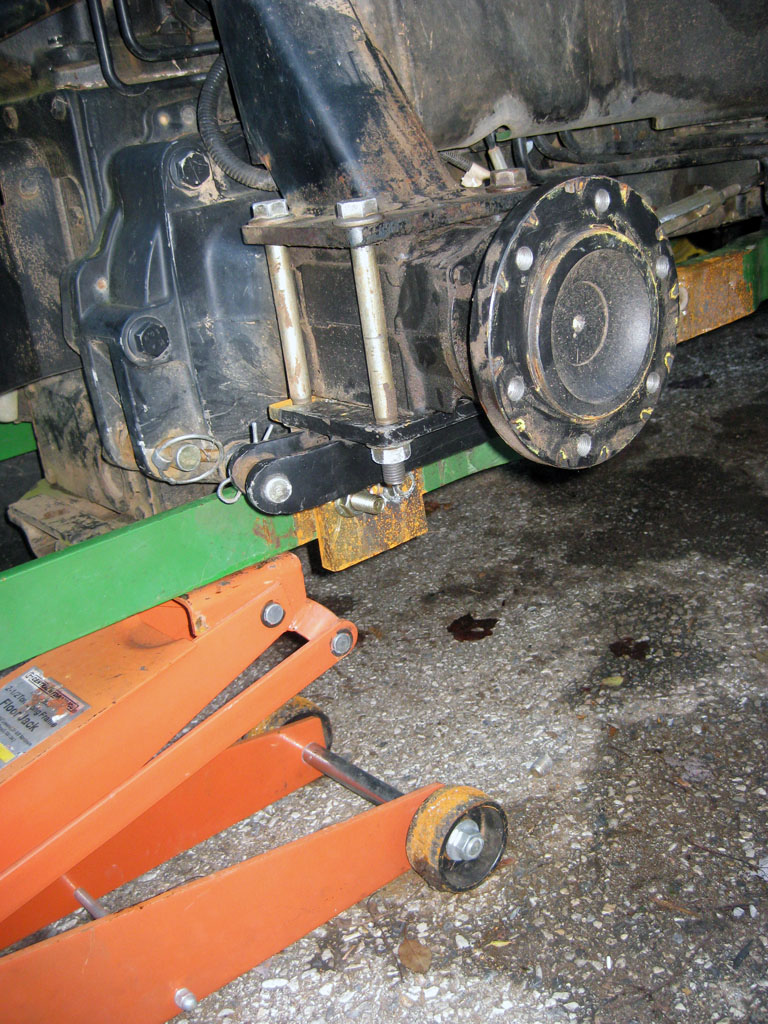

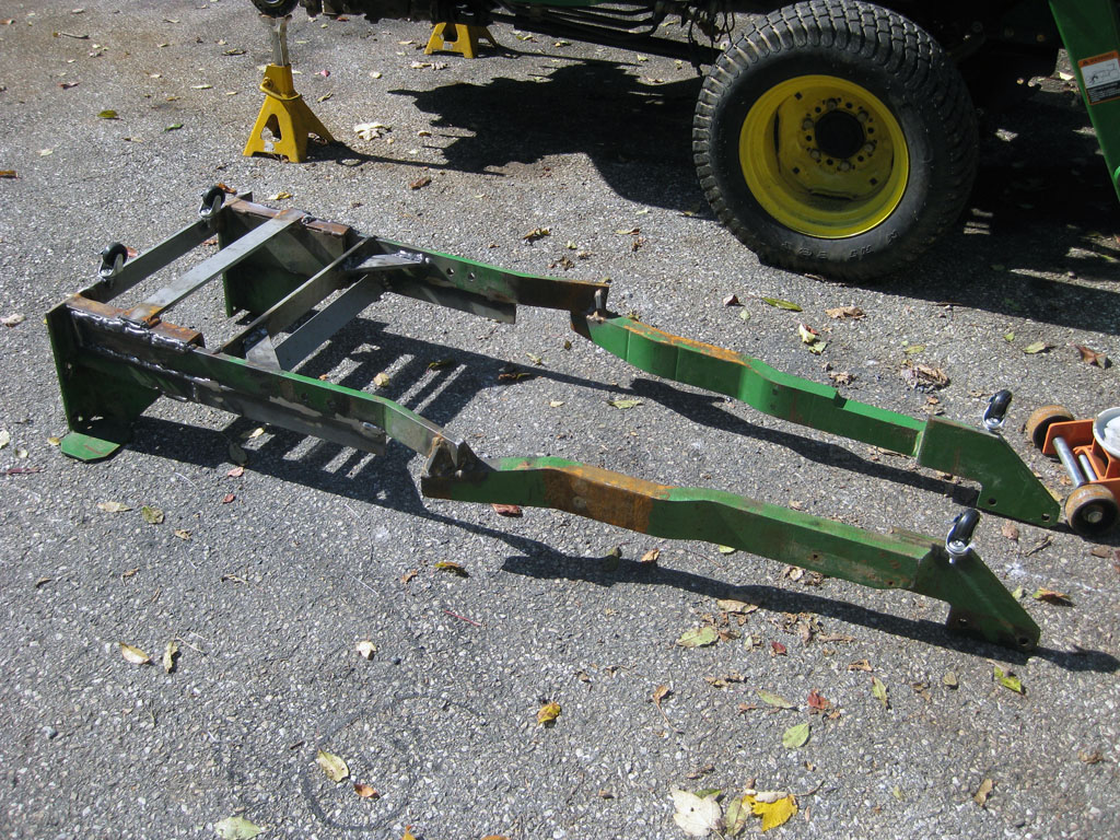

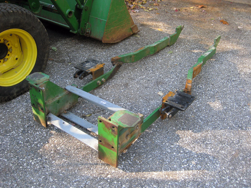

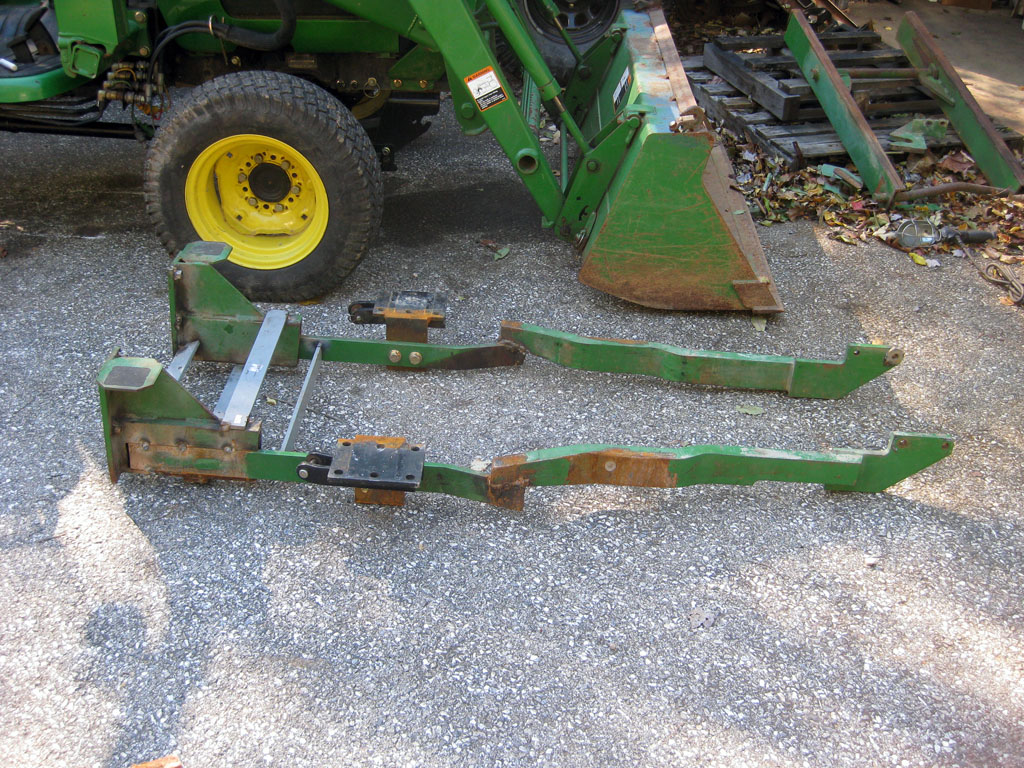

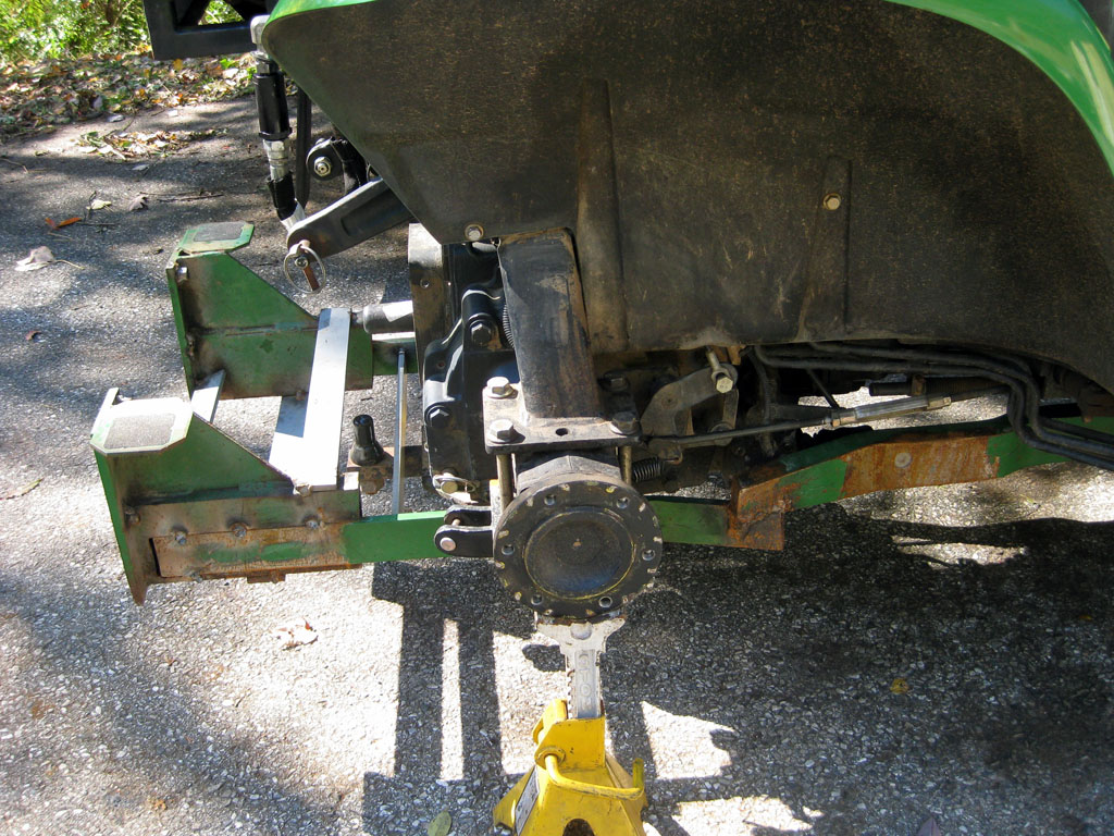

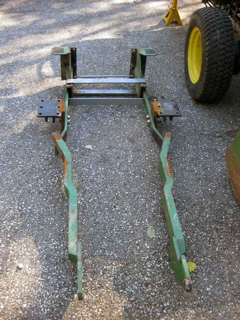

Some minor progress.... This is the entire subframe. I'm going to reinforce it and complete all the welds and it will be ready for paint.
So an interesting consequence of installing the backhoe popped up. My one rear tire has always lost air slowly. Due to dry rot I'm pretty sure. The extra 1000# of the backhoe really sped up the pace of the air loss and so the tire sat without air pressure for a couple days. Now there are sidewall cracks. Can I just put a tube in it until the tire disintegrates naturally or is this tire just done?

/ 8B Backhoe On A 4200? #92

That frame is lookin' good, Arrabil!!
As far as the tire...well, you're going through all the work of pulling the tire off (your tires are filled, aren't they?). If you have the bucks, may as well replace it.
Anyway, you property is pretty sloped. Do you want to chance that tire coming apart when you're on a minor side slope?

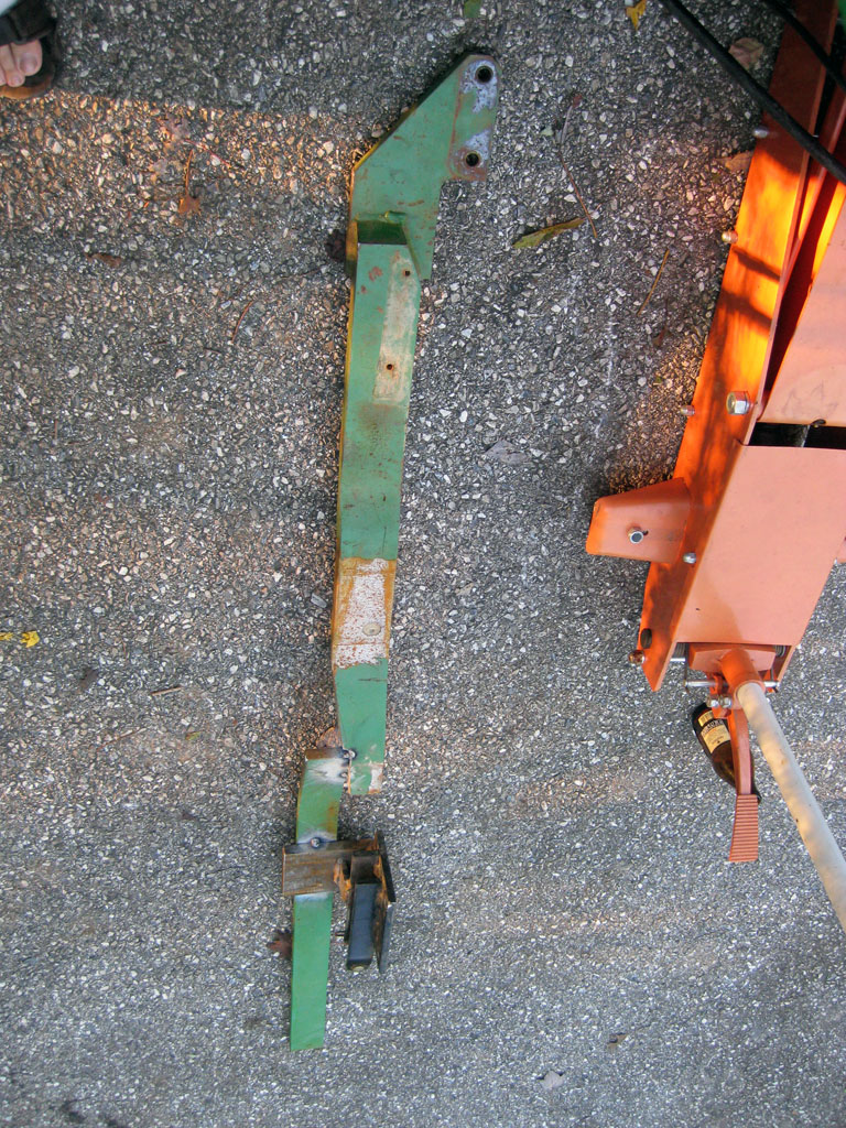

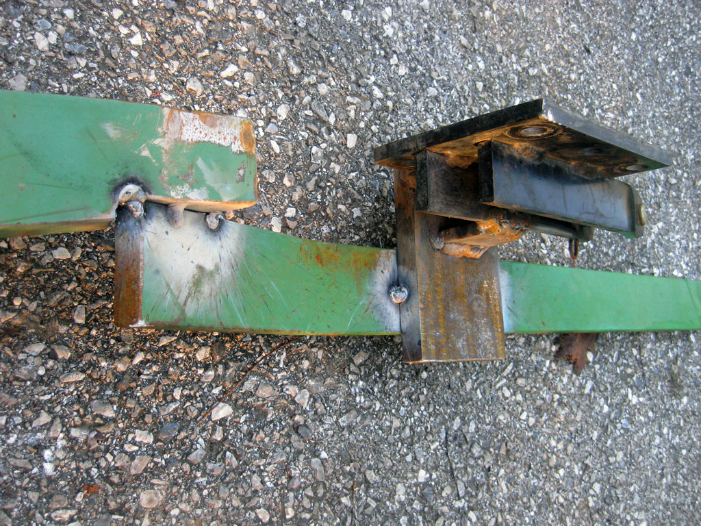

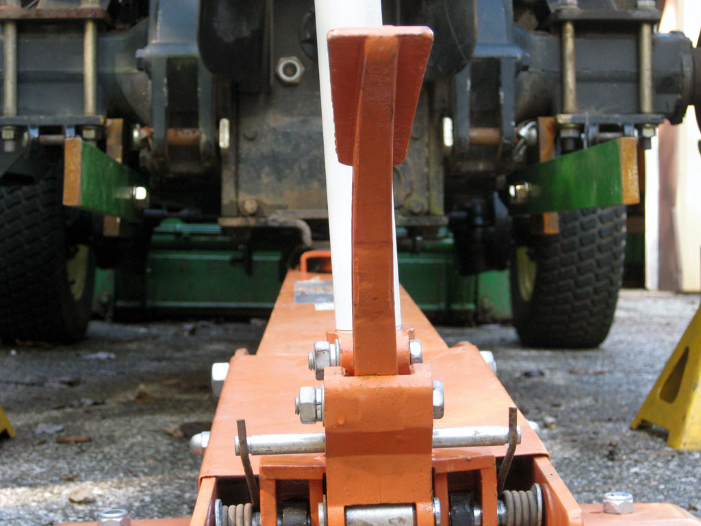

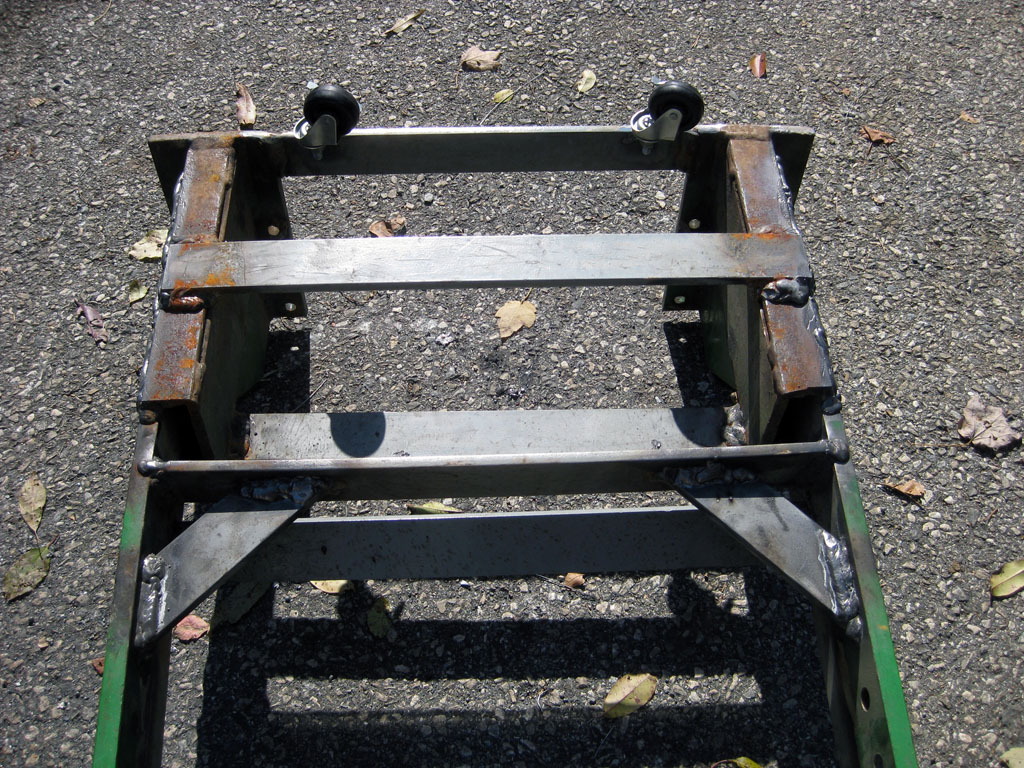

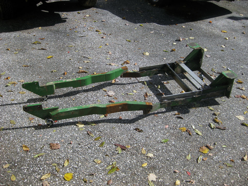

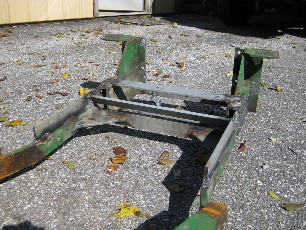

The sub frame is built. Prep and paint is all thats left. Gonna call a guy I know about sandblasting and powder coating it on the cheap (hopefully).
I added some casters. They help a LOT in moving the thing around and should make it easier to line up for installing too. They're threaded stem casters so they can be removed after the subframe is installed. I was thinking of making them flip-up but decided against spending the time on it.
