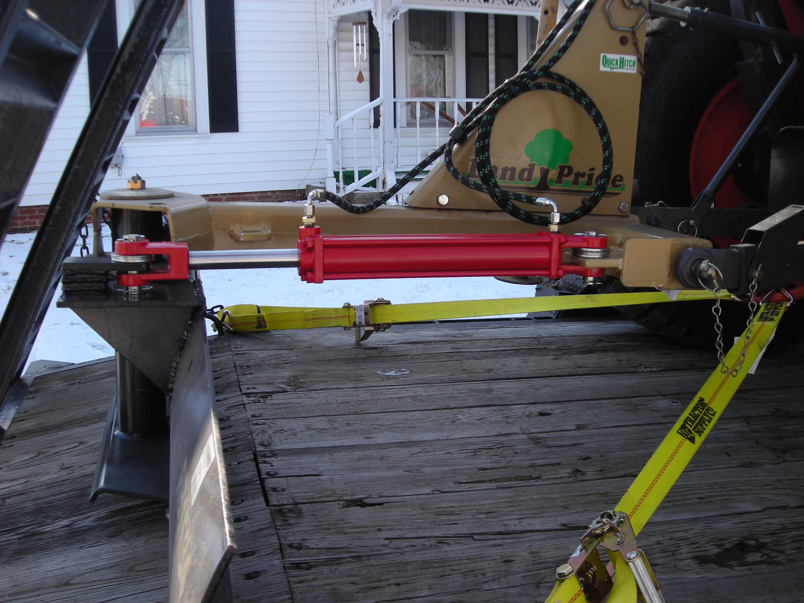

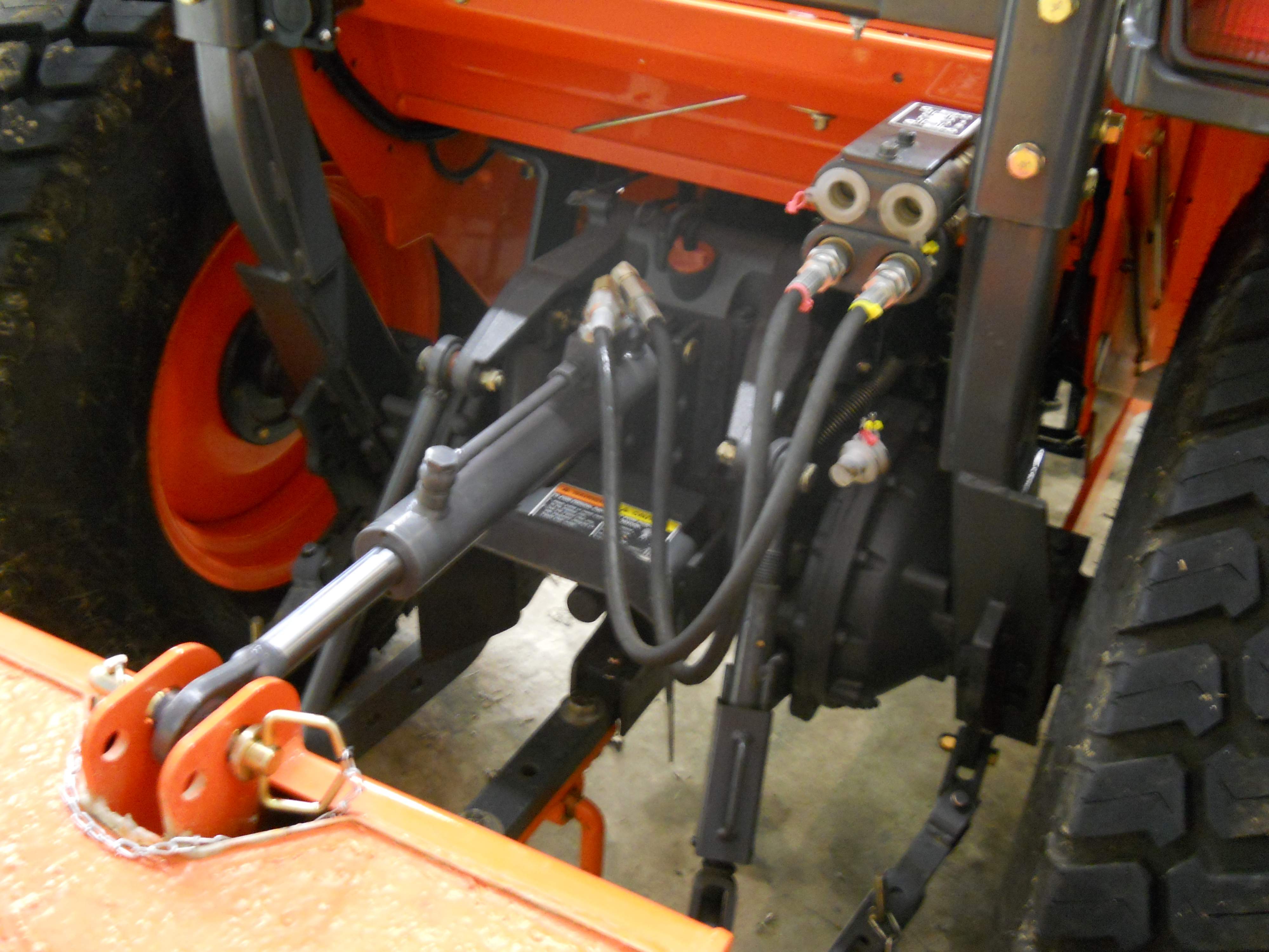

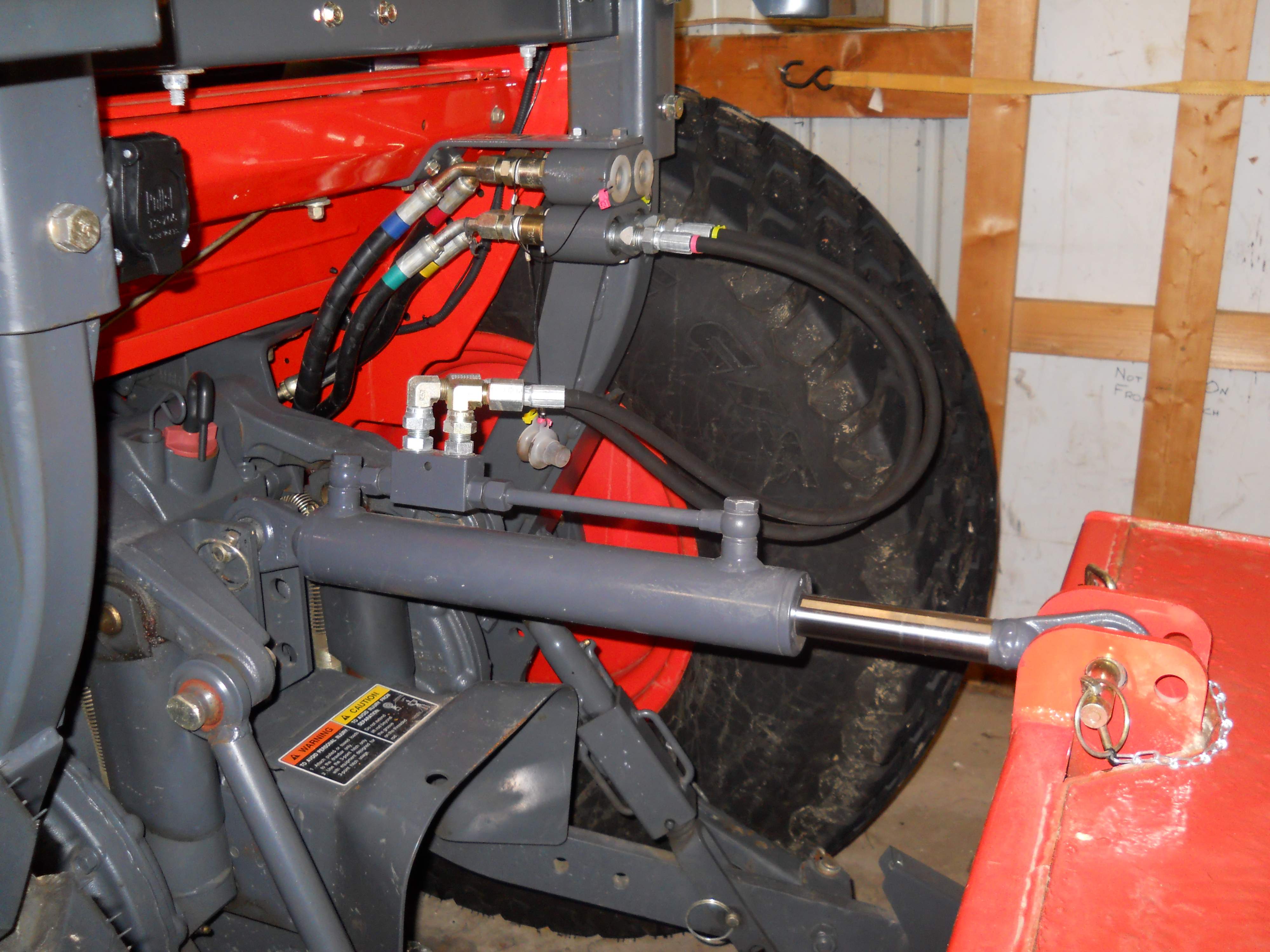

A hydraulic top link is manditory. Got mine from CCM, not sure if they are still in business, but there are others that do the same. Side link is optional, depends on what you are doing. Do you have rear remotes installed already? I also added a hydraulic angle to my blade, that was more important than a hyd side link to me. Philip.

Can someone give me a little help on putting a hydraulic on the blade...I'm looking at a Grizzly cylinder 3x8 with 2500psi. Is that enough?

I think a 3x8 is going to be WAY too small.
For starters, the stroke length is too short. In order to be able to pivot at least 45 degrees each way, you are going to have to mount it pretty close to the center pivot of the blade. This makes the lever action of the blade over the cylinder MUCH greater.
A longer stroke allows you to mount farther away from the pivot and allow for less leverage effect. Because angling the blade is cake. It is being able to hold it there that becomes the issue. And that can be overcome by using a larger diameter cylinder, and/or lessening the leverage effect.
A quick look on wood's website shows that on their comparable hydraulic blade, they are using a 3.5" x 16" cylinder.
   / 8Ft blade on MX5100? #38
I think that most of the OEMs use either a 3 1/2" or 4" dia cylinders and for your 8' wide blade you should be looking at a 14" stroke. I need to order one of these for myself for my landscape rake. You will; have a tough time of it with only an 8" stroke. If you want to wait, I can ship one with your top link. Probably around $200 with all the shipping and what not. ;)
