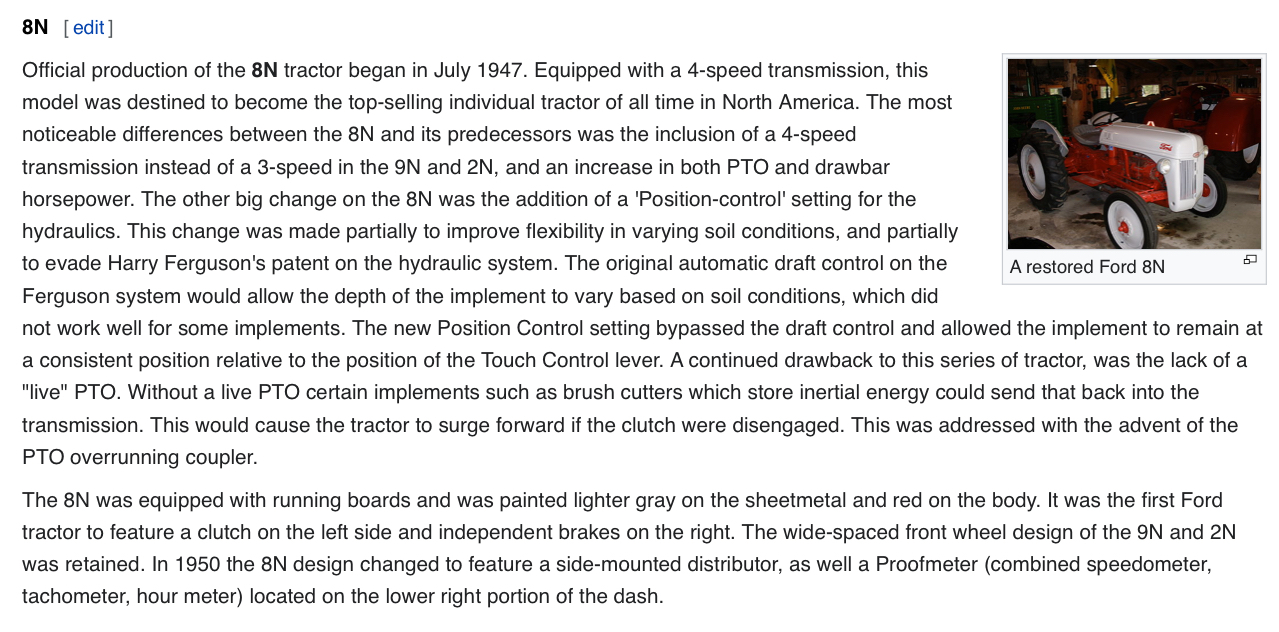

8n didn't come around til 1948. So if it is indeed a Ferguson/N-series hybrid.....it would be a 9n variant if your date is correct.
Along the way, someone may have replaced the engine.
Or it could just be a Frankenstein tractor all together. Could have originally been a 9n that someone busted the rear axle and dropped a to-20 axle on.....then later on blew an engine and swapped with a 8n engine.
