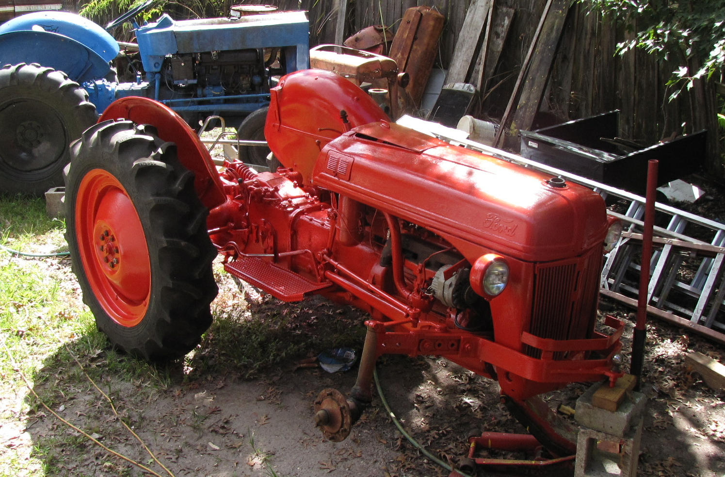

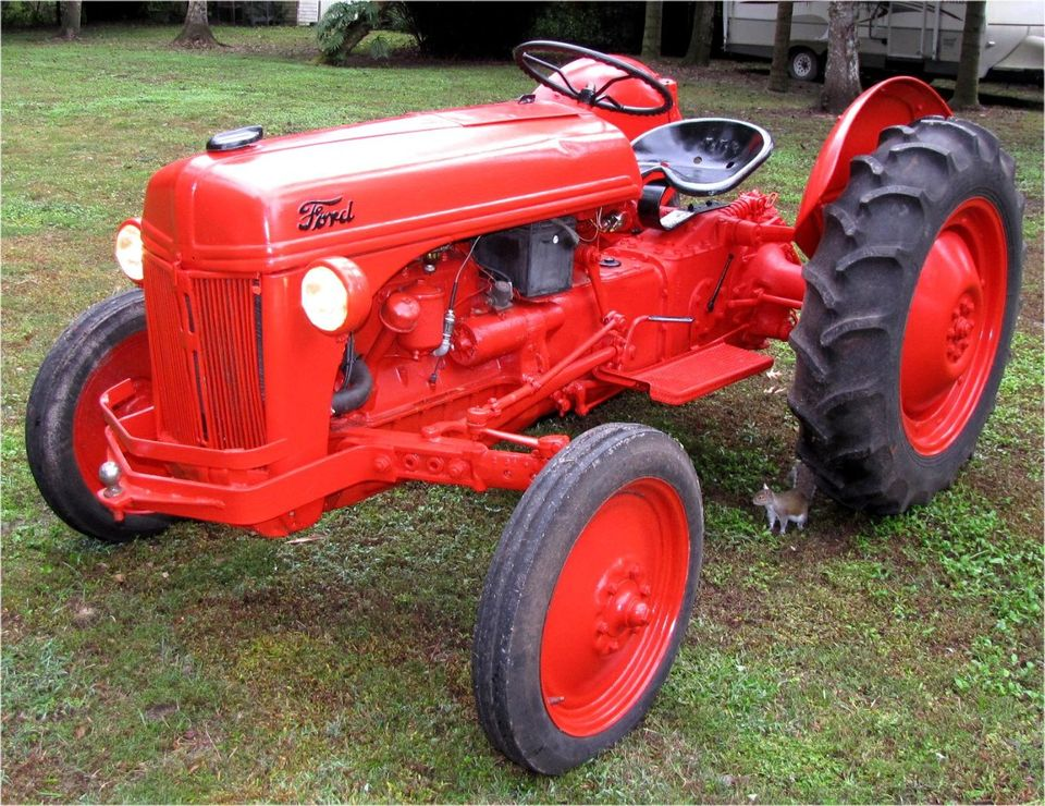

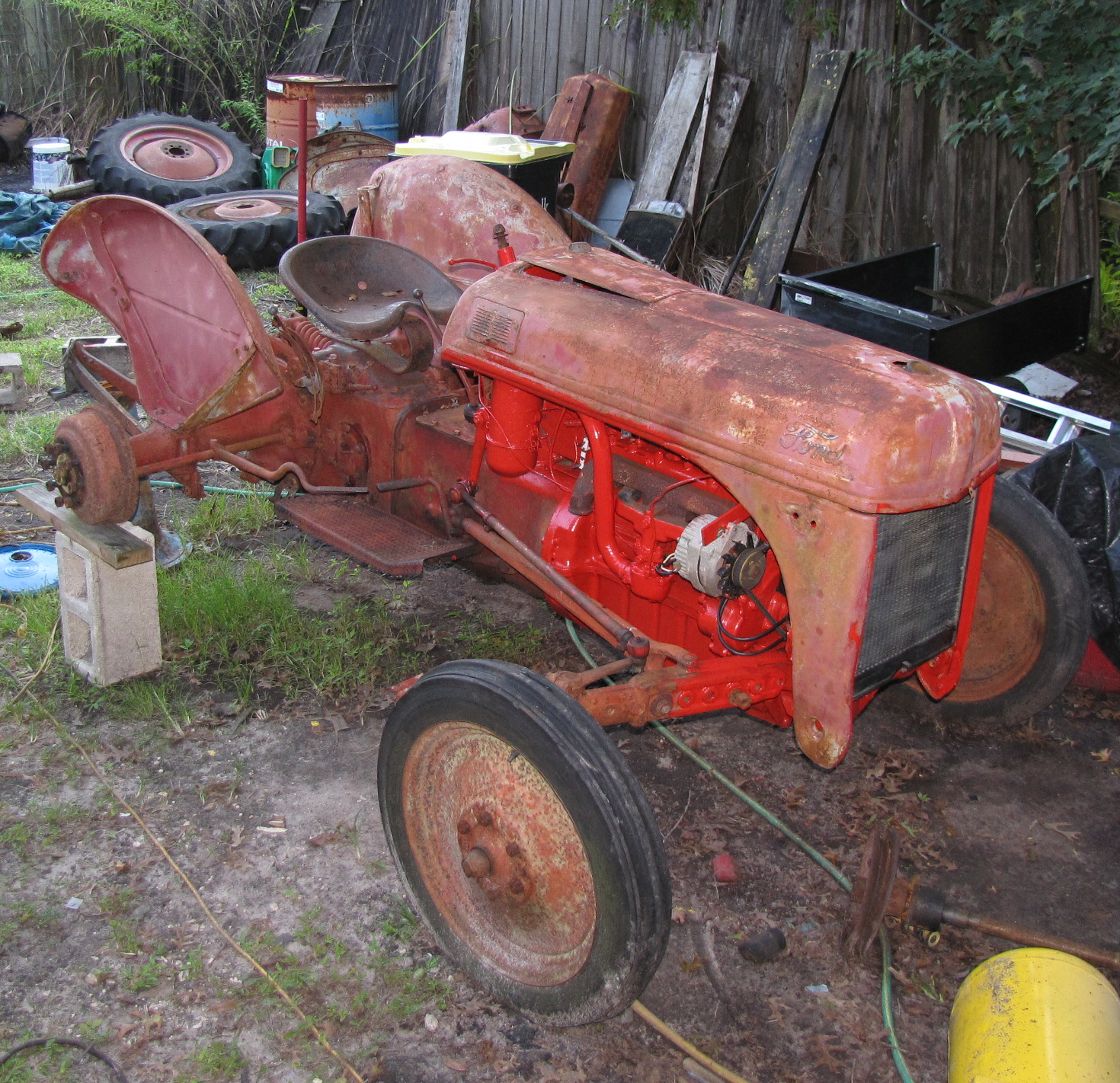

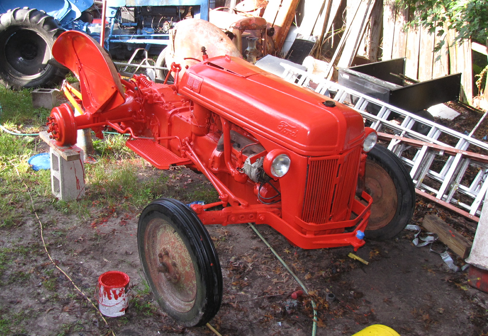

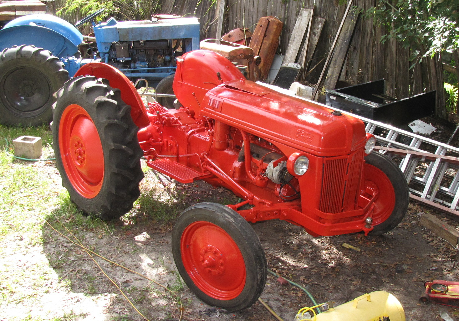

I've built a few old tractors. A couple back I started taking pics and I thought I'd post them if anyone wants to see them.
If there's an interest I have one or two more that I took pics of.
This one's an 8n

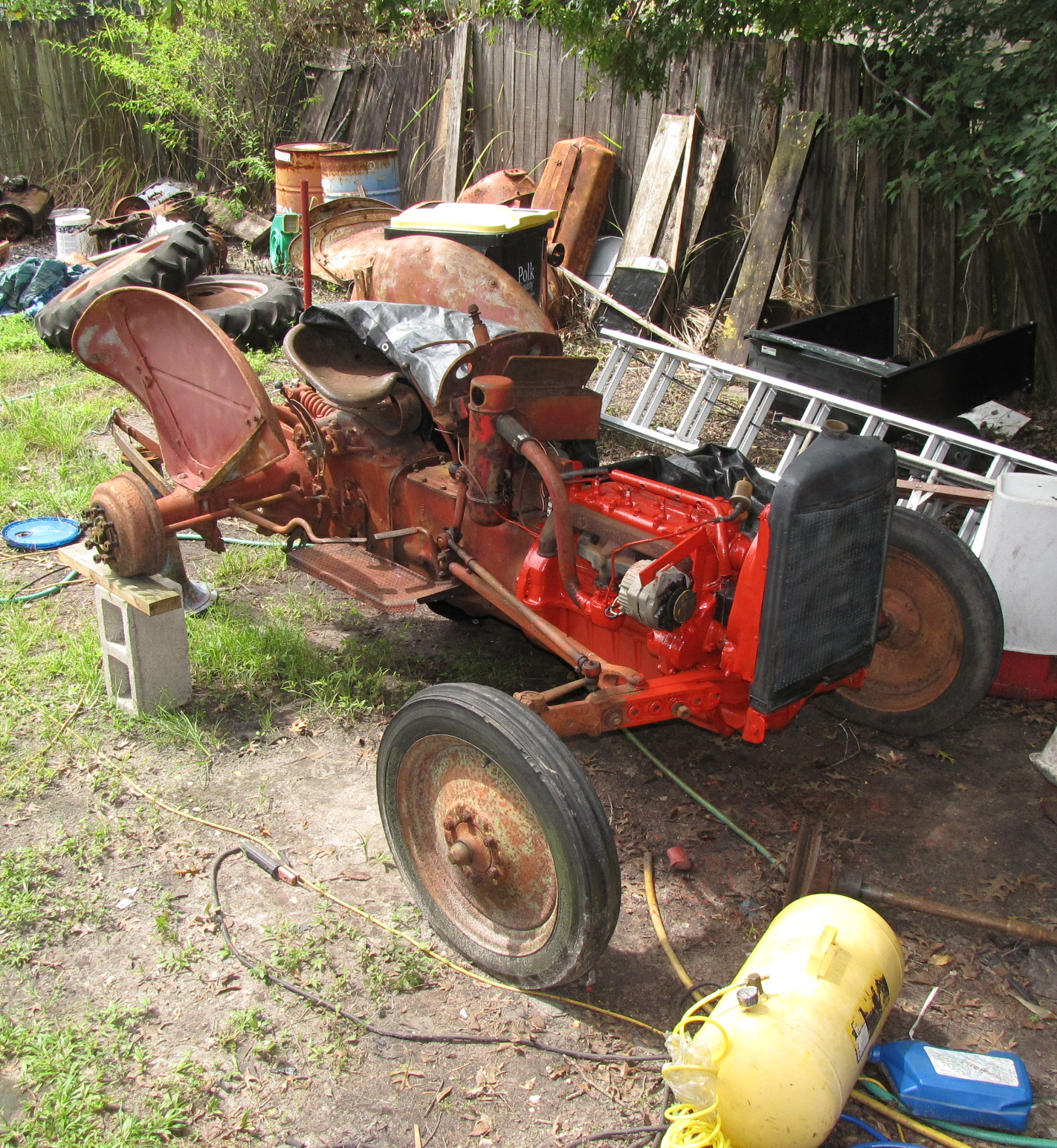

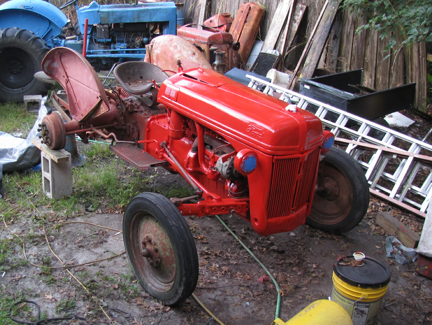

When I got it, it ran but only had 2 gears because the top cover was wore out to the point that it got stuck in 2 gears at the same time which shattered one of the gears.
This was where I started taking pics. After the tranny repairs and after I had already started painting. I know it's the wrong color but this is the colors it wanted to be.
The squirrel is narla. She's my little helper but she often gets in the way.

Saving old tractors is a GOOD thing, true it is not the traditional color but it's your tractor paint it whatever color makes ya happy.

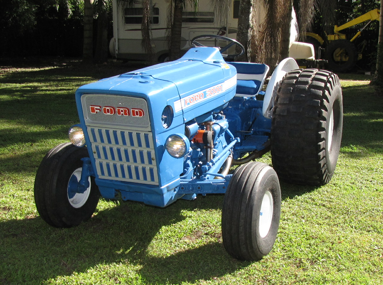

One problem with the thousands series is the stupid modern instrument panel. They never work. I usually cut holes in the dash and put the old mechanical gauges in. Otherwise the 3000s are pretty good tractors.

I've only replaced one (it was one of the china ones) and it didn't go well. And then one thing I really couldn't deal with was the fact that the thousand series have an oil light instead of a gauge. I got to have gauges. I wont even buy a car that doesn't have gauges. I like to know what the pressure and temp is so I know ahead of time that something isn't right. I wound up putting in seperate gauges even after putting in a new cluster.
