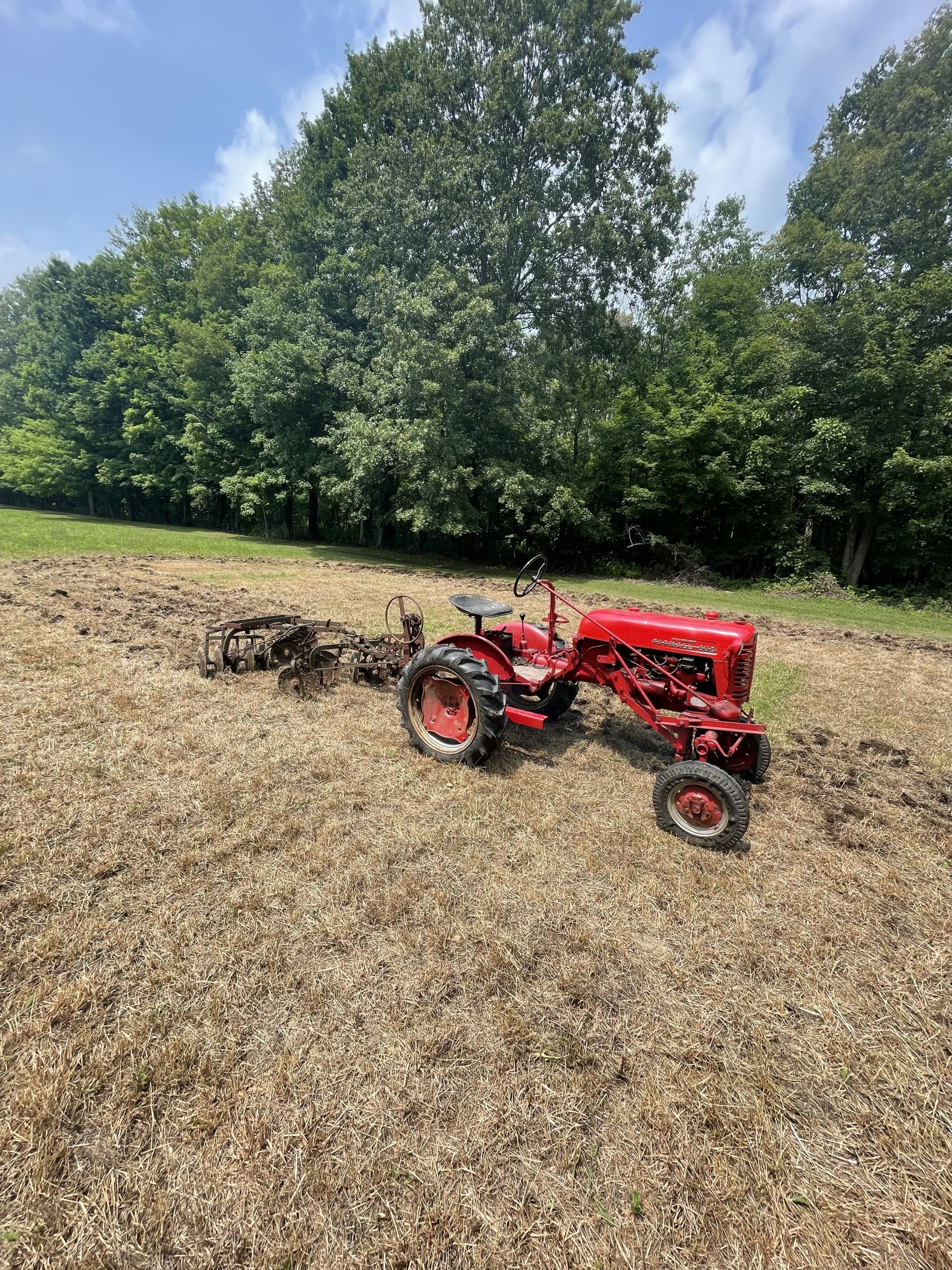

I couldn’t believe how easily my little 10 hp Farmall Cub handled my dad’s 6 ft Bissel pull-type, set at the most aggressive angle:
It didn’t take too long or two many passes to churn that ground up to almost a powder.
