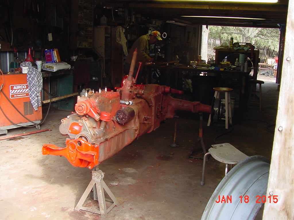

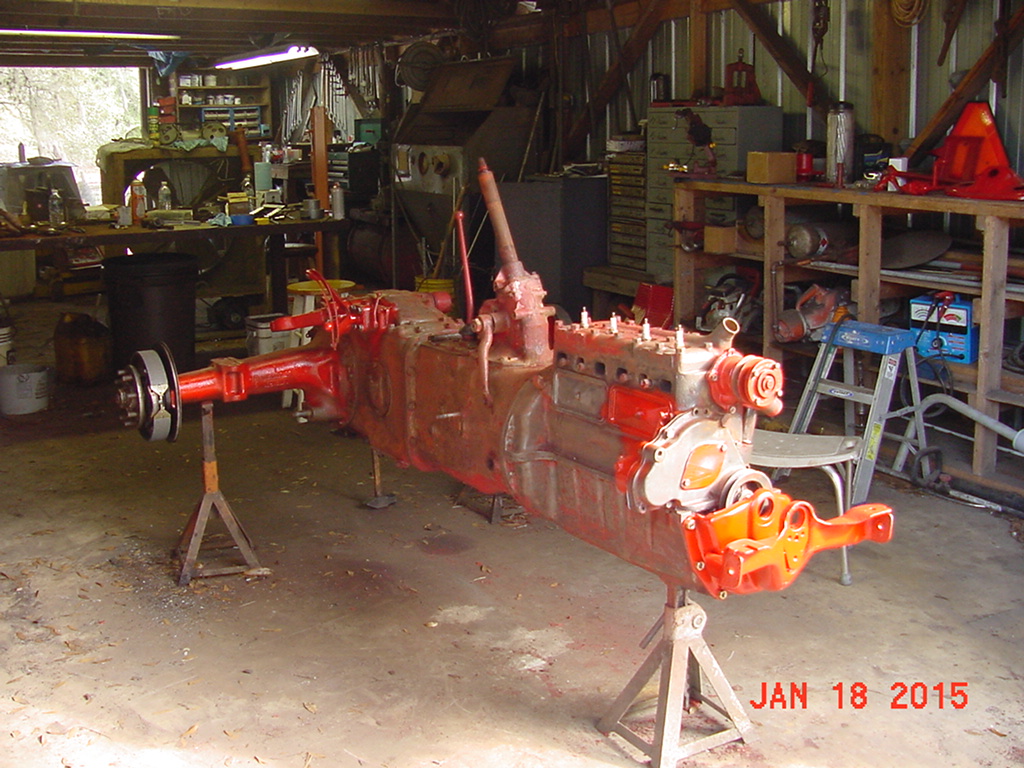

Got the pin out in the press, with lots of heat. It really protested, but it came! Son welded new ends on the lower lift arms and sleeved the non-adjustable rod between the upper arm and lower are. It had been broken and patched quite crudely. Looks great now. Got the bushing out of the axle center. Had a good day.
I think one more day wire brushing the tractor itself, and I'm ready to start on fenders, hood and wheels. DSC00001.JPGDSC00002.JPGDSC00003.JPGDSC00004.JPGDSC00004.JPGView attachment 407321DSC00008.JPG

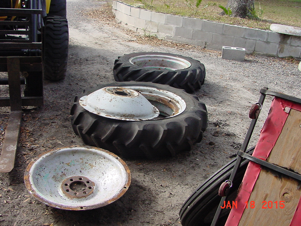

Been having trouble with the camera, doesn't always want to recognize the memory stick. When it does work, I take too many pix. I think I finally got all the wire brushing done on the tractor itself, time to set up the little outdoor sand blaster and start on the wheels. The "new" wheel isn't as pristine as I thought it was. It's been sandblasted and painted, but has some pitting around the bead, so I'm gonna re-blast it and try some 2 part epoxy to bring back a better surface. Haven't got the tires off the other rims yet, have to take them to town. I know one of them is shot, the other looks pretty good from the outside.

Putzed with that rim all afternoon! It was blasted and painted when I bought it, thought I was gonna improve on it. Must be epoxy paint on it, sandblaster doesn't hardly touch it. Lots of runs that I knocked off with an abrasive pad. Painted a section inside with 2 part brushable gel coat see if that smoothes it out a little.
