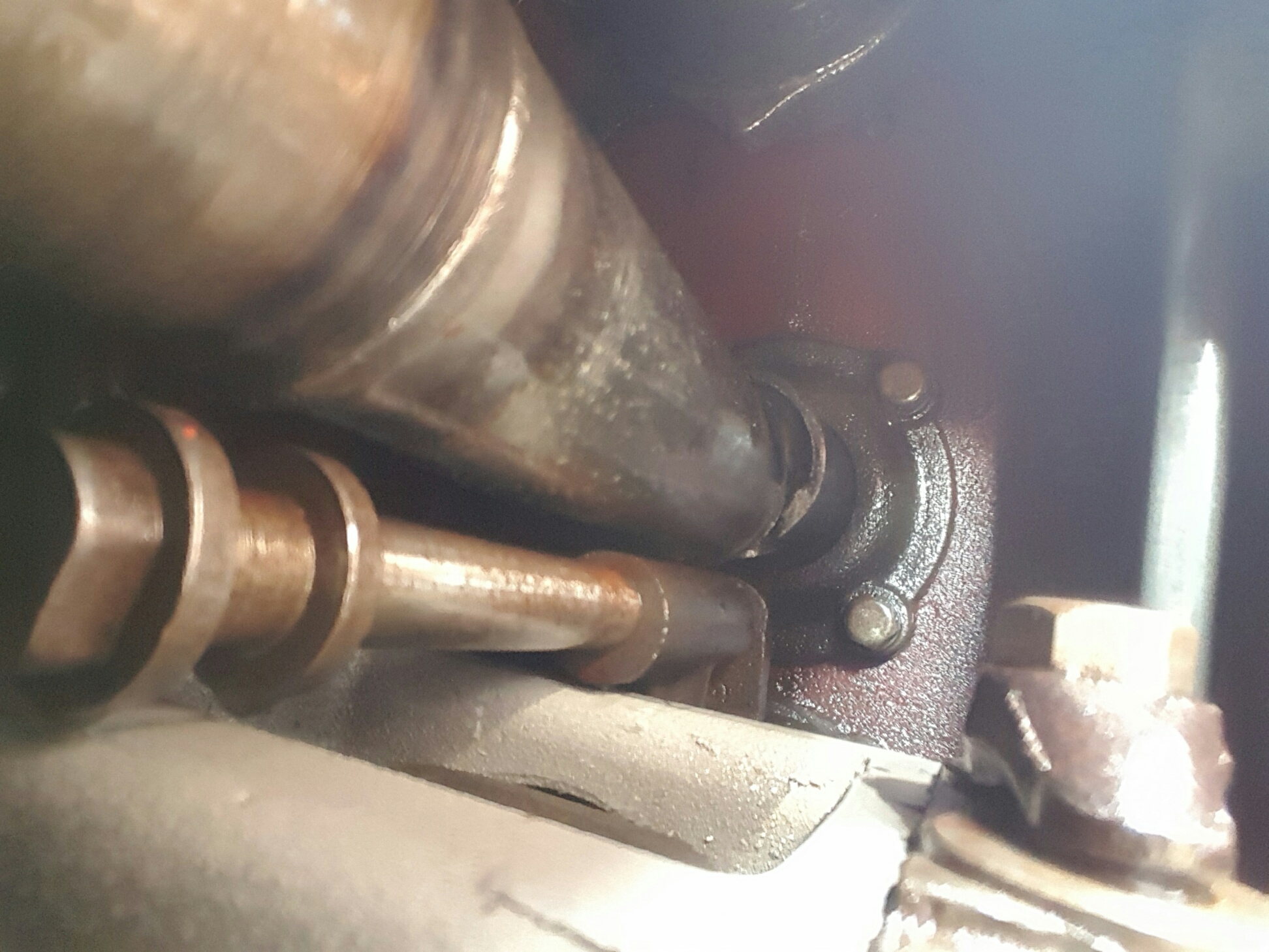

/ 8n wont move?
this is looking to the front of the tractor
/ 8n wont move?
what do you call that shaft its broke at the transmission?
will it slide through that bearing? or will i have to pull the transmission apart?

/ 8n wont move?
#12
Wasn't to bad getting the tractor a part. It was transmission to pinion shaft.

/ 8n wont move? #13
ok, so it WAS the hollow coupler. original picture made it look like the mainshaft end snapped.
not bad.. just a rear split to slap a new one in!
