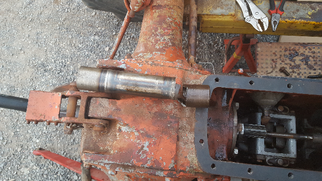

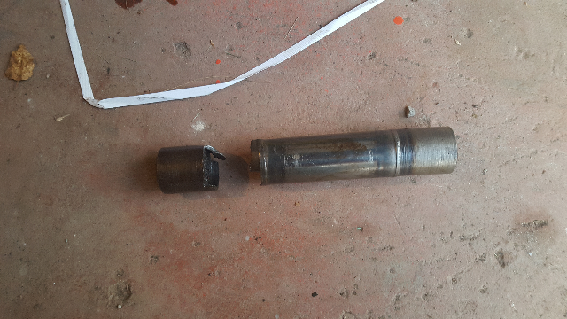

Aug 31, 2015 / 8n wont move? Thread Starter #12 OP kool cat Bronze Member Joined Oct 29, 2012 Messages 56 Location Marlbank,ont Tractor Kubota 23s Wasn't to bad getting the tractor a part. It was transmission to pinion shaft. Attachments ForumRunner_20150831_230751.png 420.9 KB · Views: 161 ForumRunner_20150831_230845.png 509.9 KB · Views: 150
Sep 1, 2015 / 8n wont move? #13 Soundguy Old Timer Joined Mar 11, 2002 Messages 51,575 Location Central florida Tractor RK 55HC,ym1700, NH7610S, Ford 8N, 2N, NAA, 660, 850 x2, 541, 950, 941D, 951, 2000, 3000, 4000, 4600, 5000, 740, IH 'C' 'H', CUB, John Deere 'B', allis 'G', case VAC ok, so it WAS the hollow coupler. original picture made it look like the mainshaft end snapped. not bad.. just a rear split to slap a new one in! I know where you can get one for 25$ plus postage.
