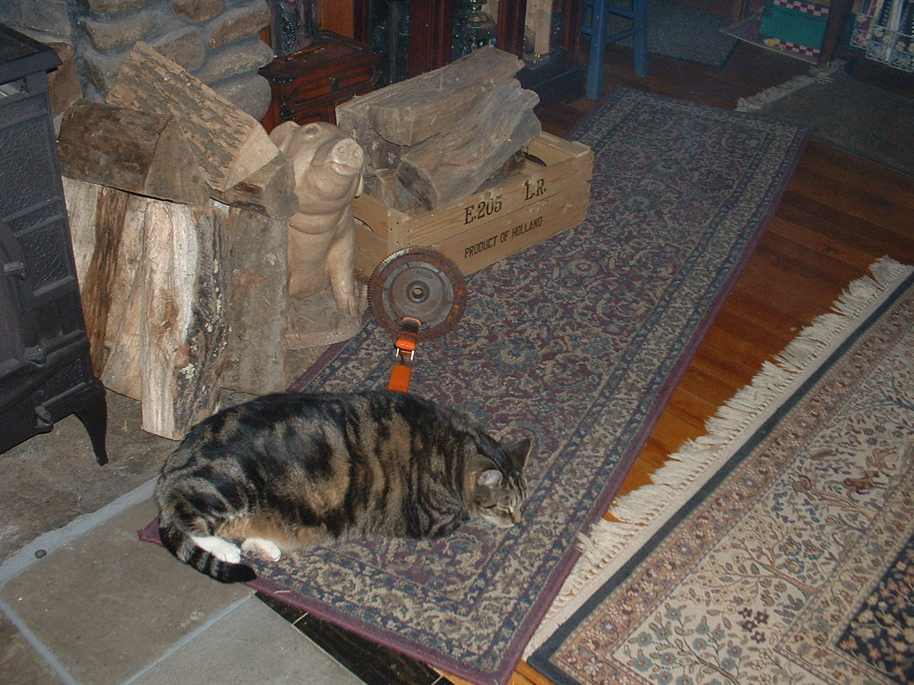

Hey all, have the magnet back in place now, used two part epoxy and have it clamped up by the woodstove for the night. (See attached action shot).I am assuming that its the correct flywheel 'cause its the one I took off and it sure doesnt look like anyones ever been into this old girl. I have the carb back off and apart to make sure I have all the passages clean and clear. Tomorrow is supposed to be fairly unpleasent - rain/snow/ice mix - so I figure I'll put it all back together in the a.m. warm and dry in the shop, and then go freeze on the tractor cleaning up whatever mess we end up with from the storm. I'll let you know how it goes, Rick

Not to beat a dead horse, but, those magnets on the inside of the flywheel look like they're associated with a charging system. In your picture, there appears to be a light spot on the outside of the flywheel and that would be where I would expect to see an embedded ( frequently riveted) magnet as part the magneto. On some of their older engines, Tecumseh did have the magneto coil underneath the flywheel. I just don't recall the flywheel magnet configuration being like that one is. Could tell more with a picture of what's on the engine under the flywheel.

I hope putting your snowblower parts near the heat dosen't disturb the CAT!!!

By the way, not a whole lot disturbs that cat (ironically named Dog).....he's got it made and he knows it.
