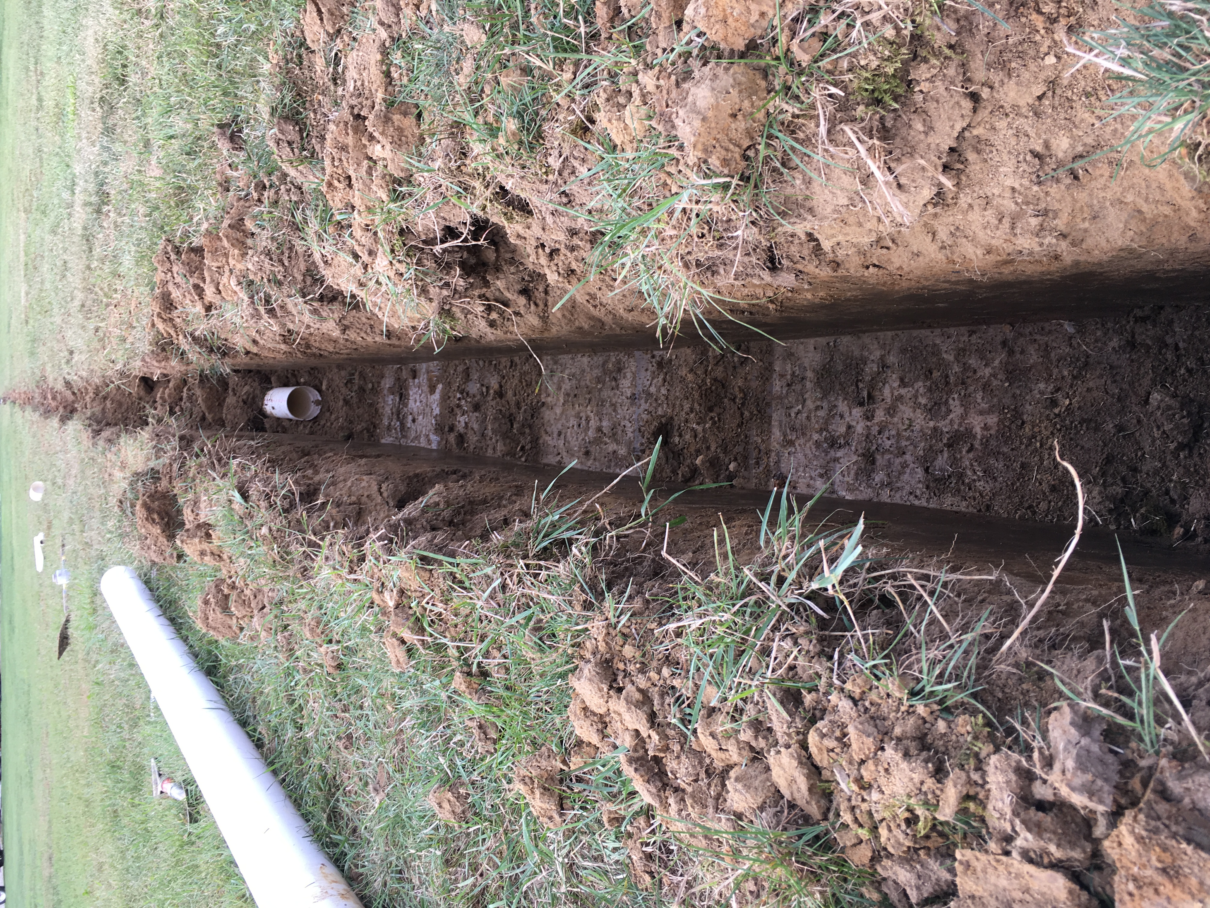

I have done it both ways. Since, I'm working almost exclusively on my own property, and, I'm the one who has to clean up the mess, deal with all the settling, grading, seeding, and watering, I am never going to dig a hole that ends up more than 24" wide, to put in a pipe, or a 4" tile.
My biggest concern is to find a way to do the job with the least amount of impact on my property as possible. If that means waiting for better conditions, or renting equipment, like a trencher, I do it.
Perhaps, I would feel differently if I did not keep my property nice. But, I do.

Digging with a 12” vs 24” really isn’t that much difference in cleanup. And I’ve found that you have less settling with a wide ditch. You can roll the 24” ditch back in pretty good where you can’t a narrow one. But if I cared that much I’d use a ditch witch. There’s really no comparison between the neatness between it and a backhoe.

I'm not talking 12" vs. 24". I'm talking 6" vs. 24" or 27".
Your last line made my point.
I can dig a hole nearly as neat and tidy, as a trencher with my 6" bucket. And, if I need to, without a huge effort, I can hydro in the fill dirt with almost no settling. Then, I'm only planting a narrow strip of grass.
As I said, I've tried both ways.
Years later when you have a drought, and that 30" wide trench shrinks and settles, you have three times the area again, to redo.
I would use a 12", if I had to. But, that's only going to happen, when I have no other choice.

What did you do with the dirt from that ditch? I couldn’t even use a 6” on my M59. A 12” is about the least that would clear the thumb.
