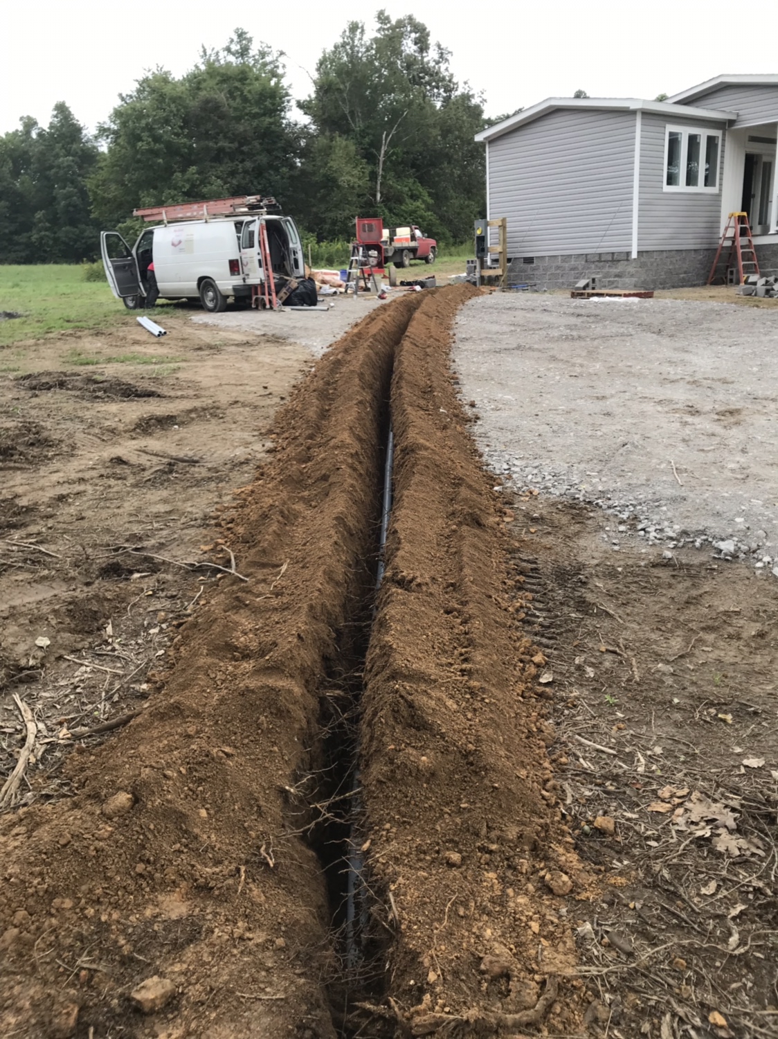

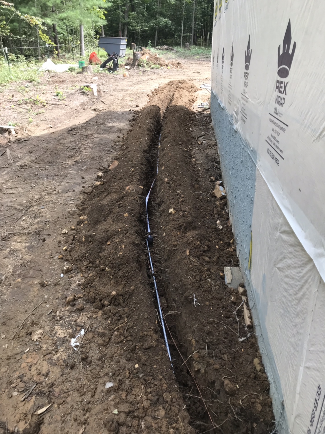

I can definitely understand a homeowner not using a trencher but if ground destruction is important you can’t beat this. I can shove that dirt back in with the blade without much damage to the grass. If you really cared like a lot the powdered dirt isn’t much work to backfill by hand. I’m with digging it that making a million trips moving dirt is harder on the grass than just putting it beside it. IMG_9045.JPGIMG_9043.JPG

I can definitely understand a homeowner not using a trencher but if ground destruction is important you can稚 beat this. I can shove that dirt back in with the blade without much damage to the grass. If you really cared like a lot the powdered dirt isn稚 much work to backfill by hand. I知 with digging it that making a million trips moving dirt is harder on the grass than just putting it beside it. View attachment 669795View attachment 669796
