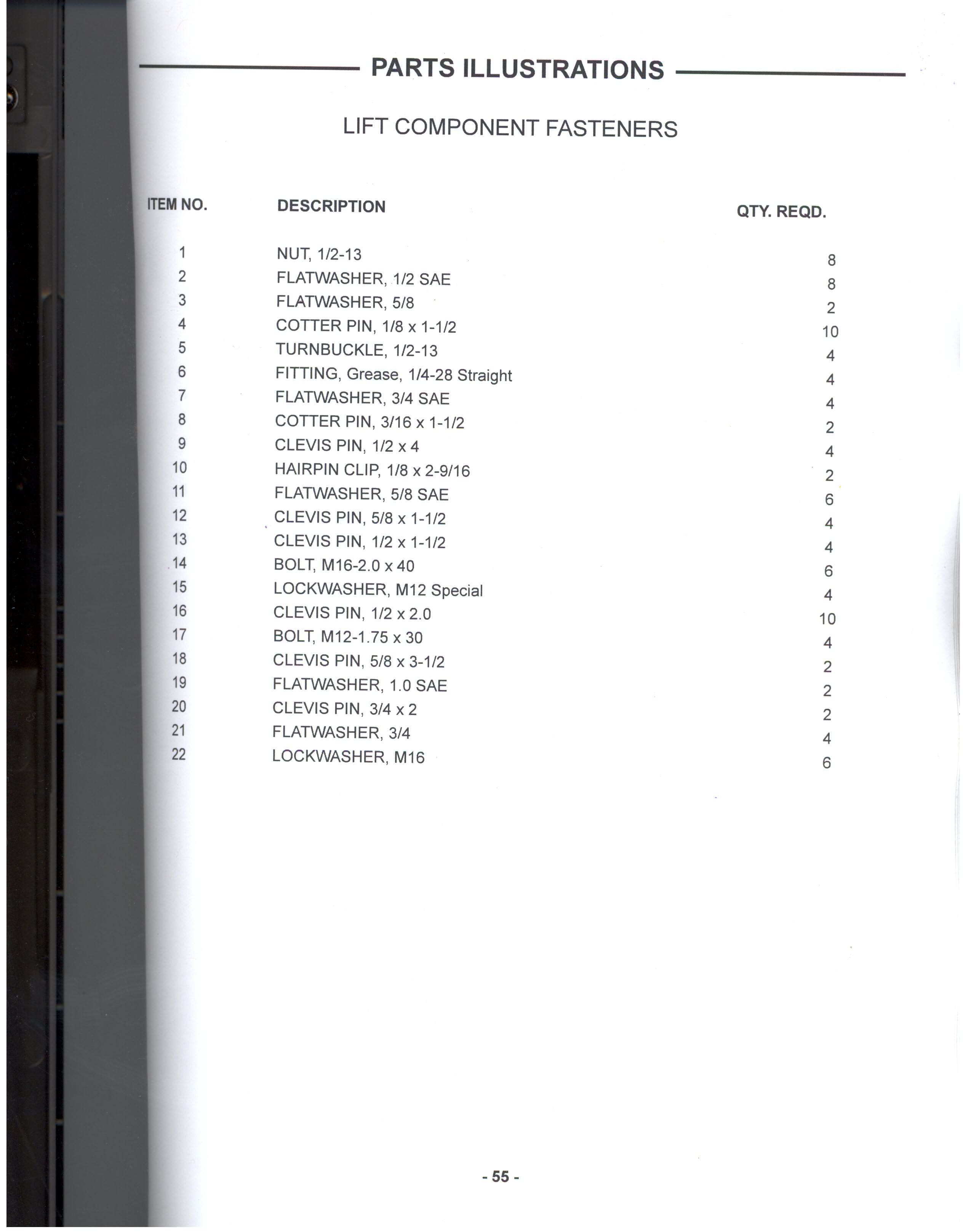

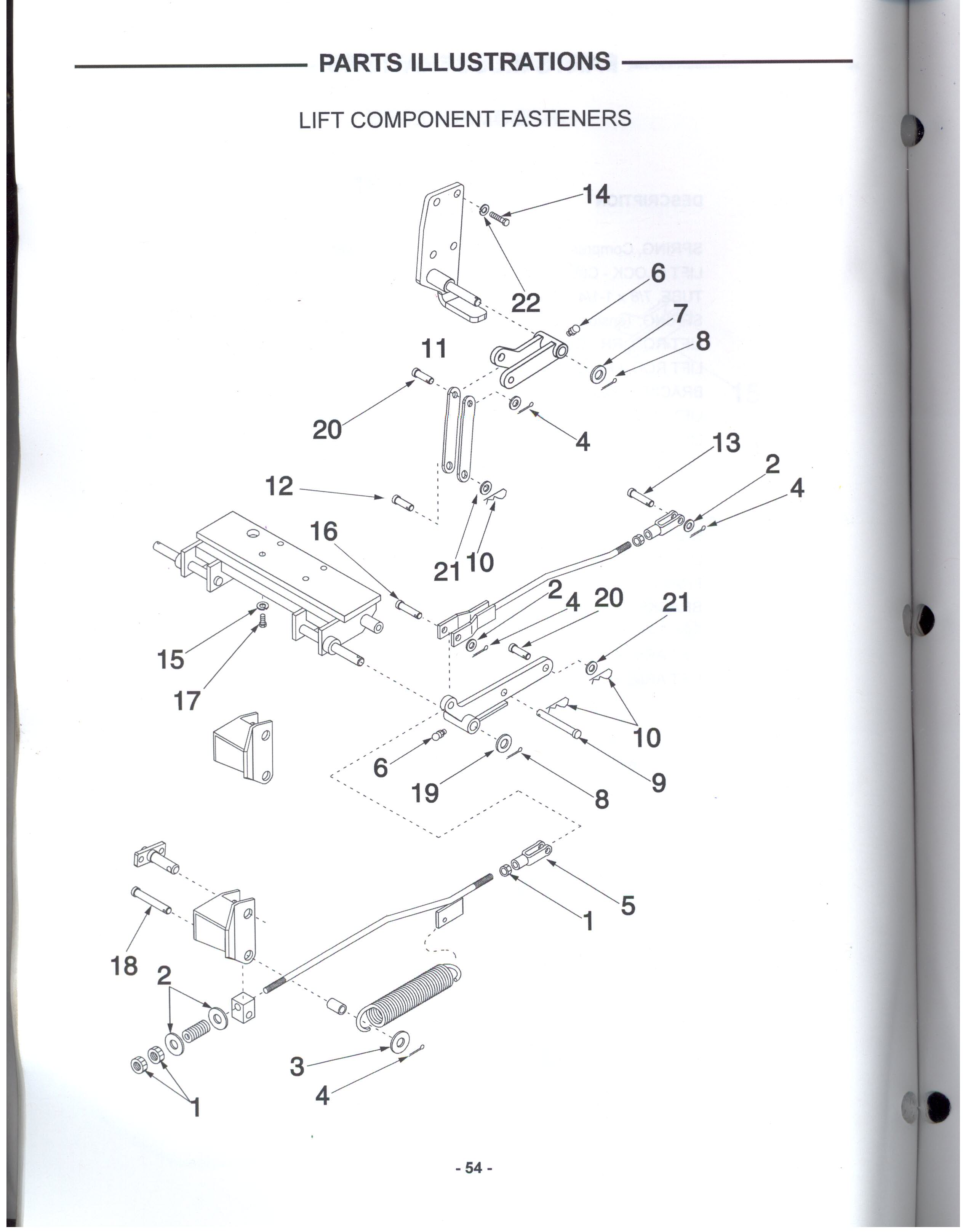

I recently purchased a used New Holland 1620 tractor with a 60" 914 belly mower. The mower wasn't installed and some of the pieces used to install the mower were not in place. I need to know how to hook up the parts so I can install the mower. Does anyone have a picture of the mower or a diagram on how it can be hooked up? I'm sure if I can see the complete belly mower I can figure out how to install it.
   / 914 mower #2
Here are the mounting drawing from my manual. Hope they help

Thank you. This will be of some help. I also need to figure out how to hook up the rods and arms to my tractor. I think I might go to my local New Holland dealer and see if they can help.
