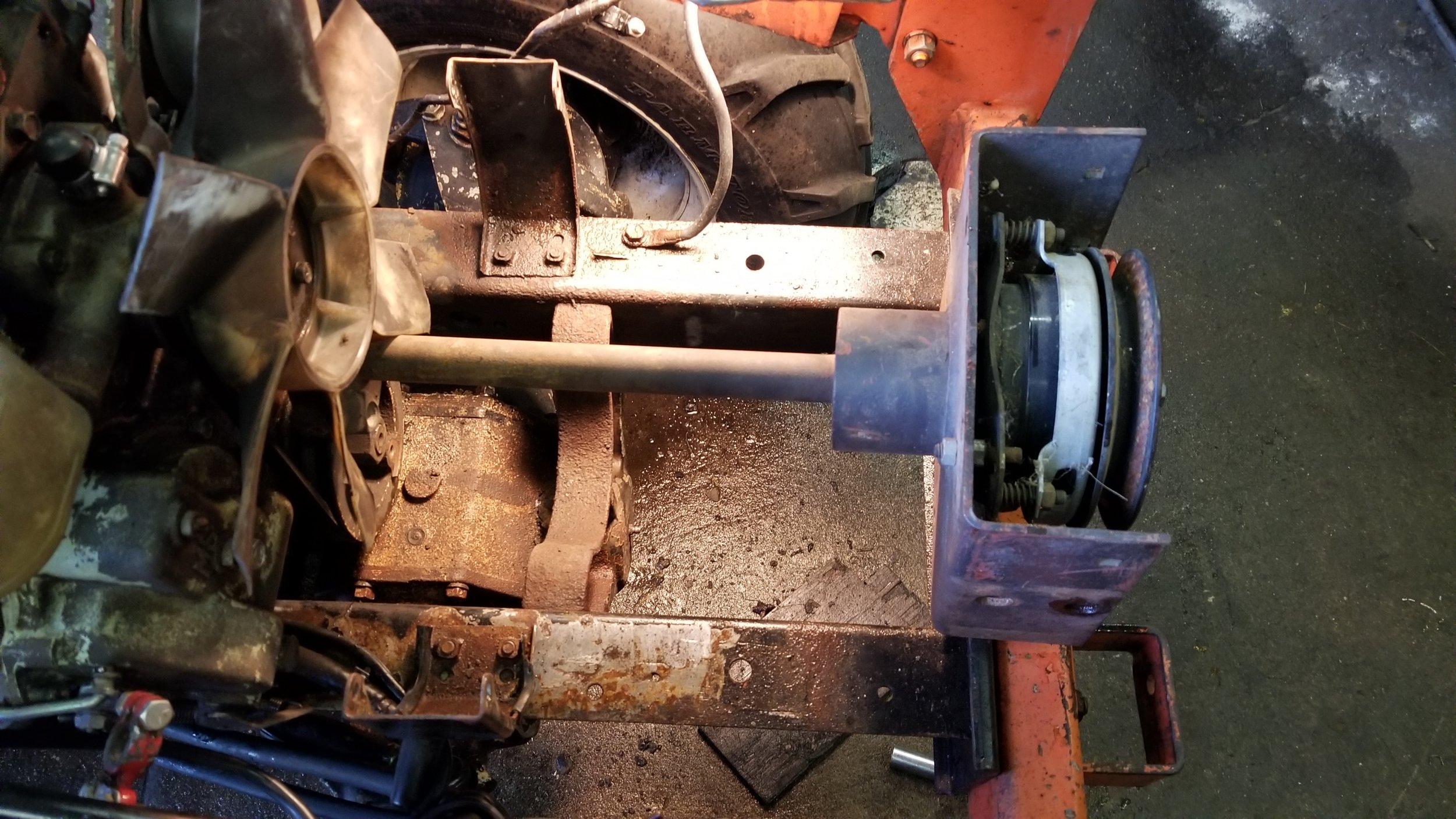

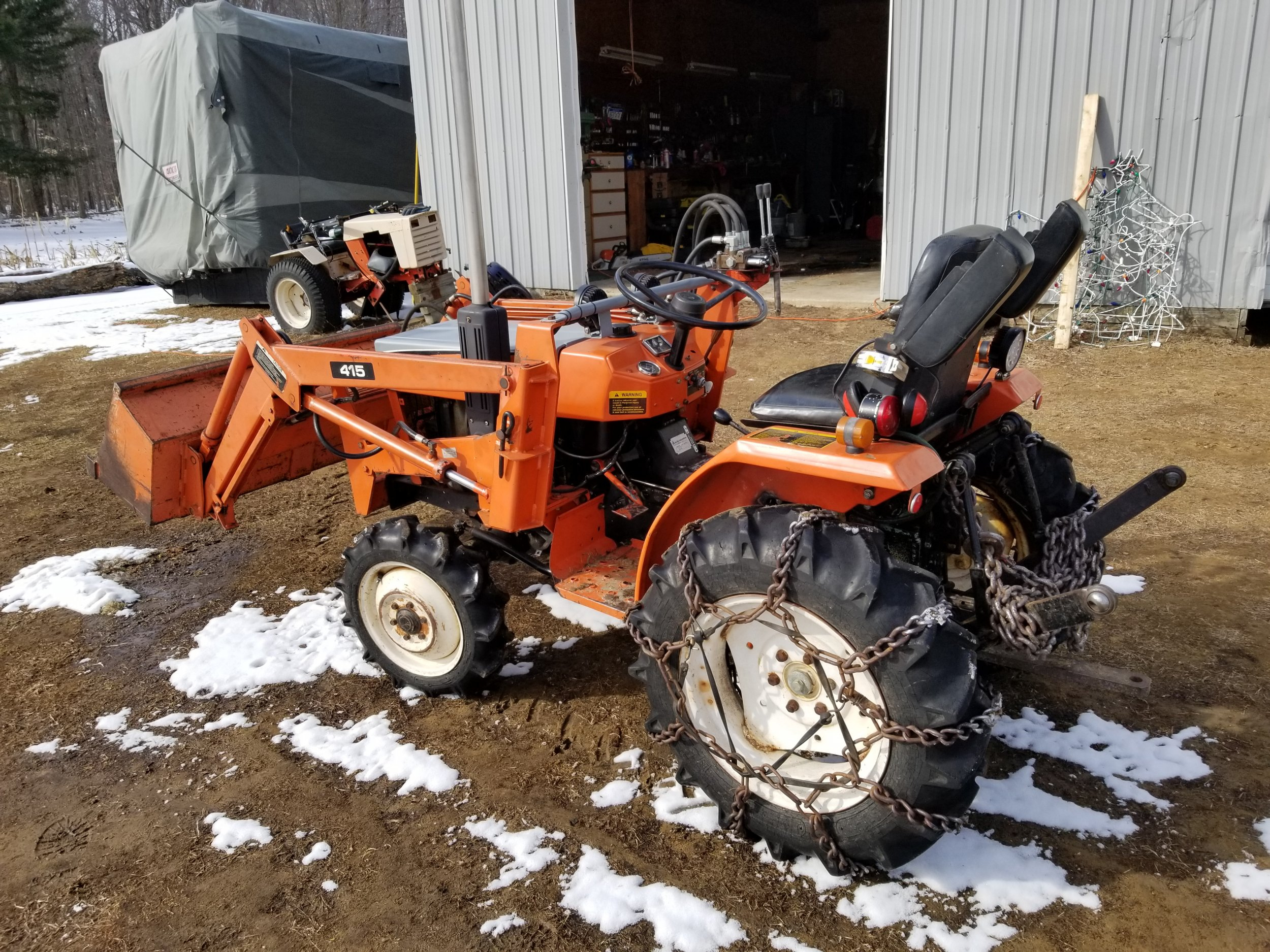

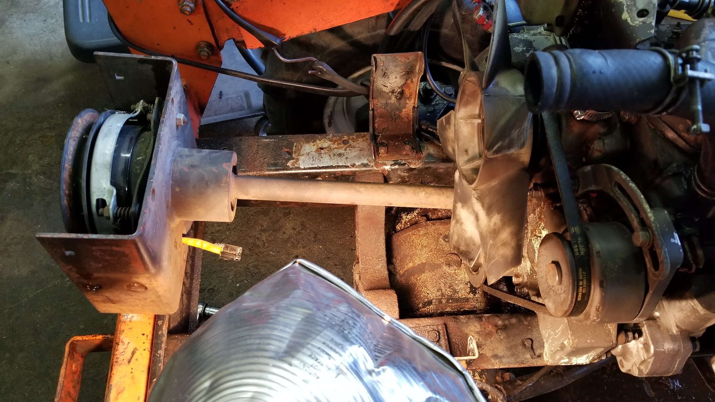

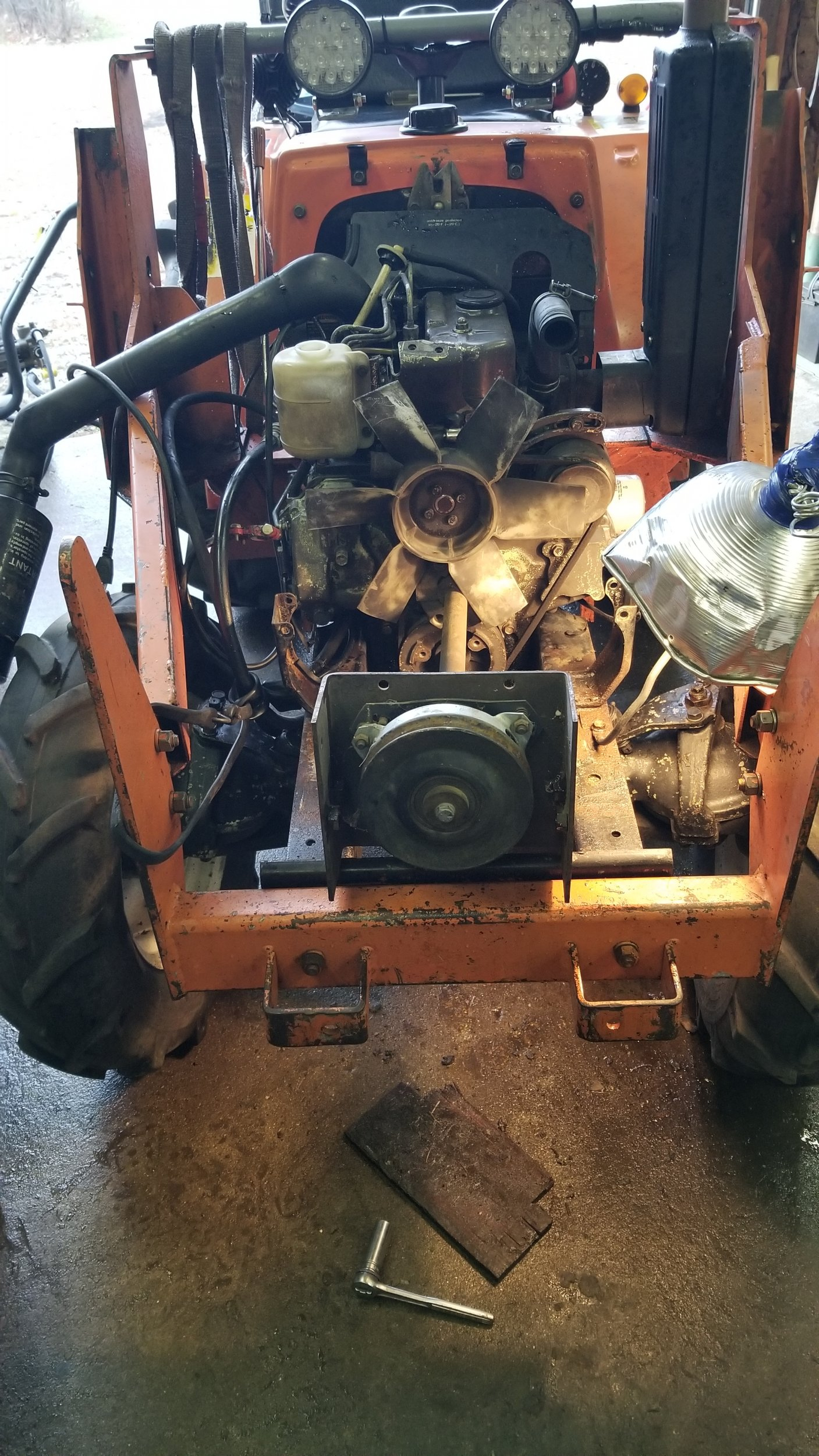

Can anyone help me with this tractor? I'm trying to add the front pto to it and am running into bracket issues. I pulled the pto unit off of a massey ferguson 1010 and am trying to install it on the simplicity 9518. They are basically the same tractor except the massey is only a 2 range while the 9518 is a 3 range tractor. The front pto attaches to the front of the crankshaft and has a bracket that is mounted to the frame further up from the engine. I could use some pics of this setup if anyone out there has a similar tractor. Since the allis 5015, the massey 1010 are the same tractors, any pics of these tractors would work. I'm going to try and put some pics of the problem on this post as well in case someone else has had the same problem. My tractor also has the front end loader on it, so cutting the frame is frowned upon very much. These tractors did come with a front end loader as you can see in the pics, a 48" belly deck, a 52" front end snowblower, and a 52" front blade. I'm assuming that the snowblower would work on the tractor while it still has all the brackets for the loader still attached.
Thank you!
