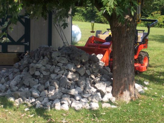

Next came the riprap to control the erosion.........and I dont have to use the trimmer to cut the grass here now. 10 tons, delivered, hauled, and placed, some by hand.
I know now why criminals hated the rock pile for punishment.........this stinks, even with a tractor to help

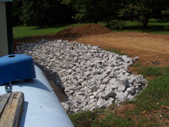

Here is the next step, getting it started on the slope

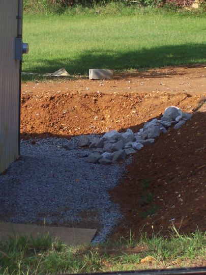

Here we are almost done, and done for the day. Still have to make a straight line at the bottom and put the top diversion/directional barrier in, but that is what other days are for
